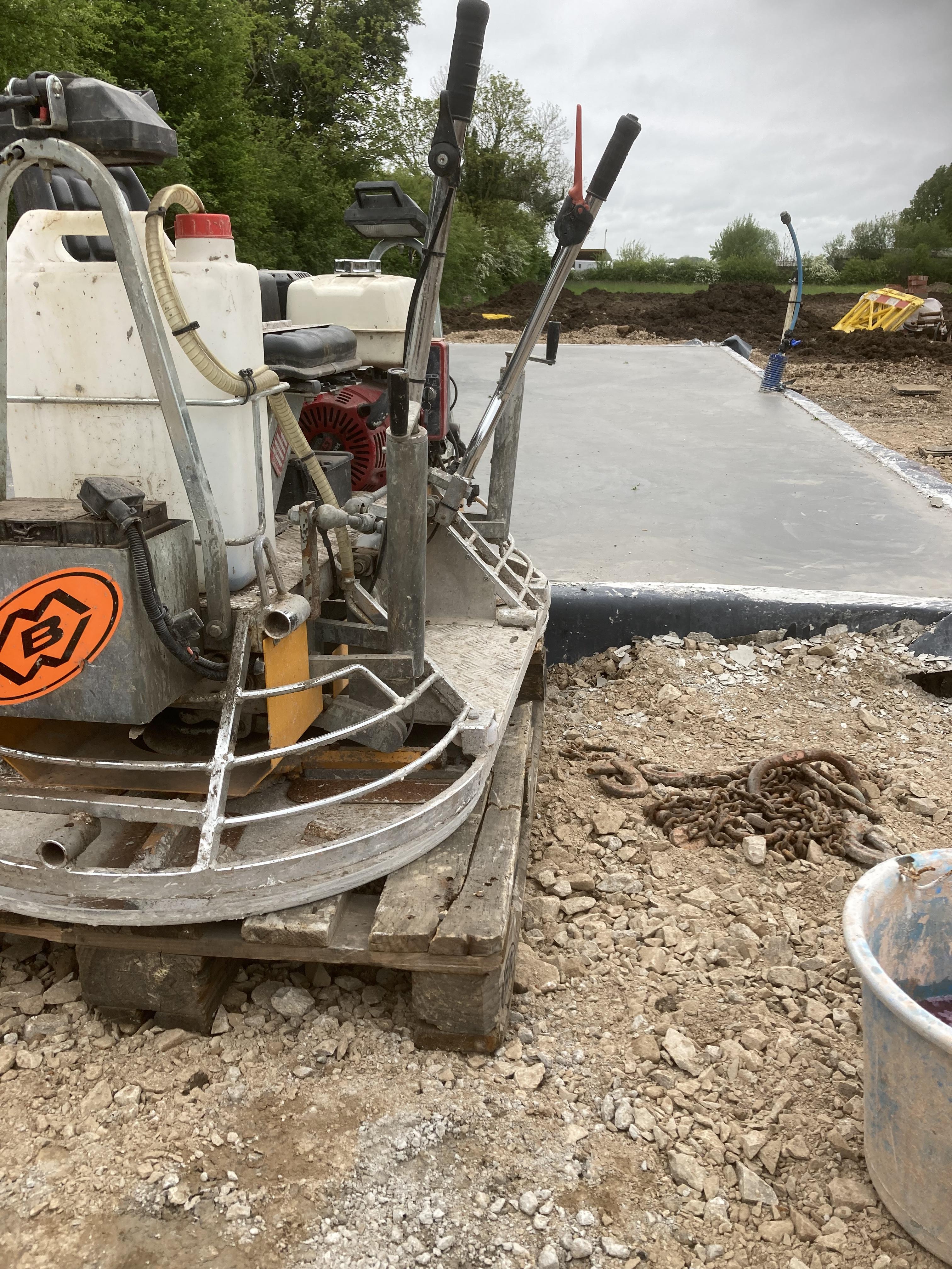

nod Posted May 6, 2022 Posted May 6, 2022 Bit of a cock up yesterday The 8 cube of concrete for the workshop floor on arrived at 4pm Whilst it flattened out nicely It was to late to get any kind of finish Just taken delivery of a ride on float Seems pretty hard I’ll put some pics up later of a beautiful flat floor Or a total mess that needs rr doing 1
bassanclan Posted May 6, 2022 Posted May 6, 2022 One thing I learnt was not to accept afternoon deliveries of concrete. If things don't go to plan you never have time to rectify them!
bassanclan Posted May 6, 2022 Posted May 6, 2022 Looks like it came up pretty well. Did you have some retardant put in the mix?
nod Posted May 6, 2022 Author Posted May 6, 2022 1 hour ago, bassanclan said: Looks like it came up pretty well. Did you have some retardant put in the mix? No it arived at 4pm and my mate dropped the float off at 12 the next day
bassanclan Posted May 6, 2022 Posted May 6, 2022 It looks like a proper bit of kit, ride on powerfloater, probably significantly better "cutting power" than the hand held ones
nod Posted May 6, 2022 Author Posted May 6, 2022 The only drawback with it is you need a digger or forks to get it in and out of the van It was good of my mate to lend it to me
