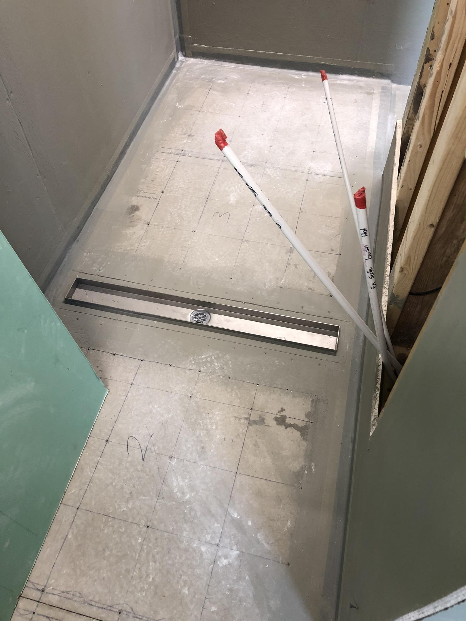

Nickfromwales Posted April 23, 2022 Posted April 23, 2022 18 hours ago, Johnny Jekyll said: May I ask, what would you use to tank? Products / brands? Thanks Link Theyre all much of a muchness tbh, and made from the same stuff. No need to spend mega bucks and I’ve been using these types of products for decades. Impey do a system, as do Roman etc, but that “liquid membrane” from Mapei is plenty good enough and had never let me down. Hand made this bespoke shower ‘tray’ ( 2700mm x 900mm ) falling to a centre drain. All tanked in the above product, walls and floor. 👌.
