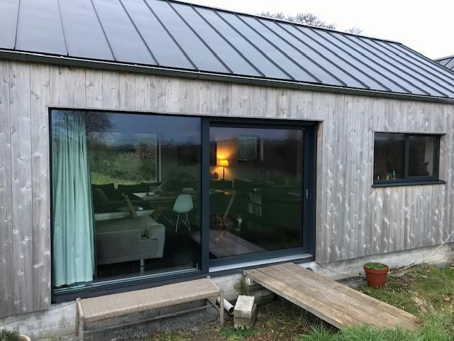

This is Scottish Larch, installed last May, and oiled a week before the photo a couple of weeks ago.
I can only comment on Larch, as that's what we have. Using local timber was one of the main factors in our decision. Weathering seems relatively consistent on a given aspect, but different between the aspects (i.e. SW facing has weathered more).
Some folk make a big deal out of the timber origin, and while it's important, so is the planned cladding orientation and fixing method. We had a few banana boards in the cladding stack that were no use. Larch is slightly prone to cupping, but if you double nail each board and ensure the inner/outer boards have their grain correctly orientated (If you're using board on board) this works to your advantage.

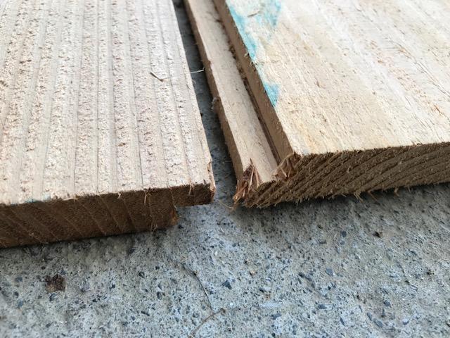

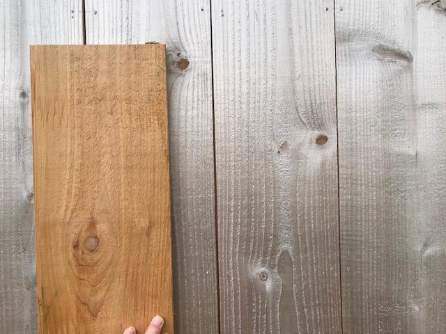

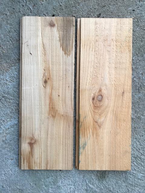

I have used locally (South Devon) sourced Western red cedar, definitely knottier than imported. These boards are 20mm x 195mm. You can see the difference in colour after a year being installed.

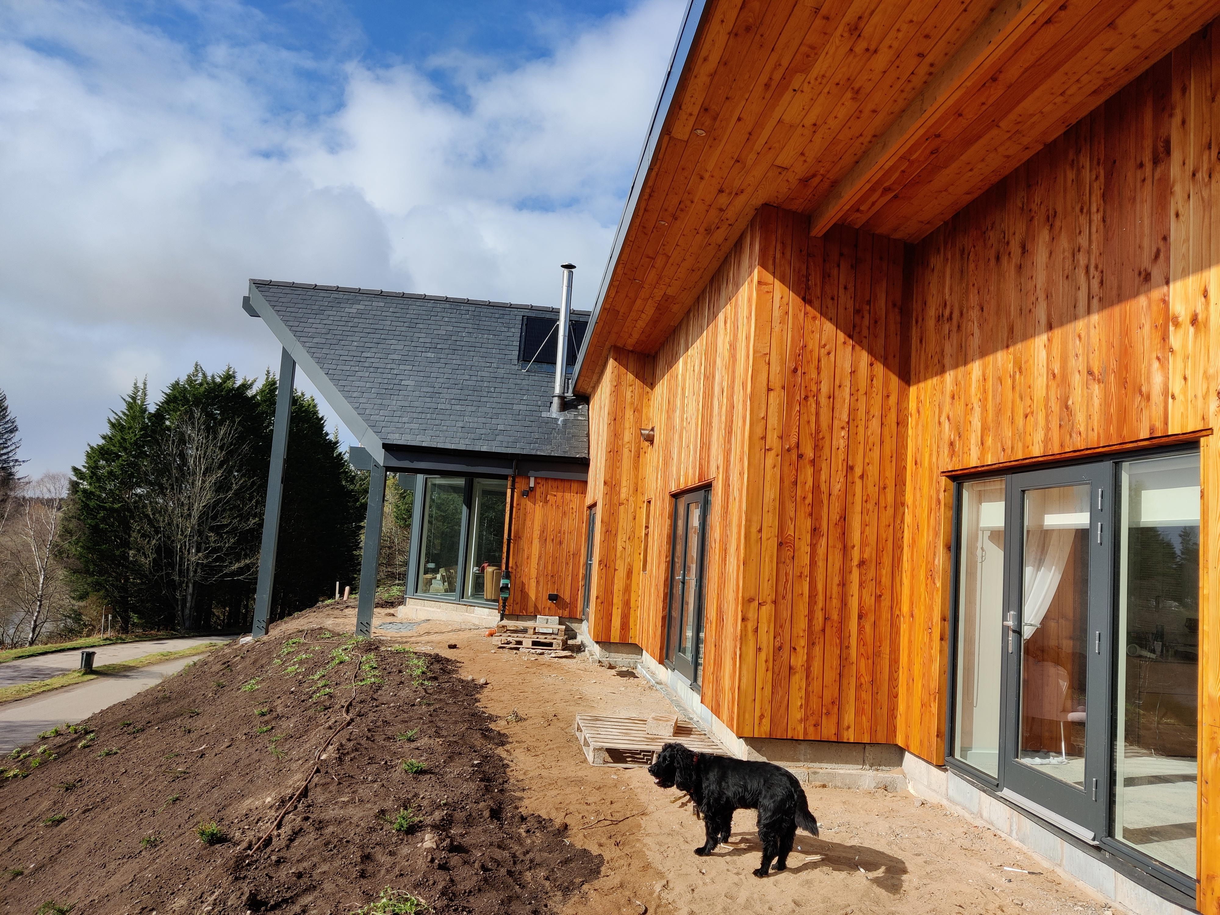

We have used local western red cedar bit of movement a few knots but makes it interesting, milled from trees ourselves, surplus stock if anyone interested
