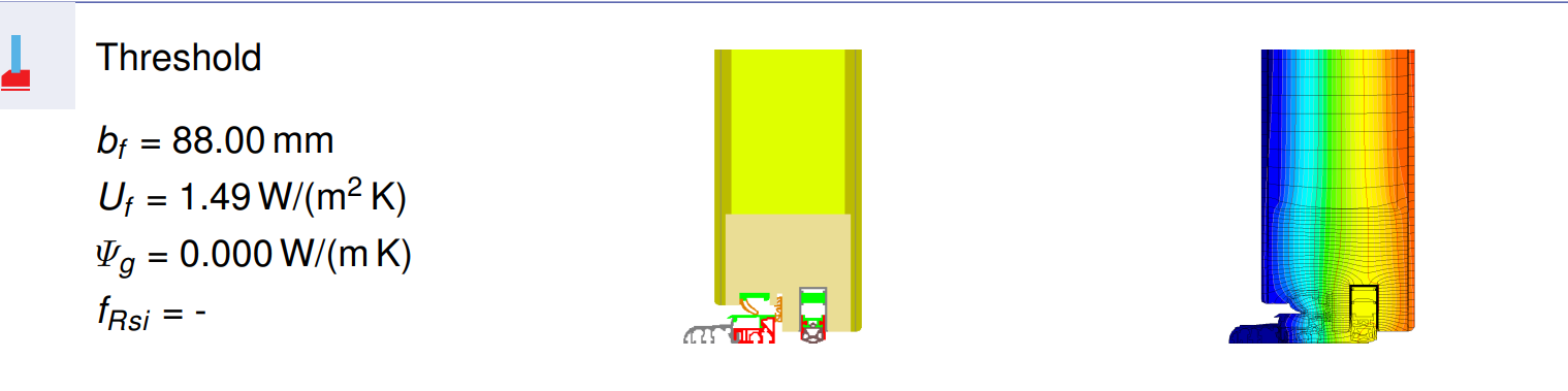

Here is a cross section of a passivhaus door, note the sweep and the compression seals, The red part is a thermally broken threshold I think. The door is almost entirely insulation.
For a quality install this should be sat on some suitable insulant, like compacfoam which in turn is continuous with the floor insulation, The external should drip clear, like in your example into a door drain.
For airtightness I would use something like compriband or FS500.
https://www.illbruck.com/en_GB/solutions/window-installation/brick-block/
As to DPC's. The reality of site work is that they are rarely uncompromised. The need to be installed out of the way of foot traffic which is almost never done. A robust solution is to use DPC paint on the threshold but it is messy and time consuming.
