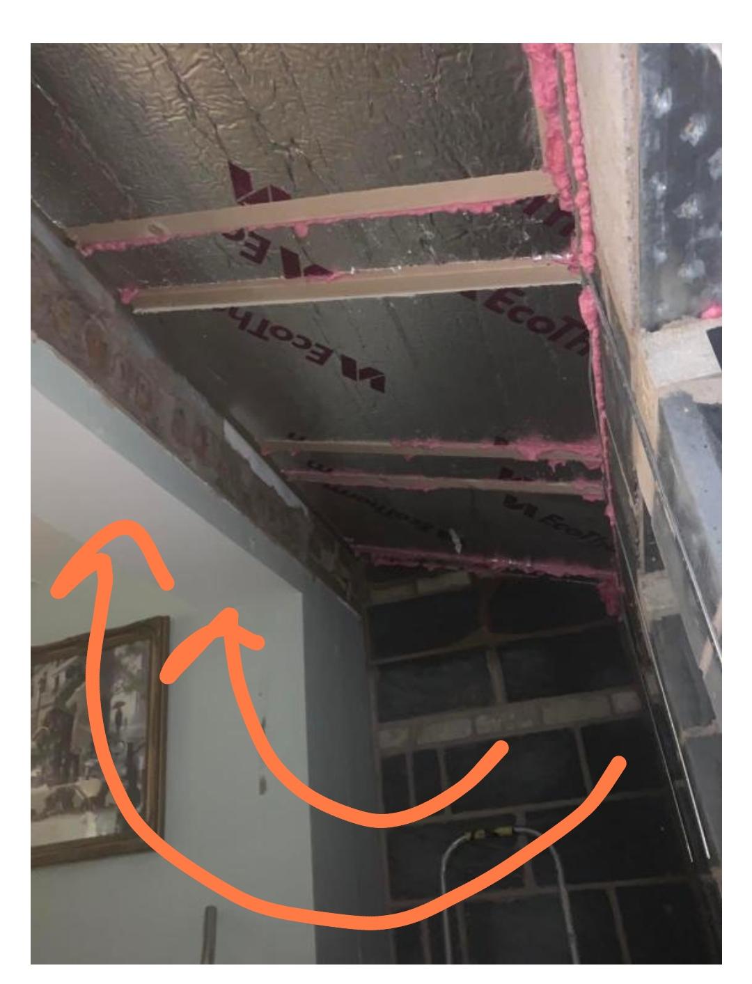

And as you'll see on the images below, the construction beneath the felt is 150mm rafters packed with 125mm of kingspan and a 25mm air gap. Ofcourse the 3 big pieces of kingspan below are temporary and will be coming out in place of the velux windows when they arrive. (note the space between the veluxes will be 230mm or so)

Unfortunately looking at the pics I think it's really neither here nor there. You could triple the insulation in this part of the roof but it would pale into insignificance beside the thermal bridge of the lintel as indicated below. PIR and phenolic insulation typically only perform to their stated U-Value under laboratory conditions. In reality their thermal performance will be much closer to mineral wool than producers would have you believe.
