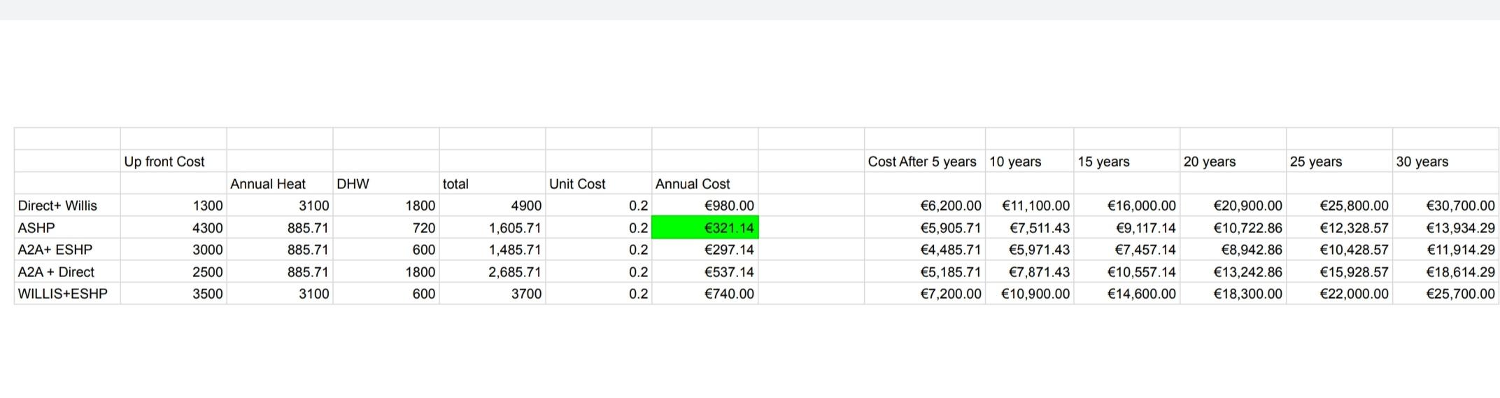

Iceverge Posted February 5, 2022 Share Posted February 5, 2022 If you can buy an ASHP at a reasonable price it's the best option. I looked at a friend's similar project recently, almost exactly the same size for space heating and DHW. U values 0.12 ceiling, 0.18 walls 0.16 floor. 0.6ACH airtightness, MVHR and good airtightness detailing. Annual heat demand about 3000kWh. He is able to get an ASHP for €4000 through work so that's what I based my calcs on. I compared direct electric, an exhaust source heat pump, an A2A heat pump and an immersion and various combinations. The A2A + ESHP was the cheapest overall but could risk some rooms being too cold in a bungalow as it depends on air movement to heat the house. The ASHP was a close second, combined with UFH in a thick concrete slab would allow cheap overnight heating with the slab as a storage heater as well as excellent comfort. Forget renewables until you've got a structure that is as efficient as possible. Insulation has a far longer lifespan than any PV panels or wind turbines. Link to comment Share on other sites More sharing options...
