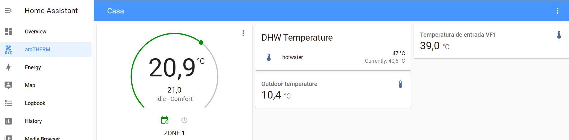

Bruno Posted January 26, 2022 Author Share Posted January 26, 2022 (edited) 4 hours ago, J1mbo said: Degree-minutes is used by the controller to regulate energy supply. It's not related to anything the VRC700 is doing. Thank you Further updates: Today I bumped the day timperature to 23º. It was also a bit warmer outside so the flow temperature really didn't change much. The equipment did not cycle often (only 3 times in 8h), but the power consumption was always very low. Setpoint was at 23º, room temperature at 20,5º maximum. It seems clear that the compensation of room temperature is as I read it from the manual. I might get in touch with Vaillant to clarify this. In other news I temporarily set up home assistant in a virtual machine (I want to later move it to a rpi) and sucessfully integrated multimatic. It's really easy and I have have never worked with HA before. It's as slow as the app and fails as often to fetch values ? Unfortunately since I connected the buffer tank sensor I lost the flow temperature in the app, and it seems that in the integration as well. I need to check if there are further values which the API can fetch. And I would need to be able to change my energy meters from emoncms to HA. That will be a problem... While looking for information on how to do this I came across this video Managing heating in Home Assistant - part1 - YouTube In the first 5 minutes the author describes a heating behavior which is precisely like mine - but on a gas boiler. Outside temperature translated to flow temperature. So I guess I'm not alone in this... Edited January 26, 2022 by Bruno 2 Link to comment Share on other sites More sharing options...

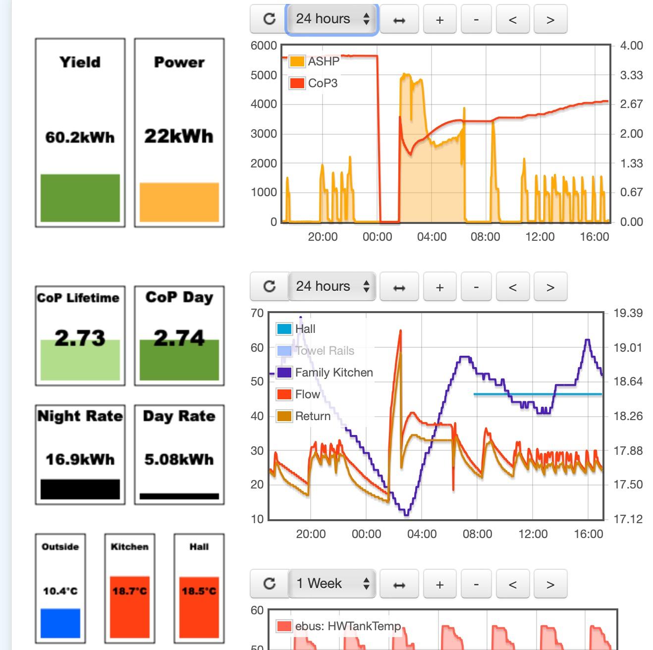

m0deller Posted February 21, 2022 Share Posted February 21, 2022 I have an aerotherm+ 12kW with 3 circuits, HEX and 45l buffer. The VF1 is connected into the top pocket of the buffer. It's using circuit 10. Expanded room temperature. The flow tracks the demanded flows (I'm using ebusd to monitor) 1 Link to comment Share on other sites More sharing options...
Dan F Posted February 21, 2022 Share Posted February 21, 2022 2 hours ago, m0deller said: I have an aerotherm+ 12kW with 3 circuits Do you have all circuits running at same temperature, or do you have them mixed? 2 hours ago, m0deller said: The VF1 is connected into the top pocket of the buffer. It's using circuit 10. Expanded room temperature. I'm using "active" room temperature mod. I'm unclear of pros/cons of "active vs. expanded". Have you seen the issues mentioned regarding VF1? Do you think these impact you? 2 hours ago, m0deller said: The flow tracks the demanded flows (I'm using ebusd to monitor) Very interesting. Can I ask how you are doing this? Raspberry pi with USB ebus adapter? Any specific software to decode proprietary ebus stuff? Link to comment Share on other sites More sharing options...
m0deller Posted February 21, 2022 Share Posted February 21, 2022 1 hour ago, Dan F said: Do you have all circuits running at same temperature, or do you have them mixed? I'm using "active" room temperature mod. I'm unclear of pros/cons of "active vs. expanded". Have you seen the issues mentioned regarding VF1? Do you think these impact you? Very interesting. Can I ask how you are doing this? Raspberry pi with USB ebus adapter? Any specific software to decode proprietary ebus stuff? Yes, all circuits run at same temperature. The UFH is directly couple - no blend valve I've not tried Active , so can't comment vs Expanded I run ebusd on a pi using the ebus adapter (Wemos D1) WiFi , with a circuit I built myself from here (whilst I wait for ebus Adapter 3) . This is linked to emoncms which is where I do the graphing and trending. Using emon I can measure the power consumption from the ASHP and fuse this with the environmental yield from ebus to generate a rolling CoP. Because I run the ASHP harder overnight (when it's typically colder) , my CoP suffers .. but I'm paying 5.5p/kWh (for the time being ? ) 1 Link to comment Share on other sites More sharing options...
J1mbo Posted February 21, 2022 Share Posted February 21, 2022 The COP is (Yield+Consumption)/Consumption roughly - more like 3.7 3 Link to comment Share on other sites More sharing options...
m0deller Posted February 21, 2022 Share Posted February 21, 2022 J1mbo .. interesting and thanks. I did wonder why the working figure was higher .. never occurred to me that the yield didn't include the power used. Every day a learning day! 1 Link to comment Share on other sites More sharing options...
