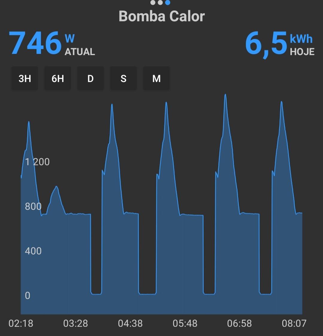

Bruno Posted January 21, 2022 Author Posted January 21, 2022 Well, not so happy today This night was warmer than yesterday, by ~5 degrees. I didn't change anything in the configuration, but -the HP was working intermittent all the time (picture attached) - the room lost ~0,6°, unlike yesterday What can cause this? - curve is at 0,9, temperature modulation - circulating pump is at speed 2 (out of 3) - rads are balanced (correctly, I think ?) Thanks
J1mbo Posted January 21, 2022 Posted January 21, 2022 It looks ok to me - there's literally one cycle per hour. 10 minutes is often cited as the 'rule of thumb' minimum. Likely the total radiator output at the set point was less than the minimum heat pump output, meaning the set point was exceeded and eventually (at 0° minutes) the system shut down. That the temperature was not maintained suggests that the curve is too low.
Bruno Posted January 21, 2022 Author Posted January 21, 2022 On 21/01/2022 at 12:05, J1mbo said: That the temperature was not maintained suggests that the curve is too low. Expand It's strange how with a lower outside temperature it worked so fine... I still don't really understand how the curve has so much importance over the setpoint temperature. If it's below the setpoint for so long, shouldn't it bump the setpoint until it reaches it? I did notice that the temperature at the buffer tank was around 40° which fits the curve setpoint. What should I do to increase the radiator output? Different balancing? Higher pump speed?
J1mbo Posted January 21, 2022 Posted January 21, 2022 Maybe bump the curve to 1.0. Yes it will increase the flow temp as the deviation gets further away, but 0.6° is not very much. Increasing the radiator circuit pump speed will reduce the dT across them. If it's somewhere near 5° as it is then it's probably about right. 1

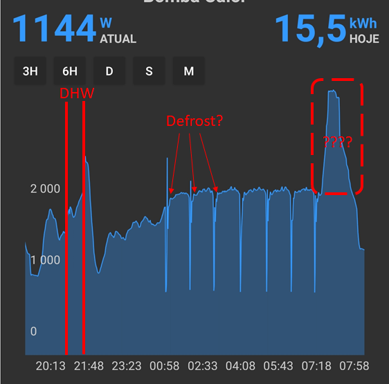

Bruno Posted January 25, 2022 Author Posted January 25, 2022 (edited) The last few nights were very cold again (1º at 8h00), still very dry and sunny days. This was this evening's consumption graph, much similar to previous nights. Something I noticed is that after defrost kicks in (if that's really defrost, I have no way to confirm it) the consumption stays high at ~~2kW and never decreases again. Before the first defrost cycle consumption was much lower. I have absolutely no idea what is that peak at the end (did not happen in previous nights). I only noticed this because it becomes a bit noisy when working at full power, so I went to check the energy meter. I did check the unit's reported energy output and it was at ~~24kWh for today (so after 00h00), which means a ~~1,5 COP. I guess that's what it takes when it's just above freezing outside ? Edited January 25, 2022 by Bruno
J1mbo Posted January 25, 2022 Posted January 25, 2022 Vaillant reports the energy consumed (E) and the environmental yield (Y). The COP is (approximately) (E+Y)/E.
Bruno Posted January 25, 2022 Author Posted January 25, 2022 Oh, I had no idea. Thanks My meter says 21,1kWh up to now, vaillant says 20kWh. Environmental yeld is 33kWh. So COP is 2,57 I'm still totally confused with be heating behaviour, can't get my head around this... Last night was cold, so flow temperature was high according to the curve. Higher consumption but the room temperature was kept. Now it's sunny, 13° outside. I already fixed the temperature sensor's position so it reads fine now. I bump the setpoint temperature to 22° on the "day" program, room temperature is only 20,5°. But the heat pump is stopping, because as it gets warmer outside, it reduces the flow temperature. This makes really no sense to me... I'm planning on installing solar panels also as a way to reduce the cost of heating during the day, but it seems a waste as the heat pump is only effectively heating the house at night...
Dan F Posted January 25, 2022 Posted January 25, 2022 On 25/01/2022 at 13:48, Bruno said: My meter says 21,1kWh up to now, vaillant says 20kWh. Environmental yeld is 33kWh. Expand That's COP of 1.56.
J1mbo Posted January 25, 2022 Posted January 25, 2022 On 25/01/2022 at 14:06, Dan F said: That's COP of 1.56. Expand (20+33)/20 = 2.65. The energy used by the compressor is mostly stored in the gas.

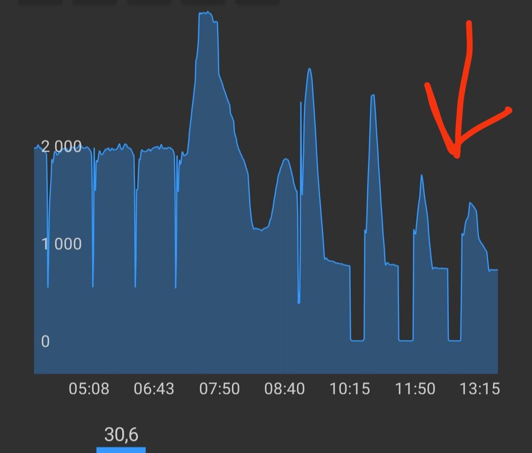

Bruno Posted January 25, 2022 Author Posted January 25, 2022 (edited) On 25/01/2022 at 13:48, Bruno said: Now it's sunny, 13° outside. I already fixed the temperature sensor's position so it reads fine now. I bump the setpoint temperature to 22° on the "day" program, room temperature is only 20,5°. But the heat pump is stopping, because as it gets warmer outside, it reduces the flow temperature. This makes really no sense to me... I'm planning on installing solar panels also as a way to reduce the cost of heating during the day, but it seems a waste as the heat pump is only effectively heating the house at night... Expand COP calculations aside? any thoughts about this? edit: just looked at it again, 14,5º outside (so warmer), 20,3º inside. The room is still loosing temperature. Edited January 25, 2022 by Bruno
J1mbo Posted January 25, 2022 Posted January 25, 2022 so the flow temp is coming down too quick it seems. Are the temperature readings from the outdoor and indoor (vrc700) accurate? An offset can be applied to both individually in the VRC700.
Bruno Posted January 25, 2022 Author Posted January 25, 2022 The VRC700 only shows the temperature in 0,5º steps but I have a digital thermometer (xiaomi) next to and the readings are within that 0,5. For the outside temperature it's not that easy to check. Before when it was getting direct sunlight, it was measuring totally exaggerated values during the day, but now it isn't anymore. So I would say that it is now accurate. But anyway I'm reading both temperatures in VRC700's display so that's also what the equipment "sees". What I see from the buffer tank (in Multimatic) is that it's temperature is more or less OK with the curve: outside temperature 14,5, curve 0,9, setpoint 22º --> temperature in the buffer tank 36,5º (not sure what's the real flow temperature but I'd say it should be more or less that). However the room temperature is 1,7º below setpoint (and still dropping) and the heat pump seems to not care. Tomorrow I will boost the "day temperature" to 23º and check if a bigger difference makes the HP "notice it".

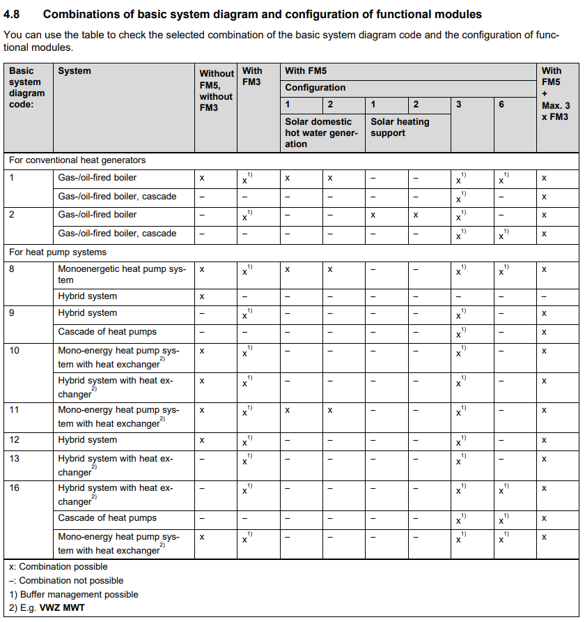

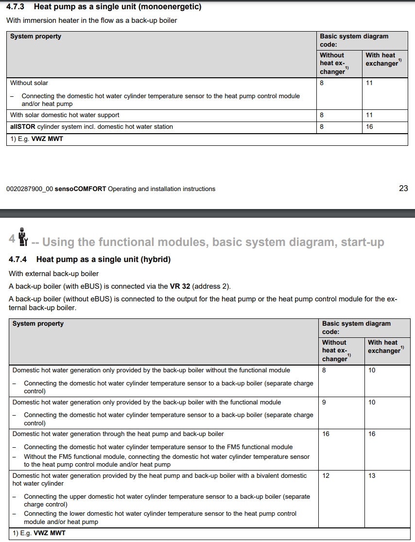

Dan F Posted January 25, 2022 Posted January 25, 2022 (edited) @Bruno Could the "system diagram" values in the schematics be wrong? The manual I have clearly says that "8" is ASHP system without a heat-exchanger and "10" is for a ASHP with a heat-exchanger (HEX). It also says that buffer management is available with both "8" and "10" but that it depends on you using a FM3 or FM5 functional module. From your first post it looks like you don't have a HEX, correct? My setup (hyrdaulic station + 25L buffer with no HEX or glycol even) has been setup with, and is running perfectly, using "system diagram 8". Edited January 25, 2022 by Dan F

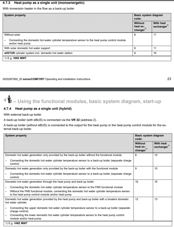

Bruno Posted January 25, 2022 Author Posted January 25, 2022 On 25/01/2022 at 16:46, Dan F said: Could the "system diagram" values in the schematics be wrong? The manual I have clearly says that "8" is ASHP system without a heat-exchanger and "10" is for a ASHP with a heat-exchanger (HEX) Expand I've been using the manual I linked in the first post as the first page says "for aroTHERM plus" and mine is just that ? I will see if I kept the printed manuals which came with the equipment later today. This is my setup and the configuration in page 5 says that "basic system diagram" is 10. I do, however, have a 100l buffer tank instead of a smaller (40l) as the manual says...
Bruno Posted January 25, 2022 Author Posted January 25, 2022 (edited) I don't have that manual as mine is the VRC700, not the 720. But that makes me even more confused, so it's the VRC which defines the schematic and not the heat pump itself? ? Because the manual that I followed suggests parameters for both the 700 and 720. I can set it back to 8 for testing, not a problem. All of this started because I thought that 8 was wrong ? Edited January 25, 2022 by Bruno
