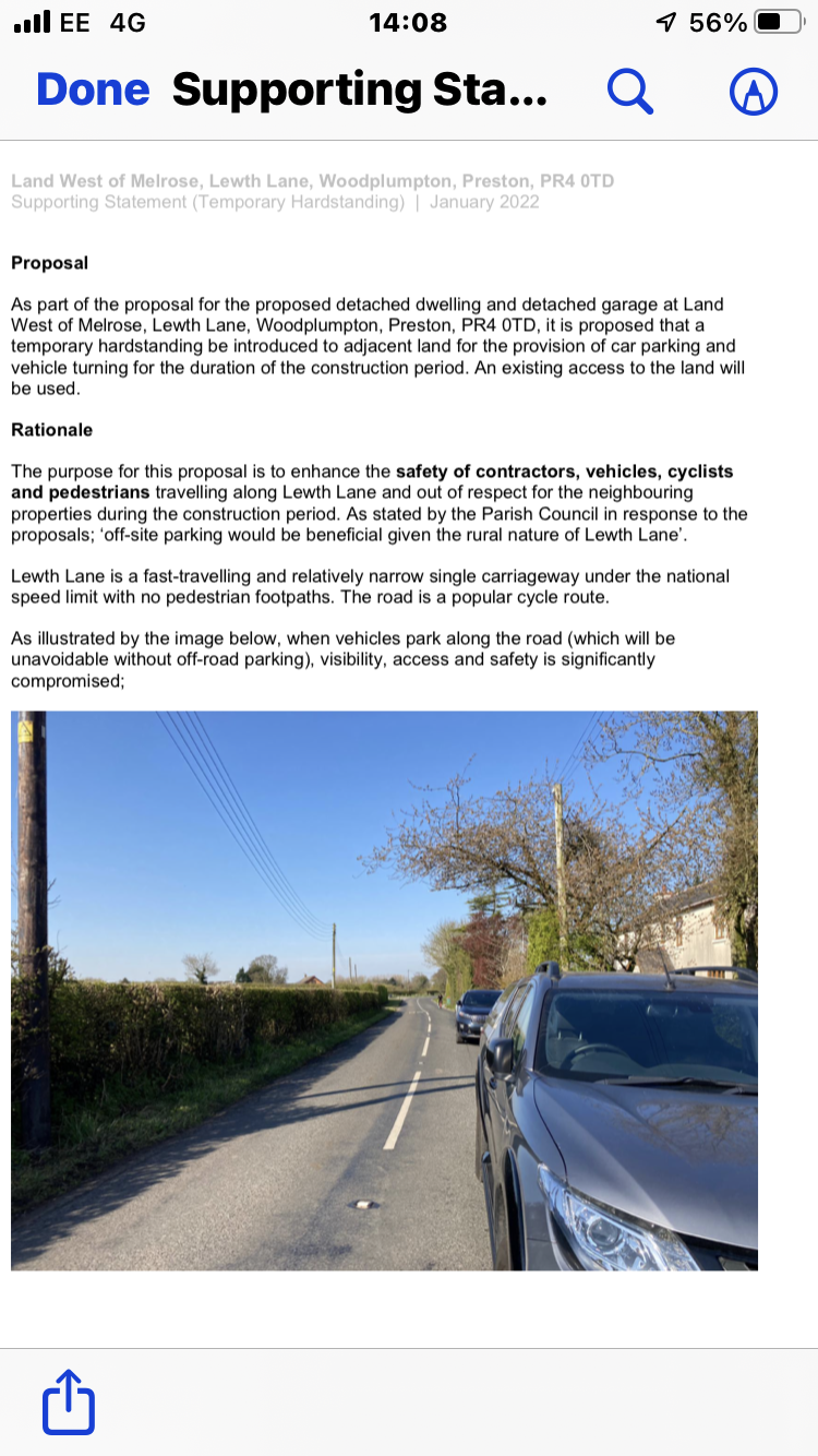

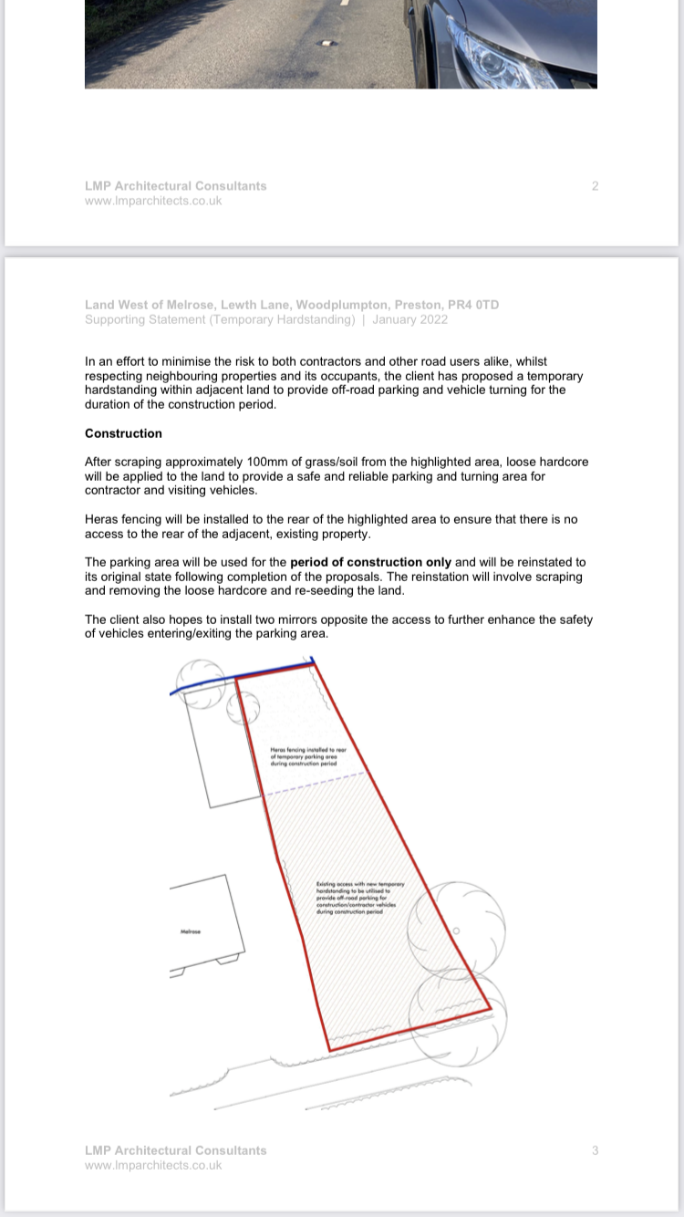

The latest thing is we had planed to keep vehicles off the quiet but 60 mph country road  As we have a gated access further up the field that would be perfect Planners don’t seem to agree
See pictures There doesn’t seem to be any reasoning behind there decision

Planners will never agree to anything that needs mirrors to make it safe. If it is genuinely safe declare the visibilty splay/distances. (Doesn't mean you can't put mirrors up too, but just don't mention it!) If its not safe without the mirrors then a rethink is needed.

We will need mirrors on the plots entrance
