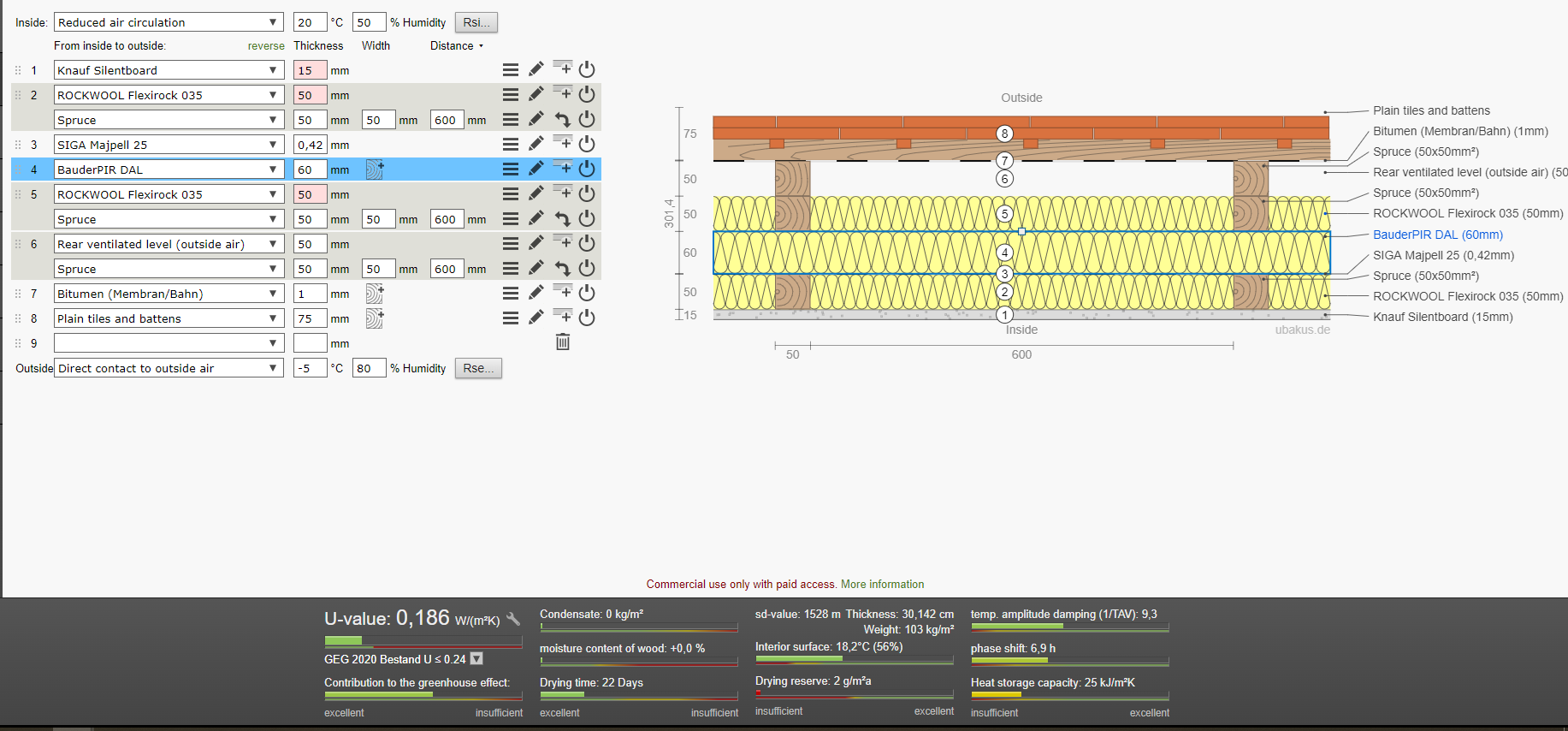

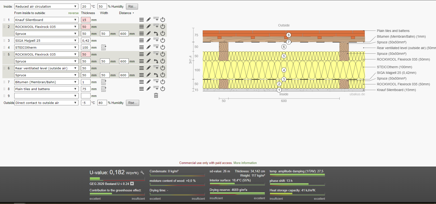

Iceverge Posted January 9, 2022 Posted January 9, 2022 Sorry for the delay. Personally I would do the below. Note the service cavity allows for an unbroken airtightness barrier. Maybe put the woodfiber in 2 staggered layers to really do an ace job. If you're stuck for space or cash use PIR instead of the woodfiber. Remember U value is only one piece of a complicated picture and woodfiber would be my choice. For the eves space if you're really in the mood for some hardship you continue the method right to the wall plate. Otherwise just put 100mm Rockwool or similar batts between the uprights, 100mm woodfiber over. VCL and then 50mm insulated service cavity with 15mm soundblock plasterboard to finish.
Iceverge Posted January 9, 2022 Posted January 9, 2022 I forgot to say you'd need to lay some insulation on the horizontal portion of the eve space behind the dwarf walls. Rolled out mineral wool or blown cellulose would be fine. If you do plan on redoing the roof anytime in the near future I would just put 50mm mineral wool between the rafters, vcl and then a 50mm mineral wool insulated service cavity. The when the roof was redone top up the mineral wool insulation between the rafters to 100mm , put 100mm woodfiber over the top, membrane, batten counterbatten and tiles.
