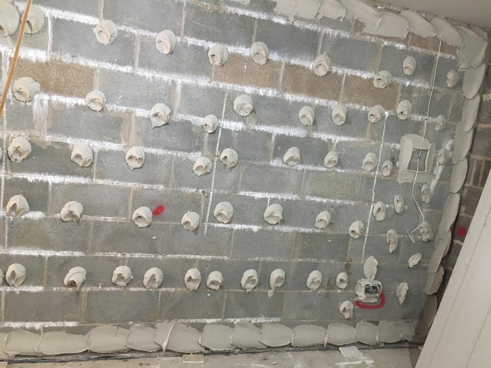

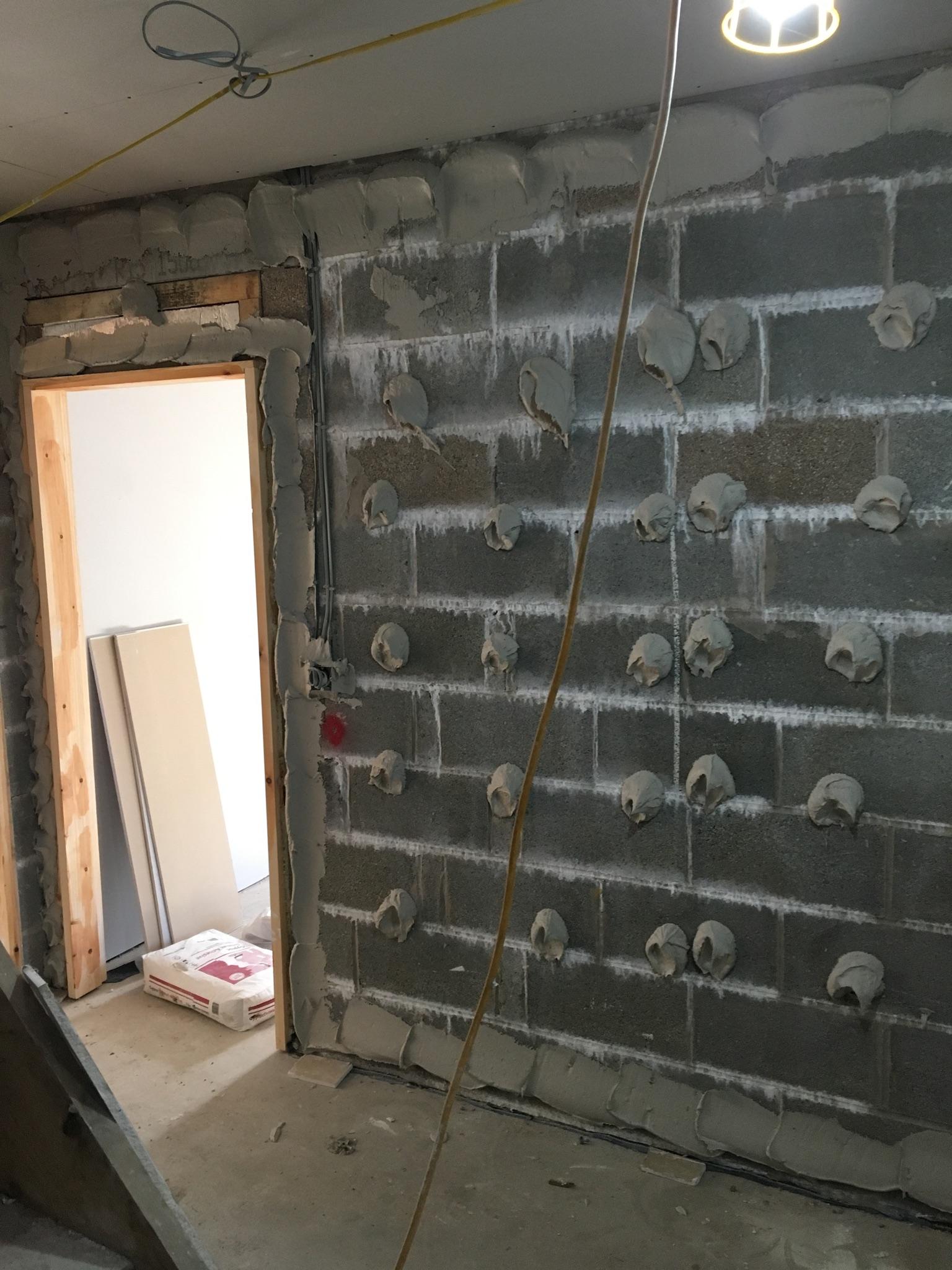

nod Posted January 4, 2022 Share Posted January 4, 2022 Your not to far off with downstairs I would give all the original masonry a coat of 3-1 S&C Then dab your 37 mil insulated boards Pink foam only You can achieve excellent airtightness with dot and dab if done as pictured Thermal blocks are not really suited to wet plaster Unless you use HSB backing You will have to order that in As a Tiling business I use lots of Marmox But you can’t plaster it So I definitely wouldn’t use it on ceilings Your slopes are better with PIR insulation Leaving an air gap Then insulated plasterboard on the rafters 1 Link to comment Share on other sites More sharing options...
SuperPav Posted January 12, 2022 Author Share Posted January 12, 2022 Thanks @nod When you say dab the insulated PB with pink foam only - do you mean adhesive foam (Soudal or similar) as opposed to the pictured d'n'd adhesive? Do the thermal blocks need any prep for d'n'd? In the past we've used the blue gritty prep coat before plastering on poor/old surfaces and that stuff was pretty impressive. Also, I'm interested in the comment about marmox board - they specifically state that it can be plastered, and we've done that in the past on window reveals to continue insulation into the existing openings (with 12mm Marmox) and it took a skim absolutely fine. I've never used it in larger sections, and wouldn't use it on walls as I have a (perhaps unfounded) concern that the impact resistance would be quite poor. For a sloped ceiling that would never get touched by anything, I would've thought it'd be perfect? Link to comment Share on other sites More sharing options...
nod Posted January 12, 2022 Share Posted January 12, 2022 No sorry I mean the foam on the back of the boards needs to be pink Tge others beads mechanical fixing No block work prep needed Link to comment Share on other sites More sharing options...
