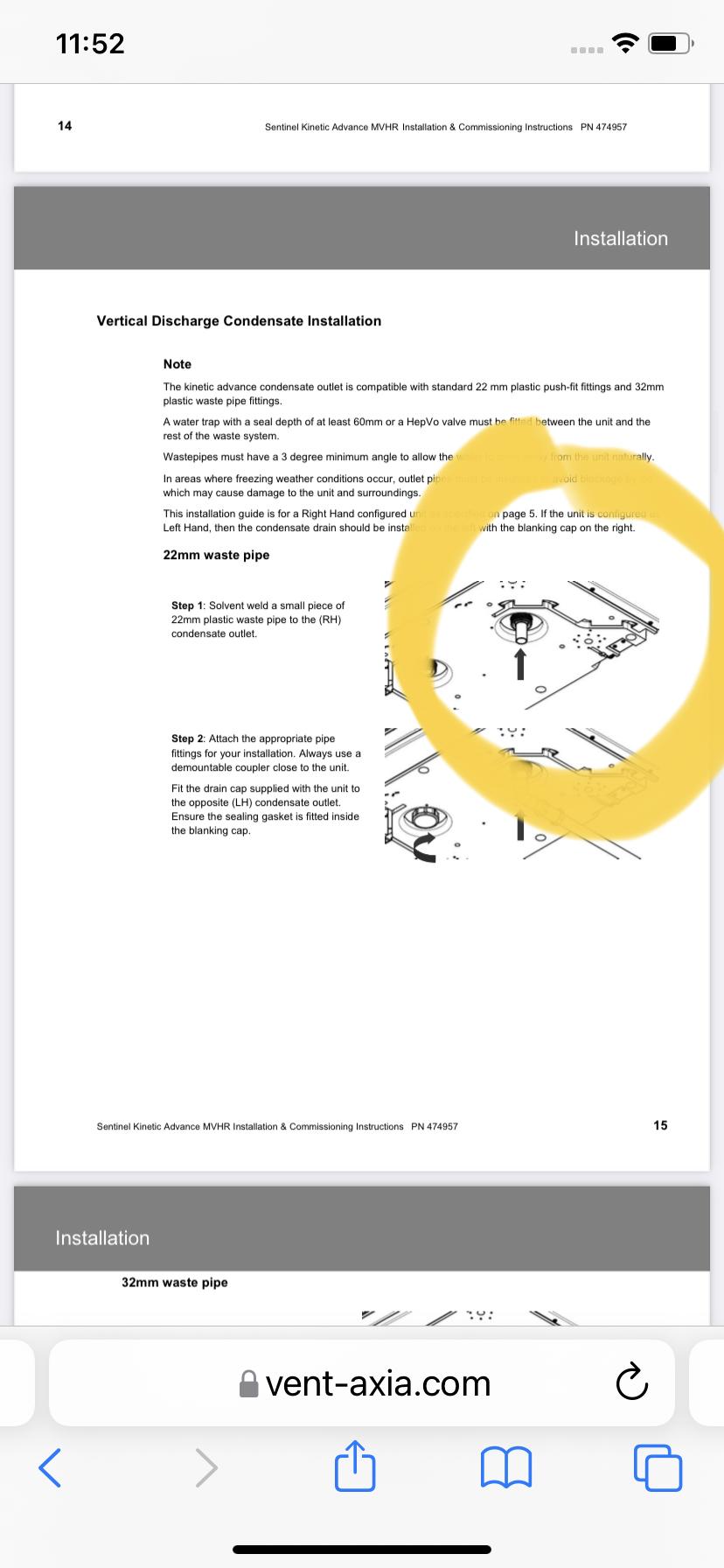

just pottering on with the MVHR all Plummer in apart from the boost switches, it’s a vent axia s, anyone out there with previous experience with this?

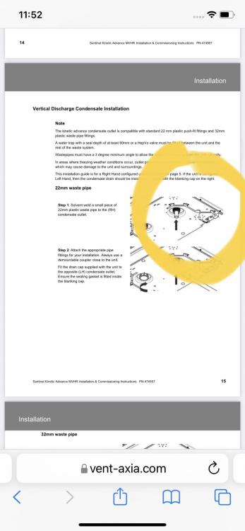

everything seems to be Running ok I think! The drain outlet see picture attached seems to be sucking air is that correct?
thanks for any responses ??
Yes, there will be a vacuum due to the fans being positioned such that they suck air through the unit rather than blow it. It won't be an issue once the drain is connected to a trap.
Perfect quick answer thanks tons ???
The install instructions are pants so takes ages to work through and not comprehensive enough. I was told Diy install!!! , I presume 22 mm waste pipe just inserts into the hole followed with demountable connection for the existing pipe work

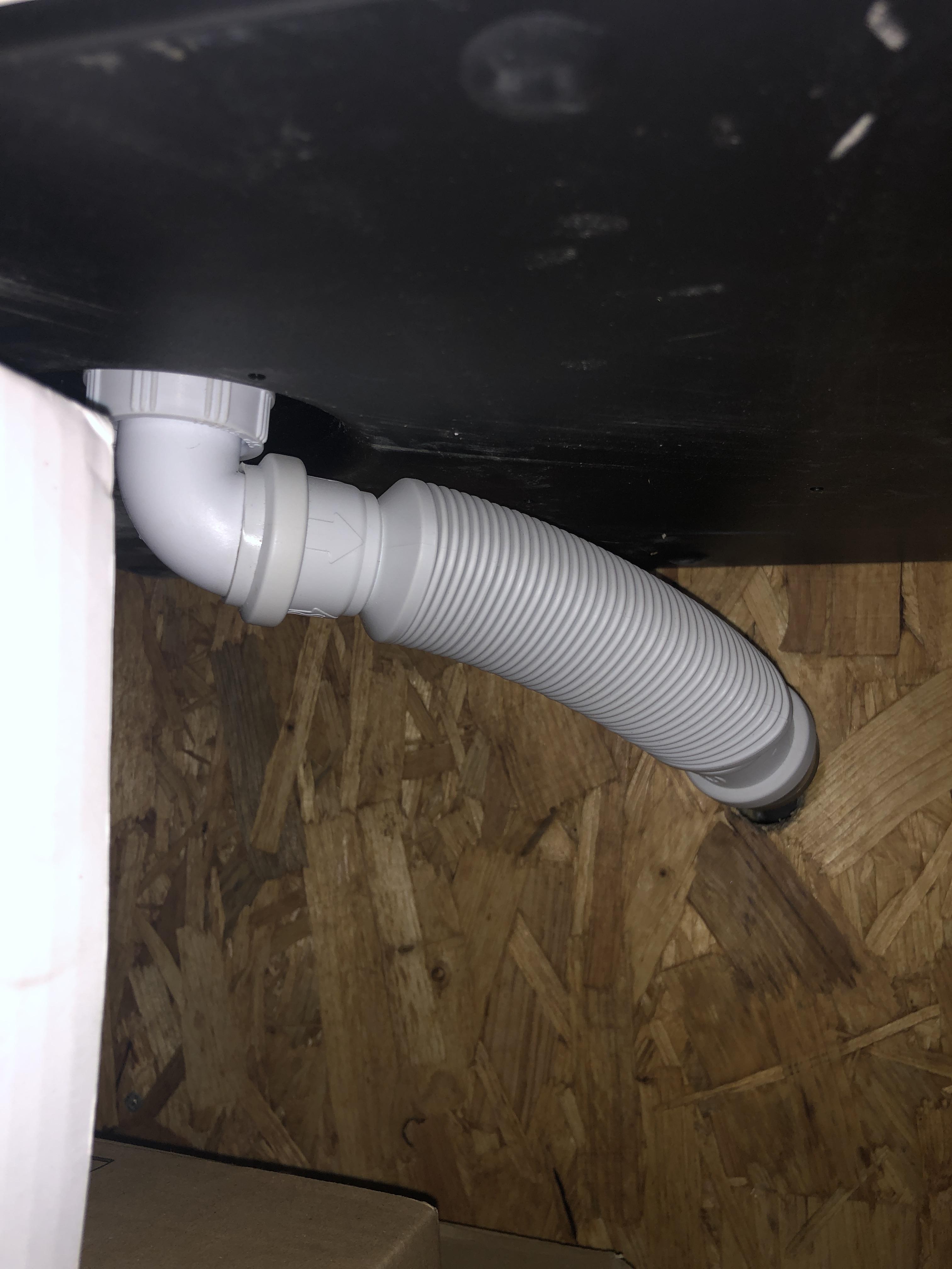

The instructions are pants . You need a believe a dry trap thing ( others will be a bit more accurate ) . I’ll show you mine if you show me yours though …
@pocsterWell that’s a much better idea ???
do u you have the same model?
