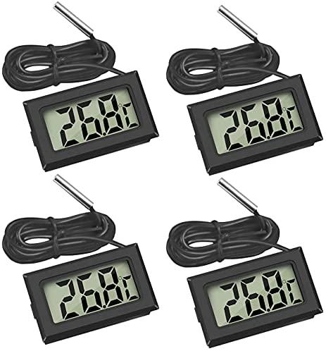

Onoff Posted December 10, 2021 Share Posted December 10, 2021 A few people on here have used this sort of cheap thermometer with a probe for testing/diagnosis (picked at random): https://www.amazon.co.uk/Thlevel-Thermometer-Temperature-External-Refrigerator/dp/B07TY6HRL4/ref=asc_df_B07TY6HRL4/? Link to comment Share on other sites More sharing options...
