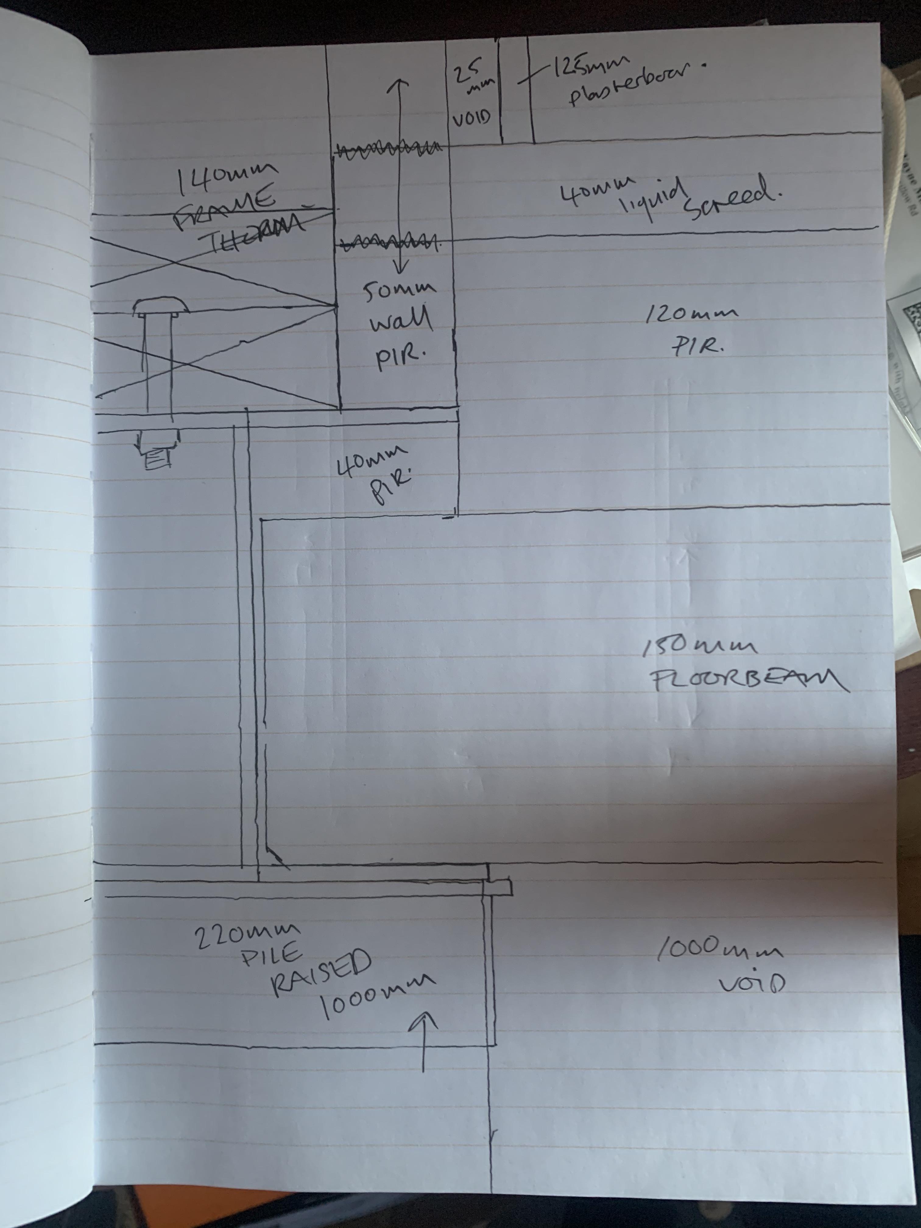

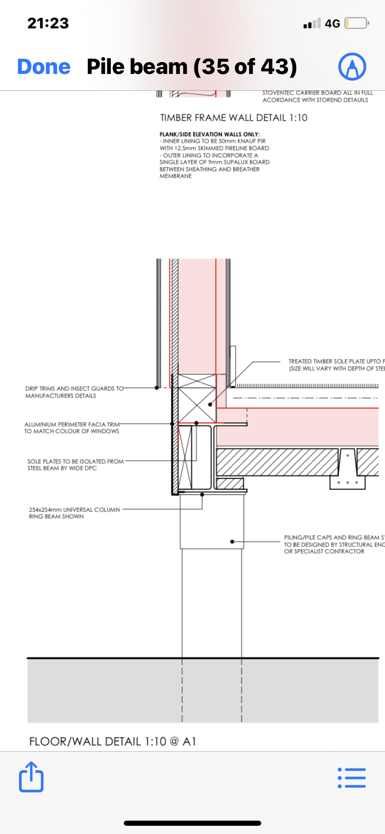

building timber frame onto steel beams bearing on raised piles. Does this need marmox or similar- or would continuous pir internally eliminate any use for it?
this detail is very similar- I’ll have 50mm pir,   Vcl and 25mm service void internally.

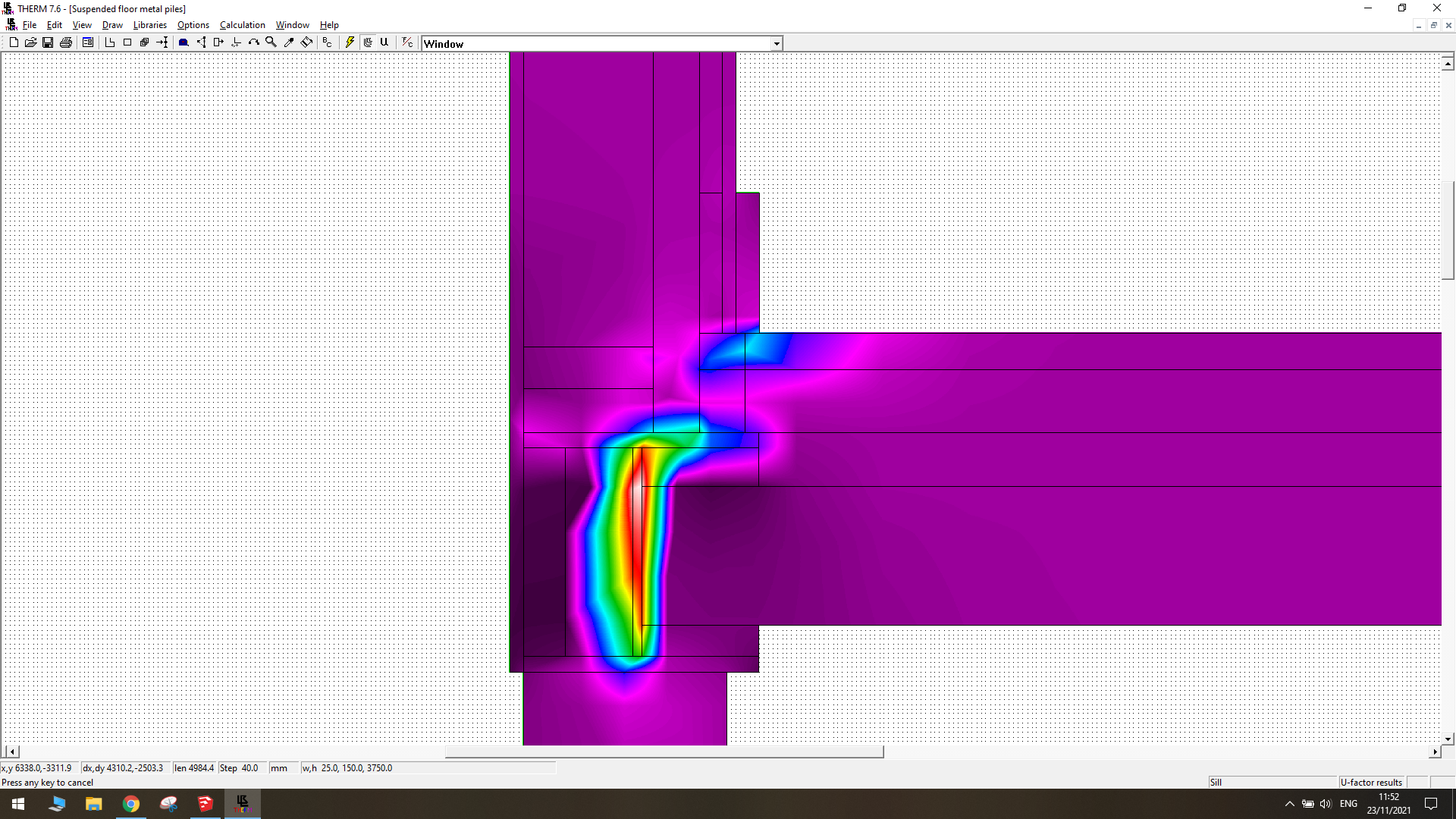

It's an intriguing design. I modeled it in Therm and came to the conclusion it'll be fine without.

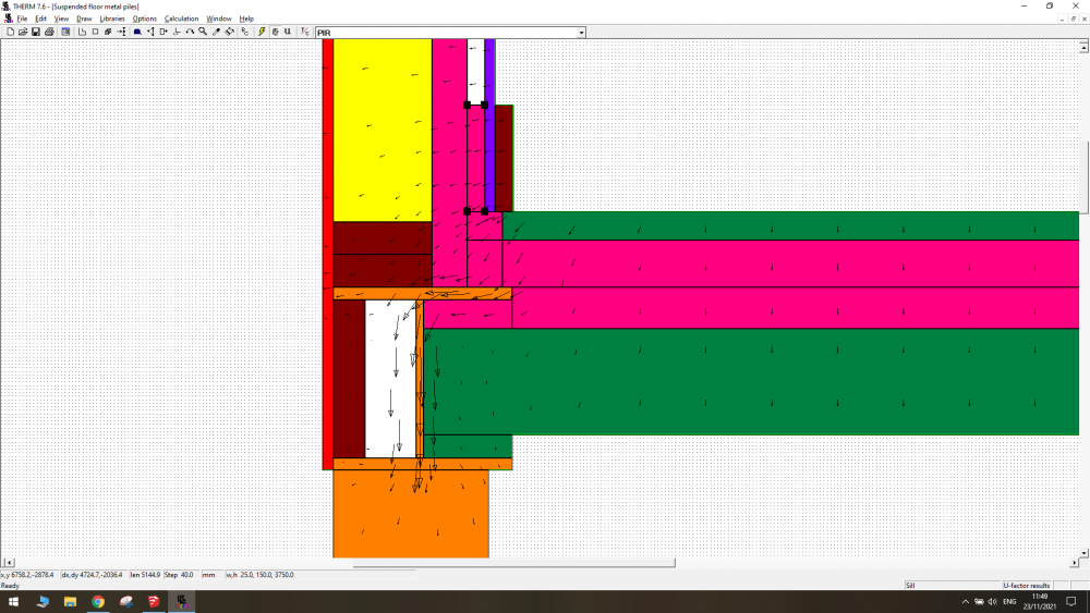

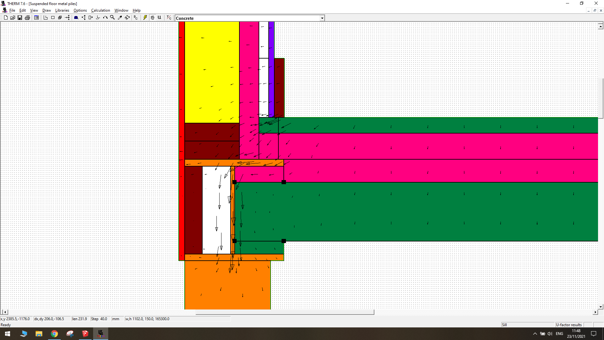

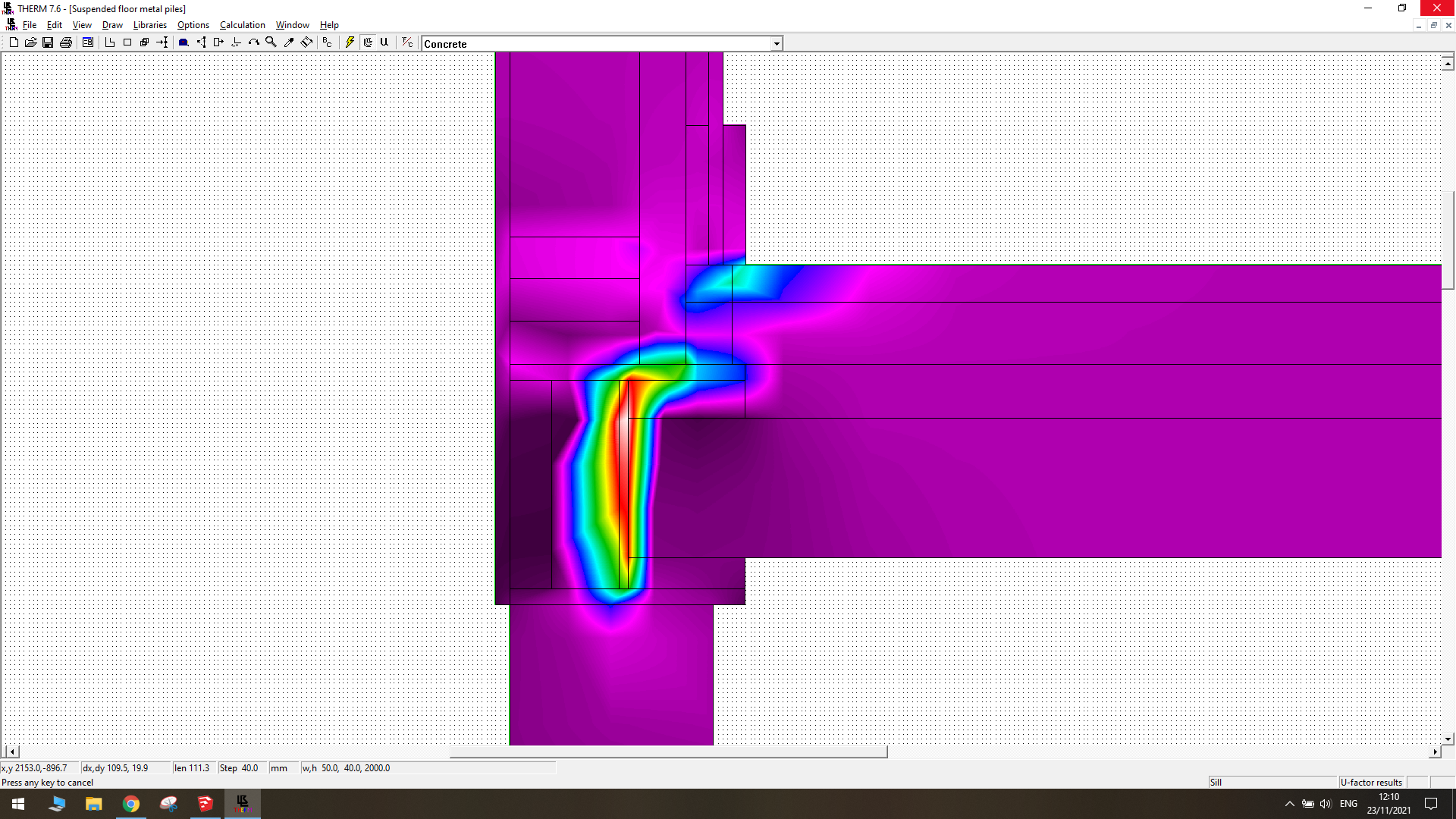

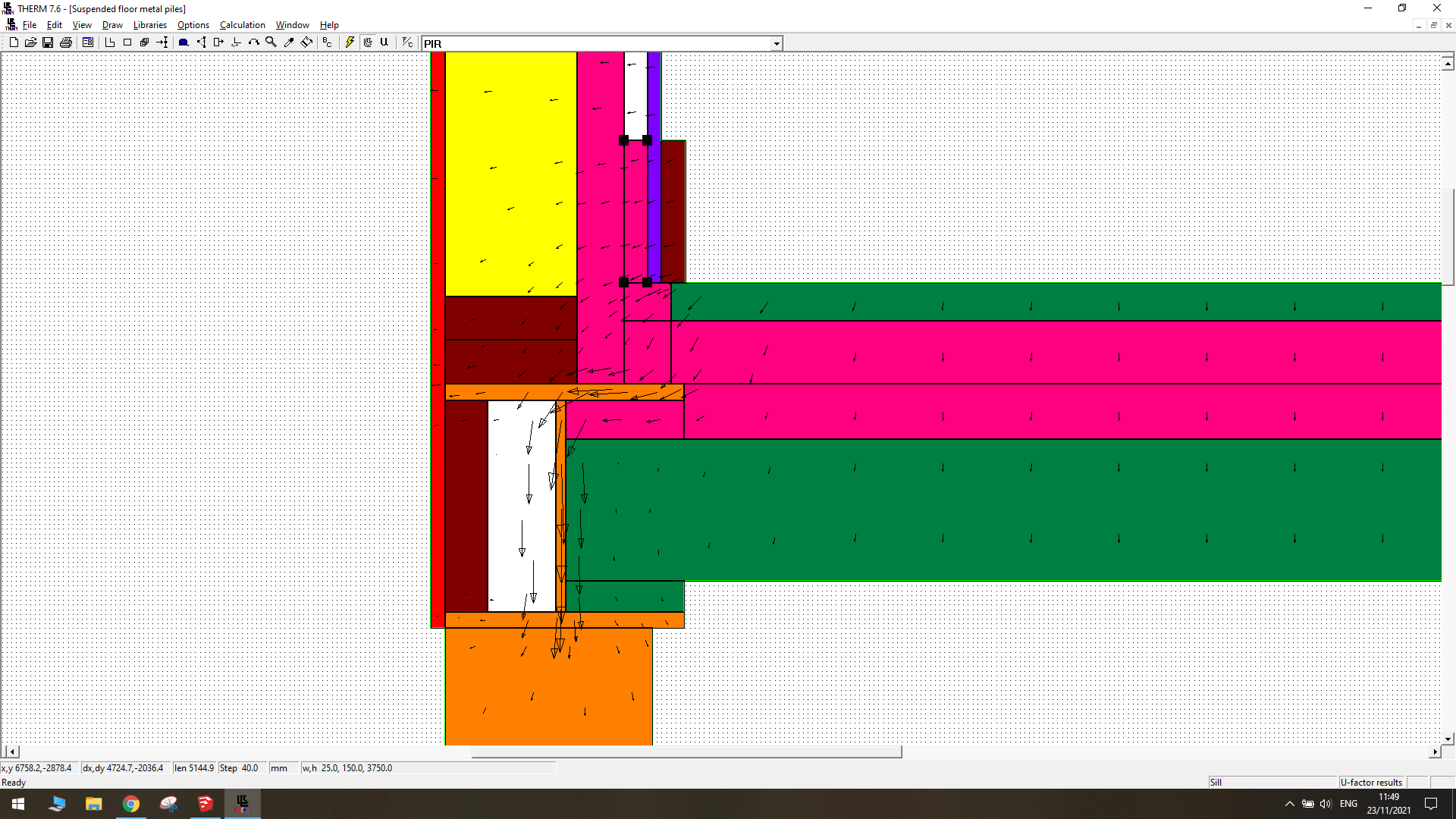

it’s probably more like below- I’m just wondering any merit in a thermal break or if it’s not really worth it :)

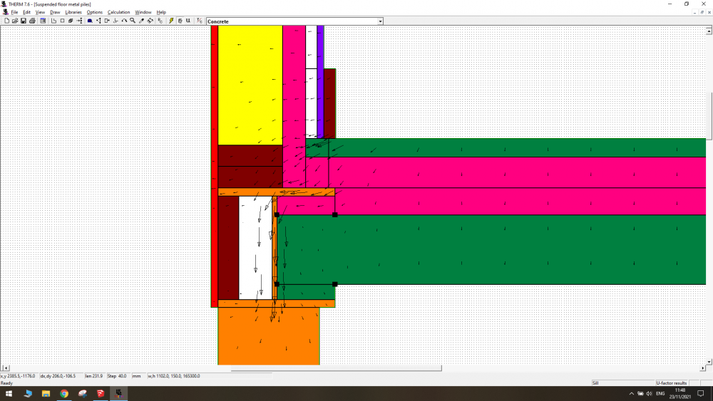

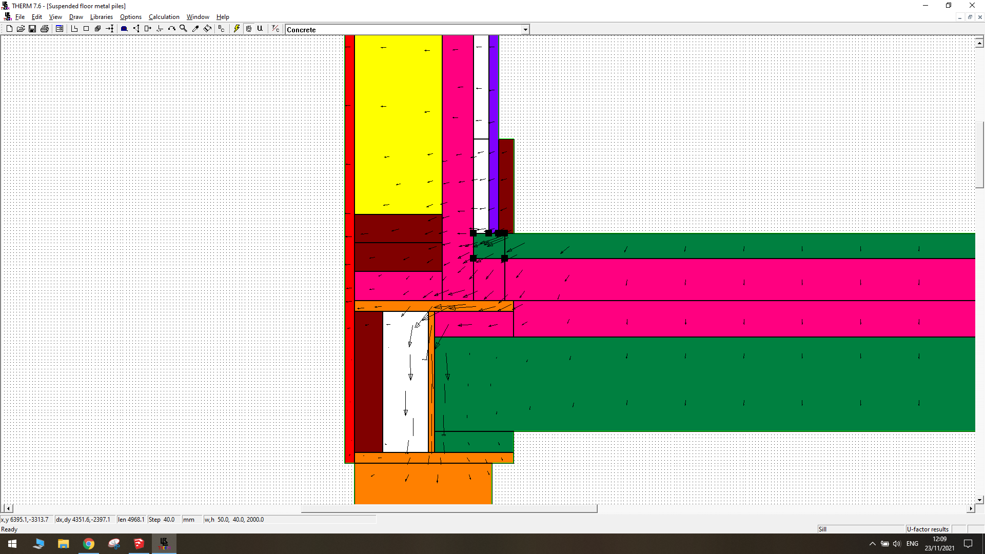

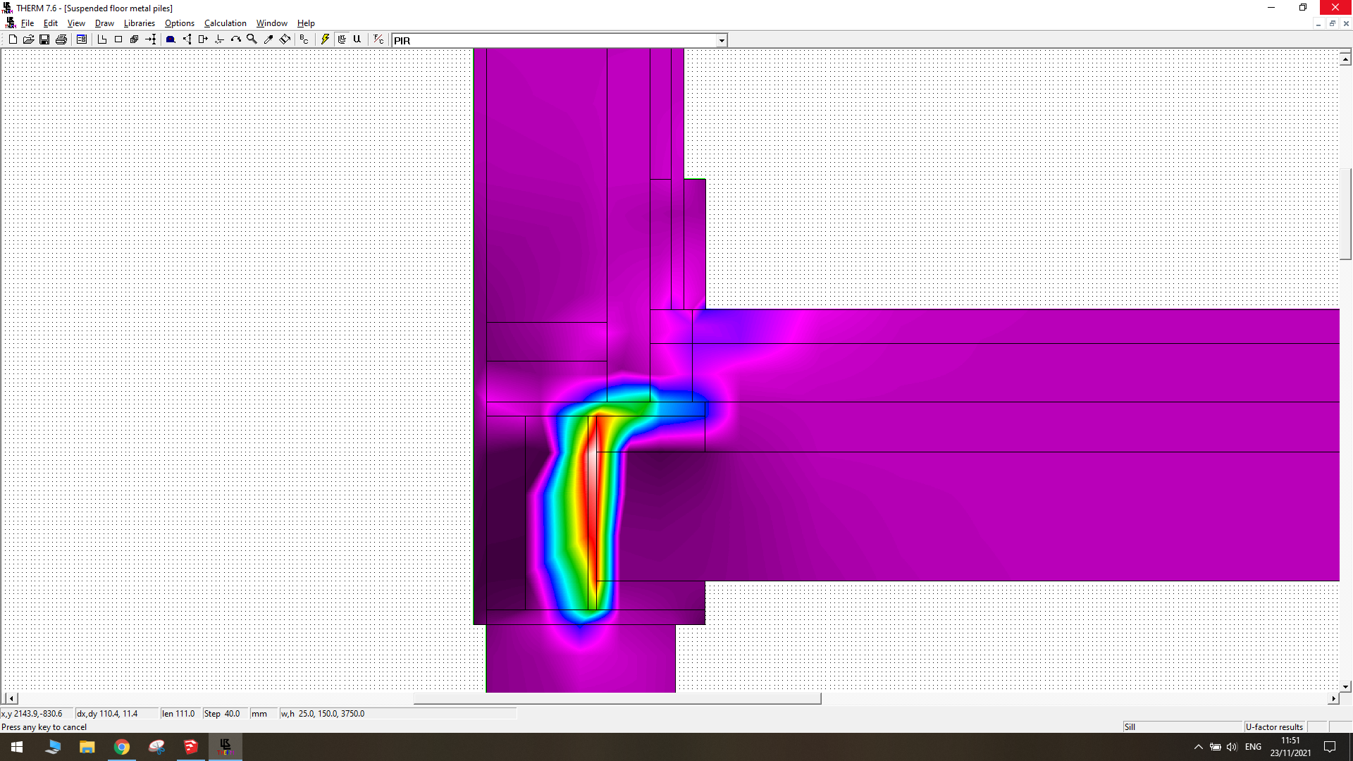

To be honest you're pretty good as you are. I've attached some pictures of the Therm drawing. You can see how significant the steel is. It really is a tremendous conductor. You should aim to keep it as far away as possible from the inside corner. I've done a slight modification in the second two drawings by putting an extra 50mm of PIR between the screed and the wall. and putting 150mm x 25mm of PIR in the bottom of the service cavity.
I reckon this reduces the internal thermal bridge from 0.0124w/mK to 0.0042w/mK or about three times better.
However it only would reduce your maximum heating load by 10w if your house had  a 50m perimeter! Like I said your design is fine as it is.
Out of interest if you were to add a 45mm thermal break under the soleplate it would make it worse. Your internal thermal bridge would go from 0.0124W/mK to 0.0129W/mK.  Hardly significant , about 1/2 a watt extra power peak heating load but really the definition of throwing money away for nothing.
With your existing design (unmodified) the external thermal bridge is -0.02w/mK which satisfies the Passivhaus criteria  <0.01w/mK.
