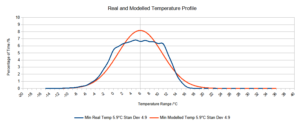

SteamyTea Posted November 25, 2021 Share Posted November 25, 2021 When a heat pump is running at full power, it is because the temperature difference between inside and outside the house is at maximum. This will affect the coefficient of performance, especially true for ASHPs. It is usual to size a heating system to cover 99% of the time heating is needed. This does not mean that during that 1% it supplies no heat, just that the CoP drops to parity i.e. you may as well have used a fan heater, or the internal temperature may be lower than the ideal temperature. The trouble with with methodology is that there is no scale, so you may be 0.1°C below the ideal temperature, or 15°C below it. So take where I live in Cornwall, I could set a minimum external temperature to -5°C and be fine. Up on the East Coast of Scotland, probably have to set that minimum temperature to -12°C (bit of a guess there as I have no idea what the temperature profile actually is). So apart from taking the possibility of frosting, in the case of ASHPs, into account, yes, set the size for the maximum load, or to the next available size up. It is possible to model the expected temperatures if you already know the external temperature profile. There are only two number that are needed, the mean temperature and the standard deviation (the spread of the temperature range). Then it is just a matter of creating a dataset of the temperature range and plotting it. This will create a chart similar to this: From that, you can add up all the percentages below the whatever temperature you turn your heating on from. These percentages are for the time the heating is on, not of total time i.e. 8760 hours in a year. So taking 12°C as the temperature you need to start the heating season, this gives a total percentage of 93% of the time for the real data and 91% for the modelled. Pretty close to the 99%. So probably going up to the next size HP will cover it, especially as my data is using the min real temperatures, not the mean, which is higher at 9.2°C and a SD of 5.4°C. The big frosting risk for an ASHP is between 0°C and 4°C, this is when water is most dense, so there is more to freeze. Summing up the percentage of time for those ranges give: Real 31% and Modelled 29%. By oversizing an ASHP (as opposed to a GSHP or EAHP), you get more running time before the defrost cycle needs to start. This is worth bearing in mind when heating DHW because that is for a shorter time and at a greater temperature (generally close to the units maximum). DHW is another reason to oversize a HP. The most important thing to do though is a proper heat loss calculation for your house, that will establish the power needed at any external temperature, the W.ΔK-1. Without that calculation being done, it becomes guesswork, and that is never good. 1 Link to comment Share on other sites More sharing options...
