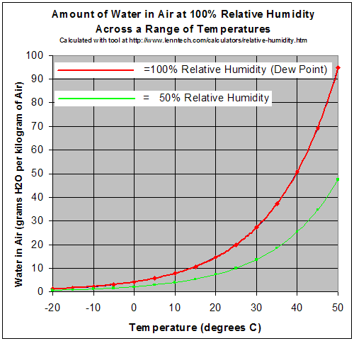

Triassic Posted October 11, 2021 Share Posted October 11, 2021 I’ve just started to look at the relative humidity in the new house. What sort of RH would you expect to achieve as the house dries out. Link to comment Share on other sites More sharing options...
Iceverge Posted October 11, 2021 Share Posted October 11, 2021 It depends on the temperature. From memory i think the most i saw was about 85% at 14 deg. That was a bit of an experiment though, the house was airtight and i closed all the windows overnight. If i had heated the same air to 20 degrees the relative humidity would probably have dropped to about 60% while the absolute humidity g/m3 water vapour would have stayed the same. When i opened all the windows and let air at 8 deg and 90% RH in the relative humidity dropped to about 65% once that air warmed up to 14 deg. Link to comment Share on other sites More sharing options...
