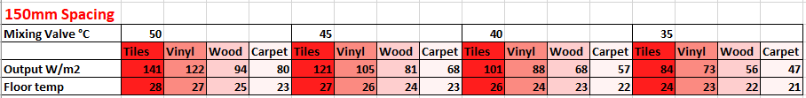

Flow temp should be house specific - floor/wall insulation, window sizes, final floor finish etc. - did the company you bought the UFH kit from provide any heat loss calcs? Based on each room's heat loss, you can work out the required W/m2 and go from there. Here's a rough guide I used for mine (150mm pipe centres);
Return temps generally depend on your flow temp. If the flow is less than 30 degrees, go for a return temp ~ 4 degrees lower. If it's more than 30 degrees, go for ~ 7 degrees lower. The delta-T can be managed by adjusting the flow rate on each loop until each one is something like.

As a rule of thumb, when I was doing mine, I got the delta-T on each loop to ~ 7 degrees by adjusting the flow rate and then slowly increased the flow temp until each room was comfortably reaching the thermostat temp, any hotter and you risk your room temps overshooting.
I used the heat loss calcs to guide me in the right direction, but my setup's currently running a flow temp 10 degrees cooler than the calcs suggested I would need...
