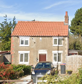

Ferdinand Posted October 6, 2021 Share Posted October 6, 2021 I have a chimney which is dropping little bits of brick and mortar off. Photo: Is it a better option to repoint, or to remove the stack and seal / ventilate the top appropriately? Originally the chimney had a cooking range below, then a gas flue installed, and is now unused since an electric fire is in the fireplace. The place was built in 1850-ish. Access is a little tricky, since there is a leanto on the side, and a sun lounge at the back. Can anyone give me an indication of what the costs would be for this? I'm guessing I am looking at approx £750 and maybe 2-3 man days. Any thoughts are most welcome. I will be getting in a couple of quotes this week. Cheers F Link to comment Share on other sites More sharing options...
Carrerahill Posted October 6, 2021 Share Posted October 6, 2021 If it was me I would get some access & a harness and go and remove all the roughcast, and then deep rake out the joints and repoint it, then roughcast it. Or I would get a roofer/builder type to do the same if I was in the right mood. I would not get rid of a chimney. I think the costs you have provisioned are about right. 1 Link to comment Share on other sites More sharing options...
