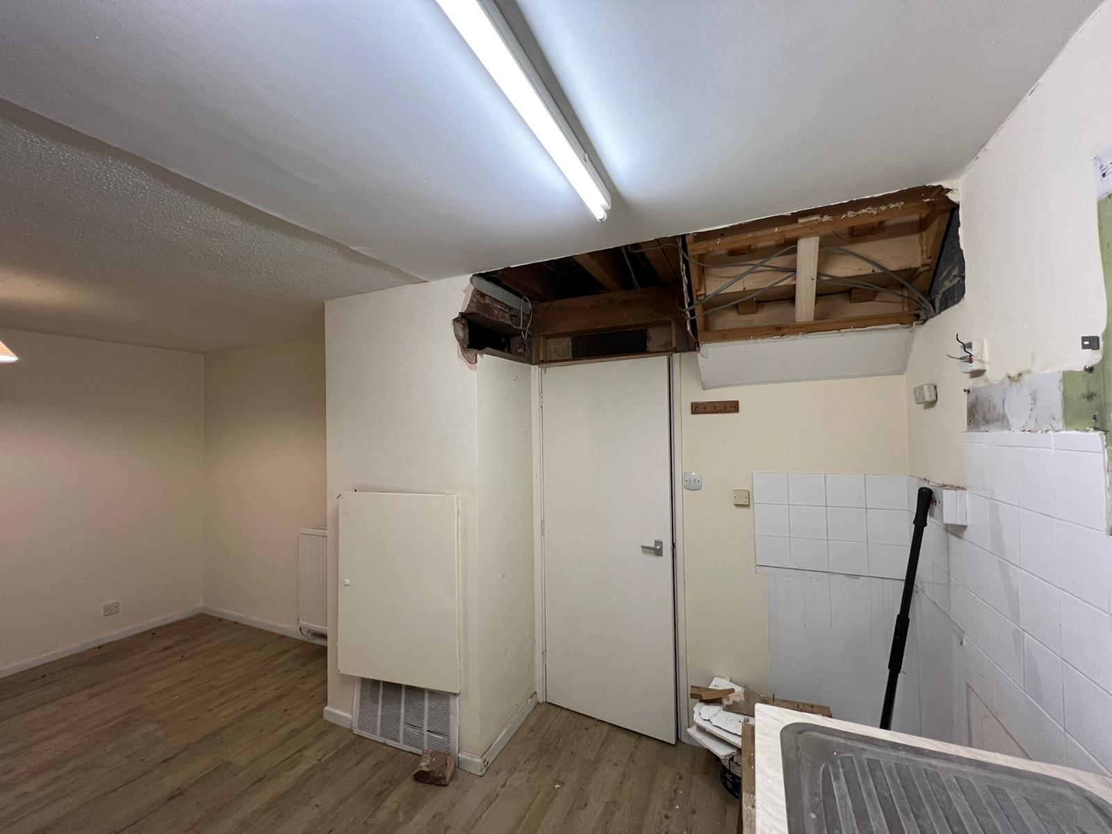

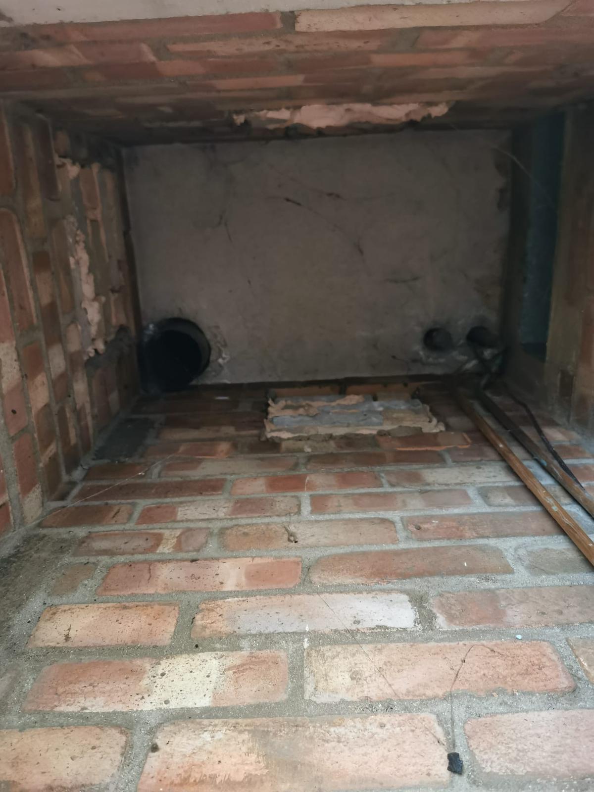

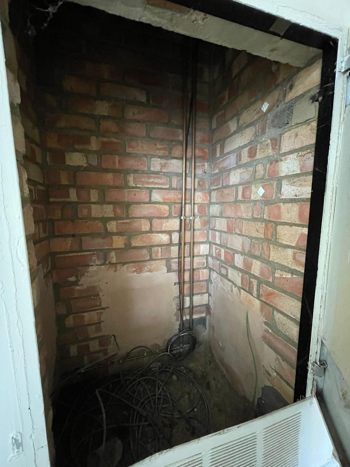

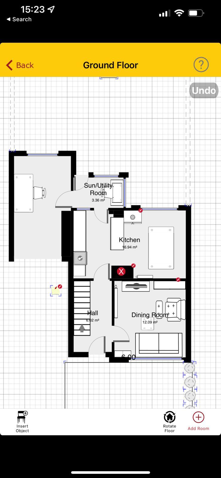

michaelthighland Posted October 6, 2021 Share Posted October 6, 2021 I have a brick wall enclosure (1m wide, and 0.6m depth, height floor to ceiling) that previously housed an old warm air boiler. I would like to remove the whole structure and make the wall flush against the main wall through the kitchen/dining room. Link to comment Share on other sites More sharing options...

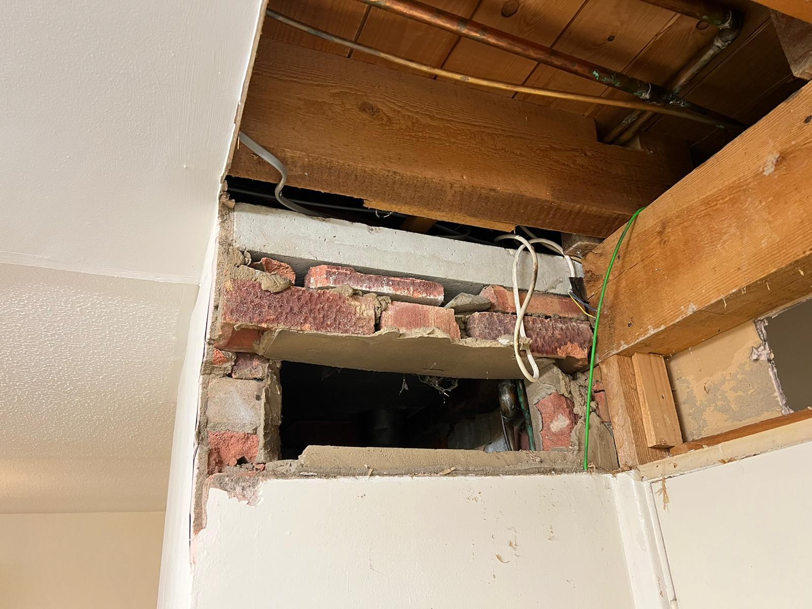

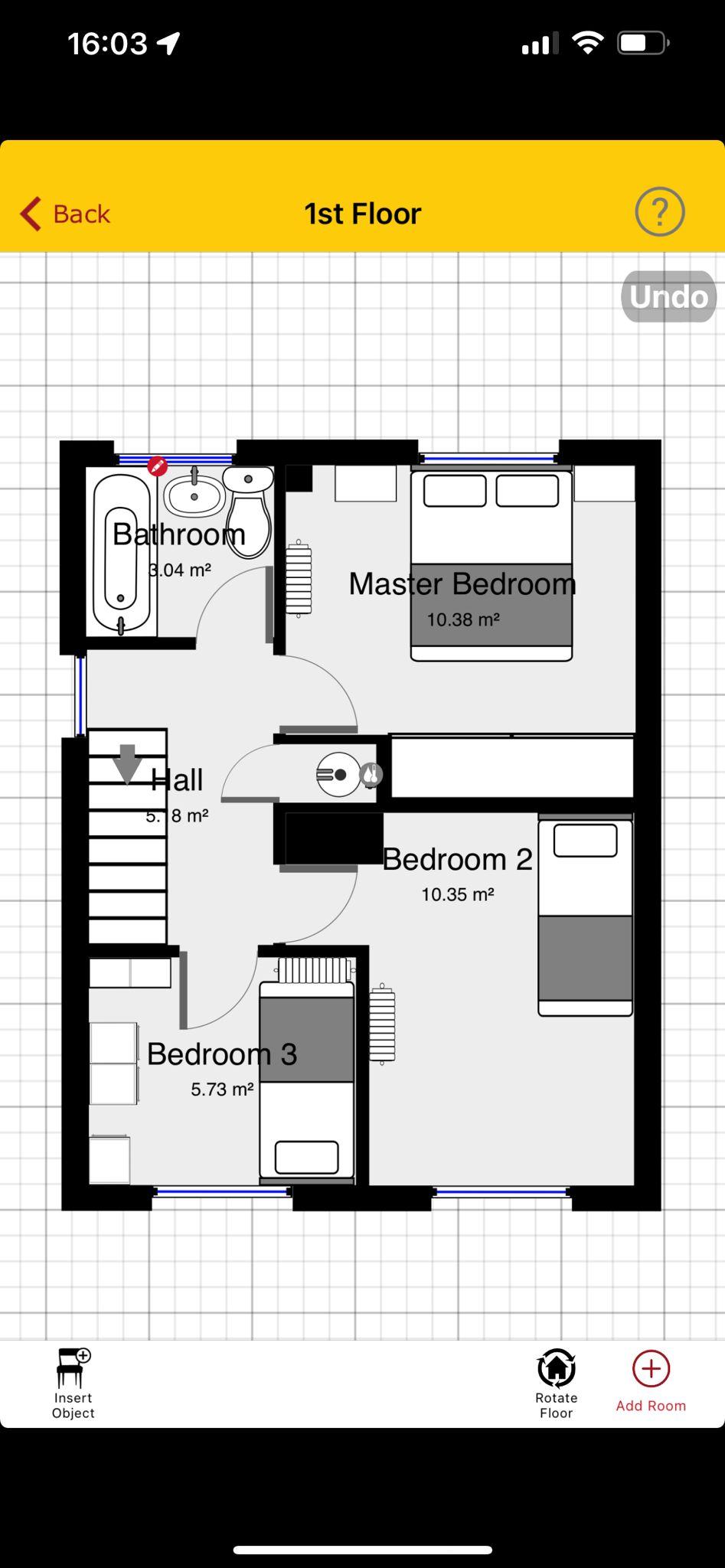

Mr Punter Posted October 6, 2021 Share Posted October 6, 2021 Does this continue up to the first floor? If so you may need to remove the first floor section or provide support for it. Link to comment Share on other sites More sharing options...
PeterW Posted October 6, 2021 Share Posted October 6, 2021 I would want to know what is on top of that concrete lintel Link to comment Share on other sites More sharing options...
