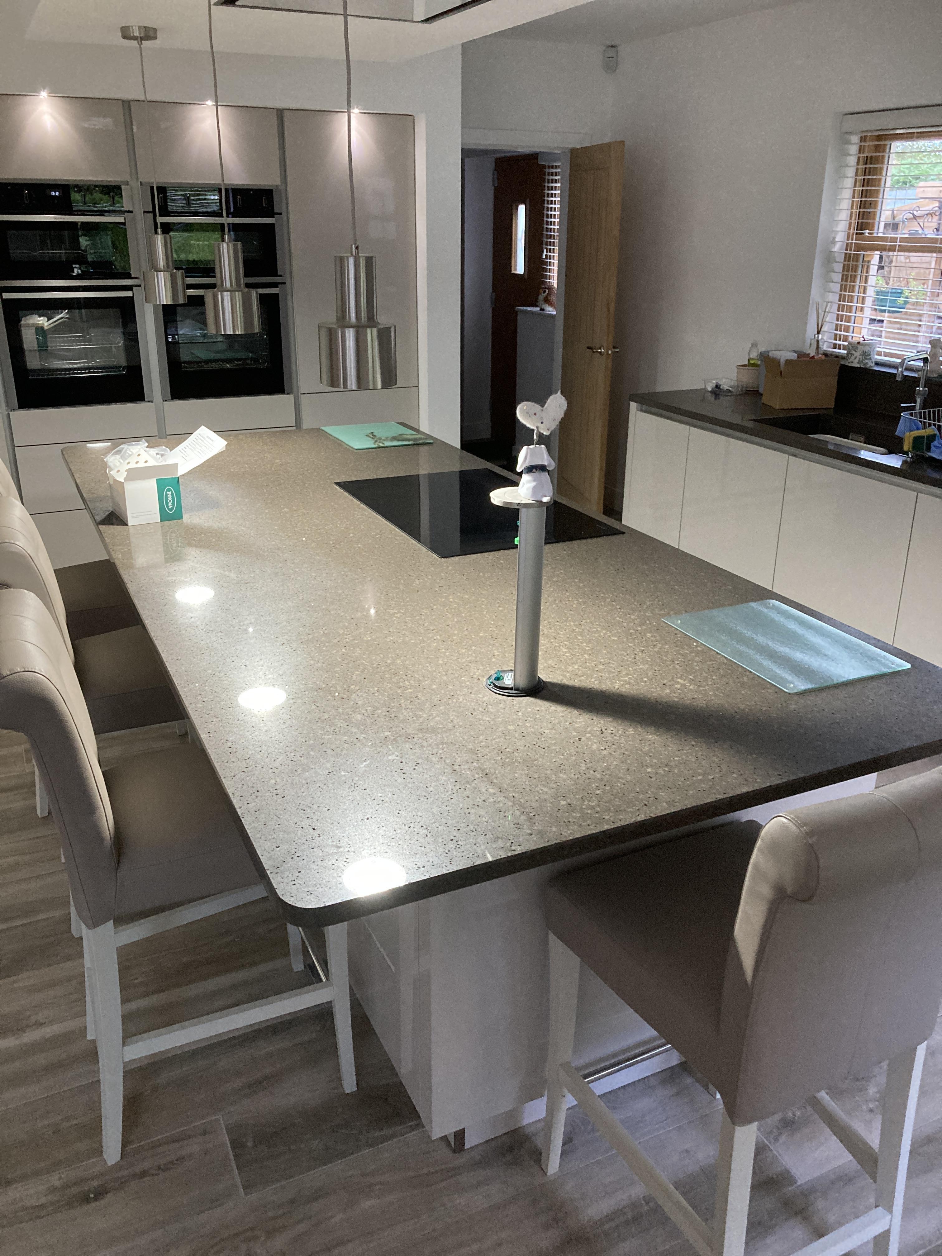

We installed a German kitchen and was persuaded not have the sink on the island
We used quarts for the top With a 350 overhang
  • Like 1
Posted (edited)
Thank you for the image.  That's the sort of overhang I want.
So looks like we'll be getting a quartz worktop.  The ceramics like Dekton just aren't strong enough for more than 25 cm overhang, and the cutout for the prep sink makes it even worse.

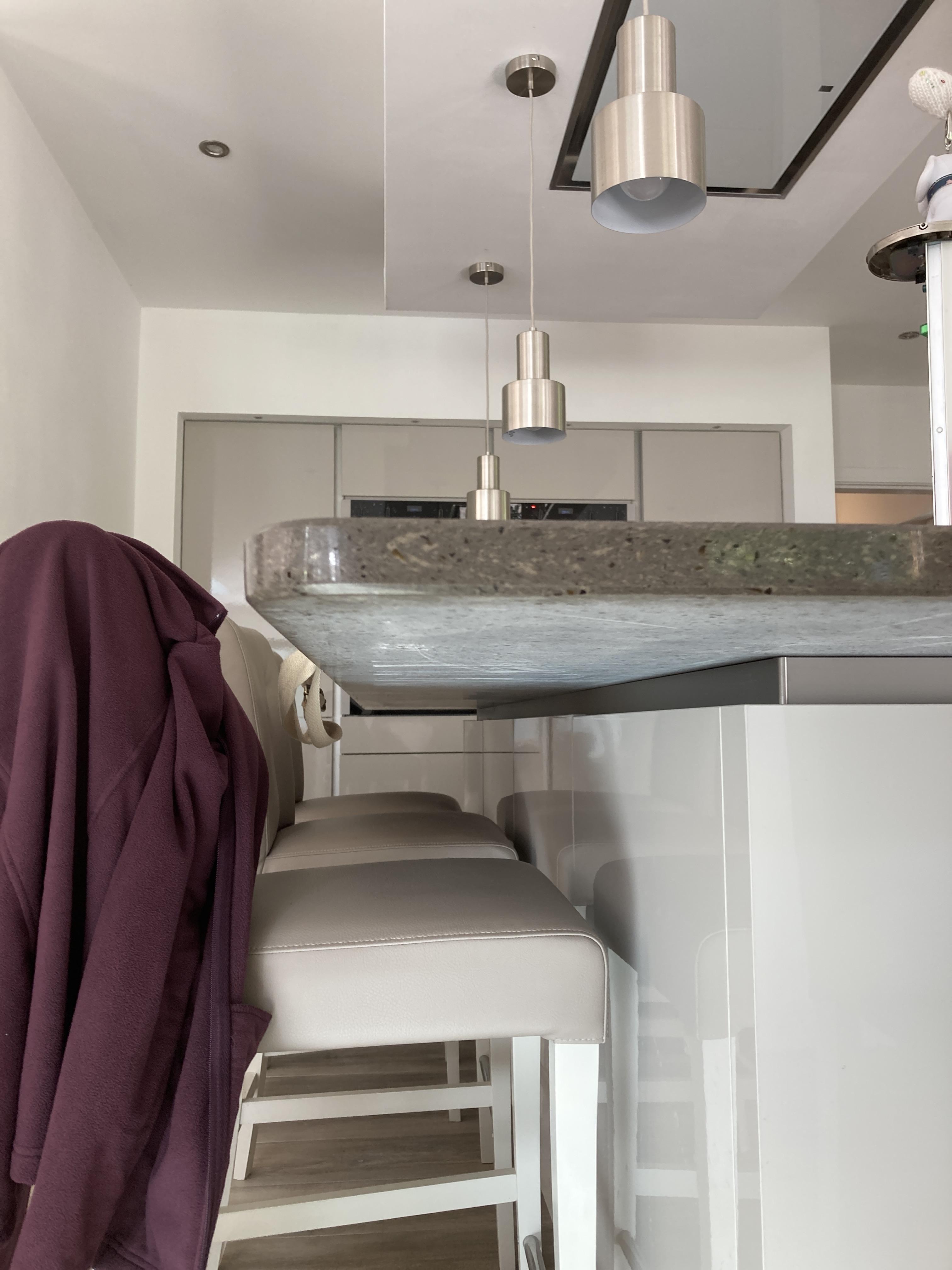

Posted
Quite a big chunk
Took three of us to lift it into place
