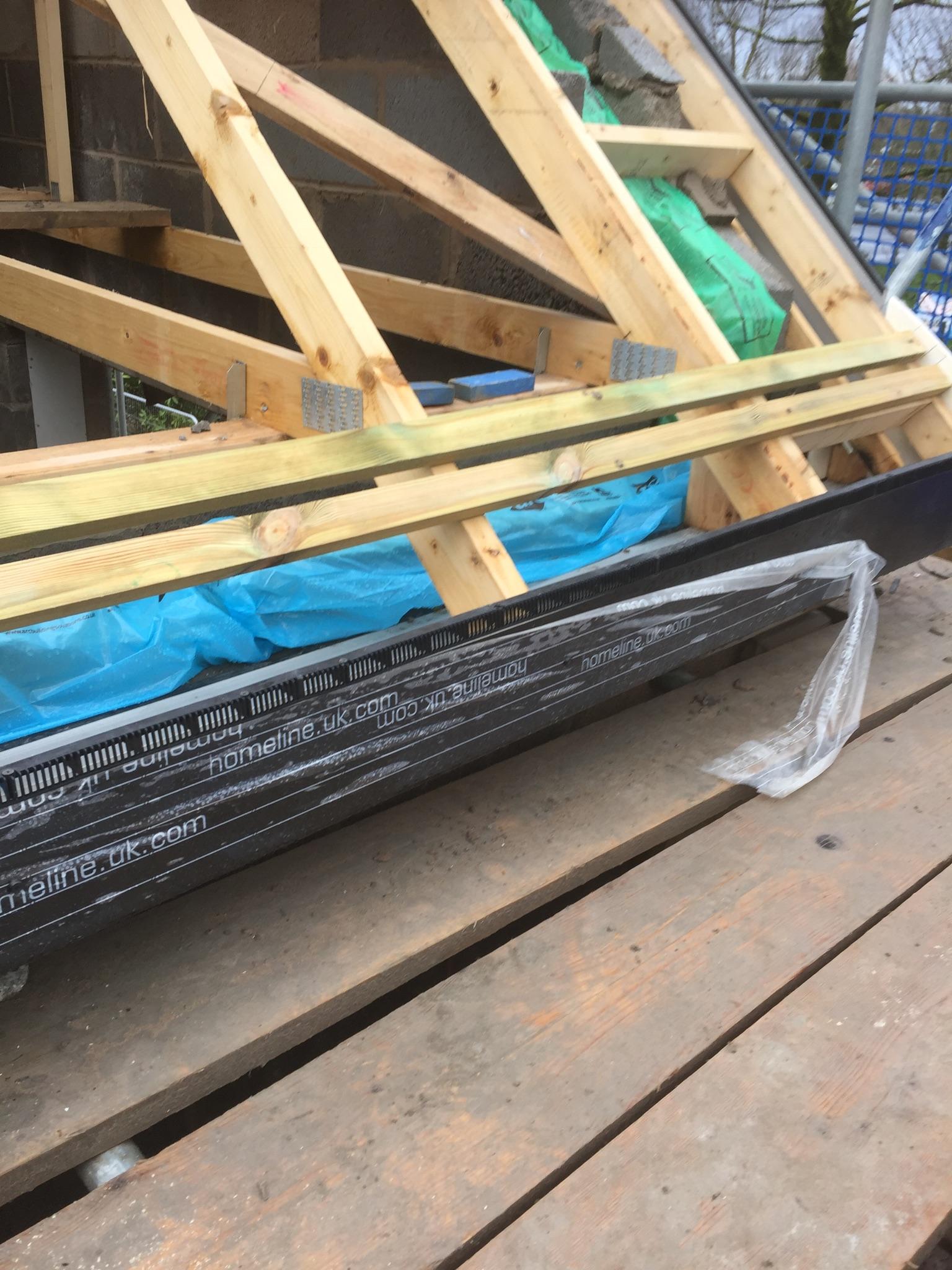

WWilts Posted September 30, 2021 Share Posted September 30, 2021 2 storey dwelling with possible upward extension later. Blown EPS beads cavity wall insulation. Is it advisable to install cavity barriers (fire protection) in the walls during the 2 storey build? If so, what material and at what height? Link to comment Share on other sites More sharing options...
nod Posted October 1, 2021 Share Posted October 1, 2021 It’s normal to put cavity socks around the perimeter of the building at wall plate height Simply push them in a dpi tire with a knife 1 Link to comment Share on other sites More sharing options...
