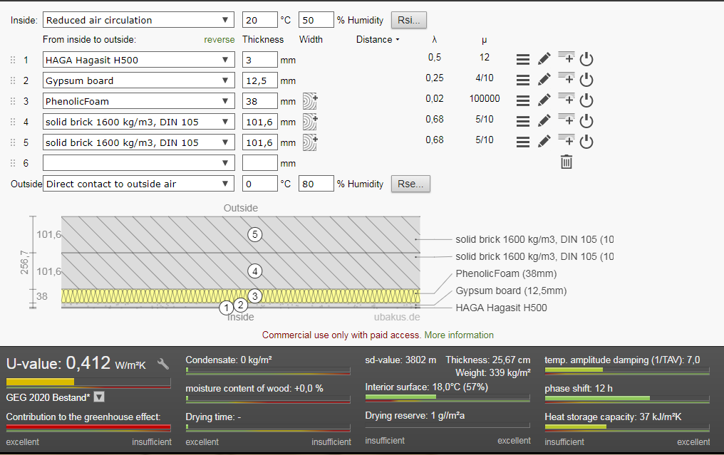

howplum Posted September 27, 2021 Share Posted September 27, 2021 My modest 3 bedroom detached house, which is in a conservation area, was built in 1936 and three of the walls are solid, although strangely the south facing wall is of cavity construction, which is insulated. There is a modern composite front door, with a glazed porch, and all the double glazed window panels have been upgraded to the latest specification because the existing 20 year old units were deteriorating. In my view energy prices will ever only get more expensive so I am investigating improving the insulation of the house as whole and think that insulated plasterboard might be the best solution because it seems to give the best improvement without encroaching too much on the floor and being reasonably DIY friendly. Payback is not a factor because the aim is to make the house more efficient in terms of heat retention overall, hopefully with a small reduction in the monthly fuel bill. Apparently, according to Homebuilding.co.uk anyway, the current U-value of a solid brick wall is around 1.9W/m2. I have been looking at insulated plasterboard and 50mm Gyproc Thermaline Super allegedly has a U-value of 0.020W/mK - a significant improvement. However, I notice the two figures are expressed slightly differently, is this important? In other words, am I comparing like with like? Does the lower figure of the insulated board override the higher figure of the wall, or is there some formula to combine the two? I appreciate there are practical hurdles to overcome, such as fitted wardrobes, radiators, electrical sockets, window reveals and boards, bay windows, skirting boards, coving, carpets, plastering, decorating and no doubt others I haven't spotted yet. Obviously this will involve major disruption so I plan to do it on a room by room basis. Any advice, hints or tips would be appreciated. Link to comment Share on other sites More sharing options...

A_L Posted September 27, 2021 Share Posted September 27, 2021 1 hour ago, howplum said: I notice the two figures are expressed slightly differently, is this important? In other words, am I comparing like with like? They are two different parameters. The second is the thermal conductivity of a single material and is independent of material thickness. A two brick solid wall has a U-value of approximately 2.03. This means it has a thermal resistance of 1/2.03 or 0.49m2K/W Where you have a thermal conductivity the thermal resistance of a layer is thickness in metres/thermal conductivity. You can then add all the thermal resistances together and take the reciprocal to get the new U-value. 75mm of your insulation will be needed to get below the requirement for renovations to achieve not more than U=0.3 (Part L1B) It will give U=0.234. 1 Link to comment Share on other sites More sharing options...
IanR Posted September 27, 2021 Share Posted September 27, 2021 (edited) 2 hours ago, howplum said: the current U-value of a solid brick wall is around 1.9W/m2. 50mm Gyproc Thermaline Super allegedly has a U-value of 0.020W/mK There is a bit of a mix up in the units. Typical units for U Value are W/m².K . the 1.9 figure you have looks "about right" for a 9" solid wall with some plasterboard on it, so that's probably 1.9W/m².K The value you have for the Gyproc Thermaline Super looks more like a λ (lambda) value ie. Thermal Conductivity of the phenolic foam part of the composite board. The typical units for an λ value are W/m.K. But the boards are made up of gyproc wall board (λ 0.19W/mK) + the phenolic foam (λ 0.020W/mK). If you wanted to workout the thermal resistance (R value) of the whole board thickness, you need to divide each material's thickness in meters, by its λ value to get its R value, and add the R values together. Typical units for R are m².K/W For the 50mm thick Gyproc Thermaline then, that's (0.012 / 0.19) + (0.038 / 0.020 ) = 1.96 m².K/W (I've assumed 12mm gyproc and therefore 38mm phenolic foam) To get to the U value, you need to 1 / (sum of the R values). For the Thermaline on it's own that means the U vlaue is 1/1.96 = 0.51 W/m².K But to see how this effects your wall if added on, then you need to revert the wall's U value to it's R value ie. 1/1.9 = 0.53 W/m².K And then to get the total U Value of the new wall build up: 1 / ( R of original wall + R of the Thermaline), so 1/ (0.51 + 0.53) = 0.96W/m².K Edited to add: There are online calculators to make this easier https://www.ubakus.com/ Edited September 27, 2021 by IanR 1 Link to comment Share on other sites More sharing options...
IanR Posted September 28, 2021 Share Posted September 28, 2021 (edited) 12 hours ago, IanR said: And then to get the total U Value of the new wall build up: 1 / ( R of original wall + R of the Thermaline), so 1/ (0.51 + 0.53) = 0.96W/m².K Apologies, in the very last calc., I've incorrectly used the the Thermaline's U Value and not its R Value. So, what I should have said is: And then to get the total U Value of the new wall build up: 1 / ( R of original wall + R of the Thermaline), so 1/ (0.51 + 1.96) = 0.405W/m².K Edited to add: ...and Ubakus roughly agrees Edited September 28, 2021 by IanR 1 Link to comment Share on other sites More sharing options...

howplum Posted September 28, 2021 Author Share Posted September 28, 2021 After a bit of digging it looks as though using a 60/12.5mm insulated plasterboard fixed with dot and dab could reduce the U-Value to around 0.30 W/m2K, which is a lot better than the existing figure. As part of the process I would block up both fireplaces in the lounge/study, which will no doubt help even further. Has anyone out there done this before? It's all very well me reading about it, but there is nothing like a first hand account to bring a sense of reality. Link to comment Share on other sites More sharing options...
A_L Posted September 28, 2021 Share Posted September 28, 2021 @howplum, I get U=0.28, given central England and a typical heating regime this will reduce heat loss by about 40kWh/m2/year 1 Link to comment Share on other sites More sharing options...
