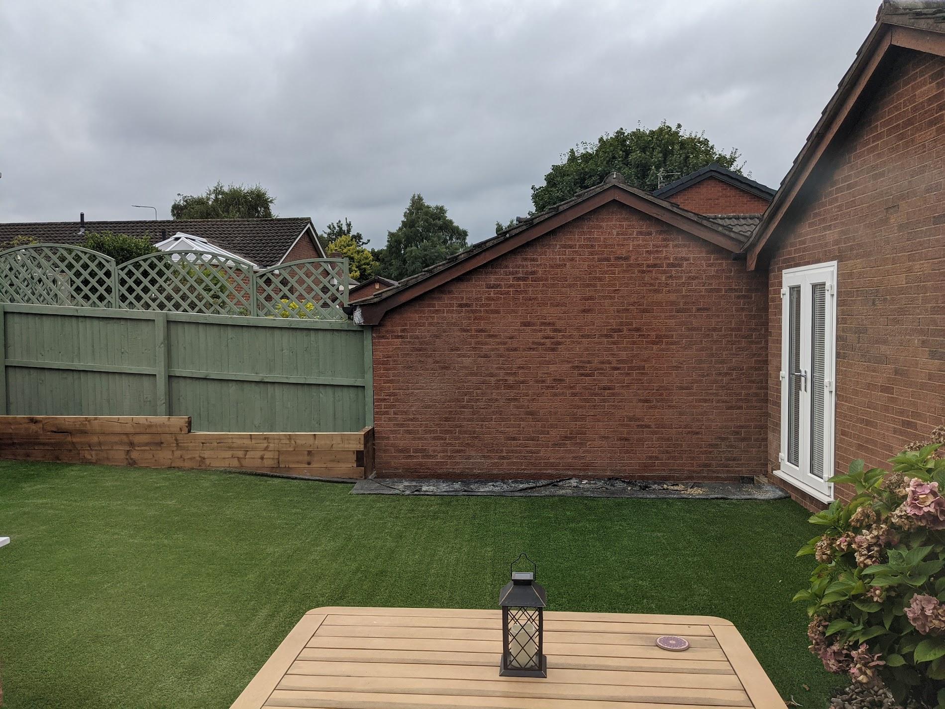

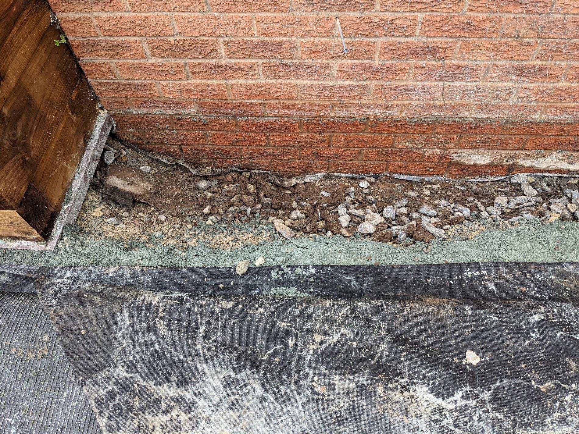

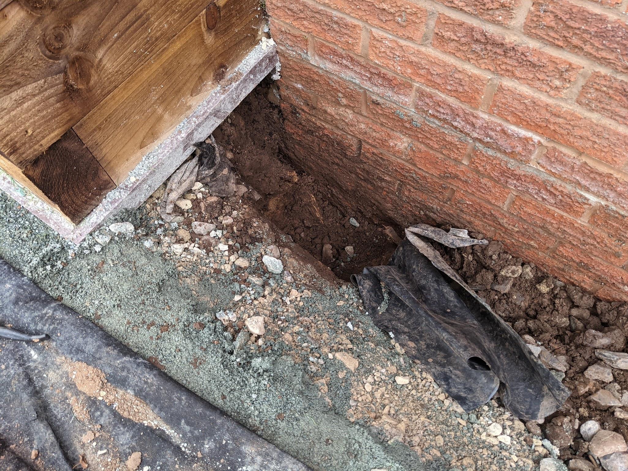

JoeGenoa Posted September 22, 2021 Share Posted September 22, 2021 We had a torrential downpour a couple of weeks ago and unfortunately this caused water leaking through to the neighbour's adjoining garage from the side of our garden. This was due to recently installed artificial grass being at too high a level against the wall. We dug down to its original level before the grass, and further still as shown in the pics. It's 2 bricks below the DPC. The plan now is to have sleepers all the way across the wall and then deck boards on top to act as a lid. My question is should we add anything further to the trench to prevent any further issues? It's back at the level where there wasn't any issues but if we need to add gravel or a soakaway solution as well then we would definitely consider that. I'm thinking gravel would help more dirt falling into the trench over time? Many thanks for any advice given. Link to comment Share on other sites More sharing options...

Temp Posted September 22, 2021 Share Posted September 22, 2021 If their foundations allow, you could dig a bit deeper, put in a perforated pipe leading to your (or their rainwater?) rainwater drains and cover with gravel. Keep the top of the gravel 2-3 bricks below DPC. If you want to fill the trench higher you would need to tank the side of his garage and then do the above. Personally I wouldn't do this. Link to comment Share on other sites More sharing options...
JoeGenoa Posted September 24, 2021 Author Share Posted September 24, 2021 On 22/09/2021 at 12:38, Temp said: If their foundations allow, you could dig a bit deeper, put in a perforated pipe leading to your (or their rainwater?) rainwater drains and cover with gravel. Keep the top of the gravel 2-3 bricks below DPC. If you want to fill the trench higher you would need to tank the side of his garage and then do the above. Personally I wouldn't do this. Thanks. If the gravel is good for drainage could we not have it higher than the DPC? Link to comment Share on other sites More sharing options...
Temp Posted September 25, 2021 Share Posted September 25, 2021 15 hours ago, JoeGenoa said: Thanks. If the gravel is good for drainage could we not have it higher than the DPC? Shouldnt really as rain can splash onto wall above the dpc. Link to comment Share on other sites More sharing options...
