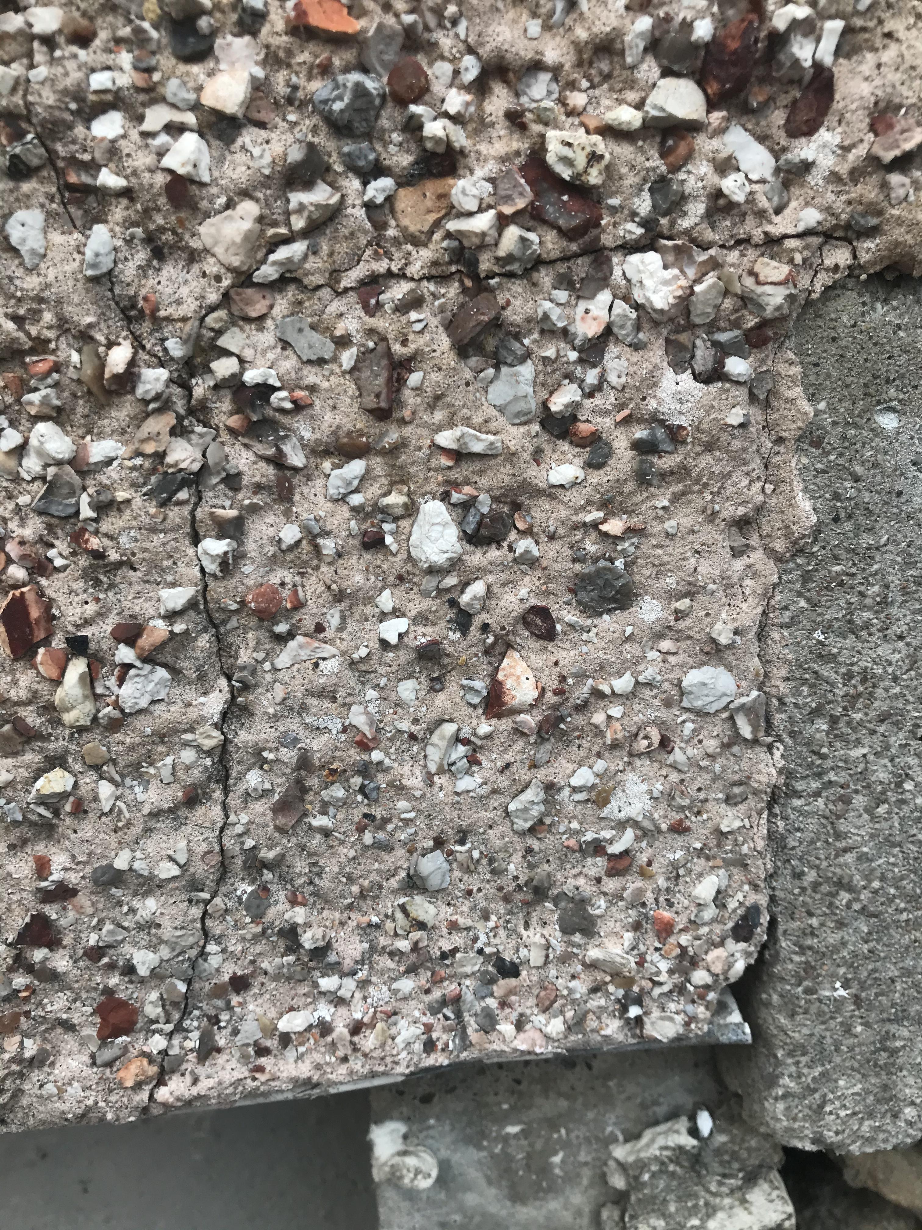

Steph2209 Posted September 20, 2021 Share Posted September 20, 2021 Hi, looking for some help please? Would anyone know what colour of render has been used in the attached image, looking to make a repair to my pebble dash and I’ve been advised the colour of this render is old and not available now. Happy to have any recommendations that’s a close enough match as right now my roughcaster wants to use a grey render and I’m not to keen on this at all. Thank you Link to comment Share on other sites More sharing options...
bassanclan Posted September 20, 2021 Share Posted September 20, 2021 It looks like rough cast/pebbledash to me which is a sand cement/lime mix with stones added to provide decoration and texture. The sand/cement/lime mix determines the colour of the background. It will be very difficult, almost impossible to match it seamlessly. It looks like a lot is cracked anyway. Your choices are either to have a deliberate break and a change of colour. Rerender the whole elevation/panel Paint the whole elevation Or accept that it will never be totally matching Link to comment Share on other sites More sharing options...
nod Posted September 20, 2021 Share Posted September 20, 2021 (edited) I re dashed a friends house and garage as a favor over lockdown Dry dash Colour is Canterbury spar Edited September 20, 2021 by nod 1 Link to comment Share on other sites More sharing options...
