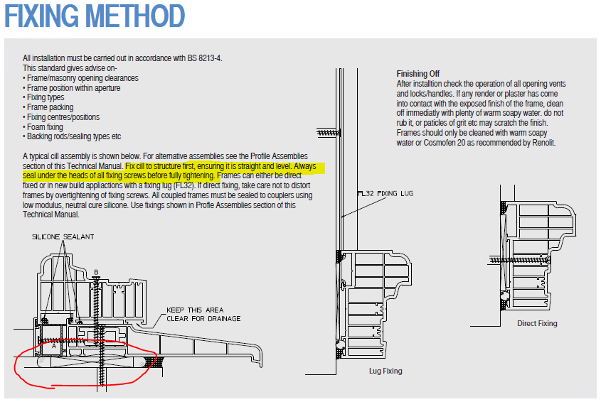

MortarThePoint Posted September 23, 2021 Author Posted September 23, 2021 On 20/09/2021 at 18:56, craig said: http://hwlwindowsgroup.com/wp-content/uploads/2019/09/RESIDENCE-INSTALLATION-GUIDE.pdf I found the information below in another one of their documents. This looks good for installing in sections. Any idea what the material I have circled in red is? It's not something the windows have come with and I presume it is something slightly compliant to avoid pressure concentrations.
craig Posted September 23, 2021 Posted September 23, 2021 1 minute ago, MortarThePoint said: Any idea what the material I have circled in red is? Just a packer by the looks of it.

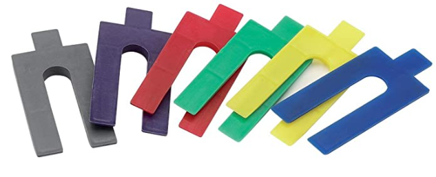

MortarThePoint Posted September 23, 2021 Author Posted September 23, 2021 1 minute ago, craig said: Just a packer by the looks of it. Thanks. Just standard frame packers like pictured below? I'm so used to beds of mortar under wallplates that it always feels like a nice way of spreading the load https://www.amazon.co.uk/Draper-44006-Plastic-Packers-Pieces/dp/B001233ZJC/
craig Posted September 23, 2021 Posted September 23, 2021 Yes, I prefer these types though. https://www.amazon.co.uk/Glazing-Packers-Spacers-Plastic-Available/dp/B08L89KLL1/ref=sr_1_1_sspa?dchild=1&keywords=window+packers&qid=1632409325&s=diy&sr=1-1-spons&psc=1&spLa=ZW5jcnlwdGVkUXVhbGlmaWVyPUEyQ1FCRjNLNE1XRzFXJmVuY3J5cHRlZElkPUEwNTY4ODA4MTJORDNZNDRFUDhCQyZlbmNyeXB0ZWRBZElkPUEwMjMwNjM5MU40Vjg0OFpaU0hJMiZ3aWRnZXROYW1lPXNwX2F0ZiZhY3Rpb249Y2xpY2tSZWRpcmVjdCZkb05vdExvZ0NsaWNrPXRydWU=
MortarThePoint Posted September 23, 2021 Author Posted September 23, 2021 3 minutes ago, craig said: Yes, I prefer these types though. https://www.amazon.co.uk/Glazing-Packers-Spacers-Plastic-Available/dp/B08L89KLL1/ref=sr_1_1_sspa?dchild=1&keywords=window+packers&qid=1632409325&s=diy&sr=1-1-spons&psc=1&spLa=ZW5jcnlwdGVkUXVhbGlmaWVyPUEyQ1FCRjNLNE1XRzFXJmVuY3J5cHRlZElkPUEwNTY4ODA4MTJORDNZNDRFUDhCQyZlbmNyeXB0ZWRBZElkPUEwMjMwNjM5MU40Vjg0OFpaU0hJMiZ3aWRnZXROYW1lPXNwX2F0ZiZhY3Rpb249Y2xpY2tSZWRpcmVjdCZkb05vdExvZ0NsaWNrPXRydWU= Great, I have a bag of ones similar to those as well. https://www.amazon.co.uk/gp/product/B07NWMCDVP/ That type is often described as glazing packers and used between the glazing unit and the sash frame, but should be good under the cill too.

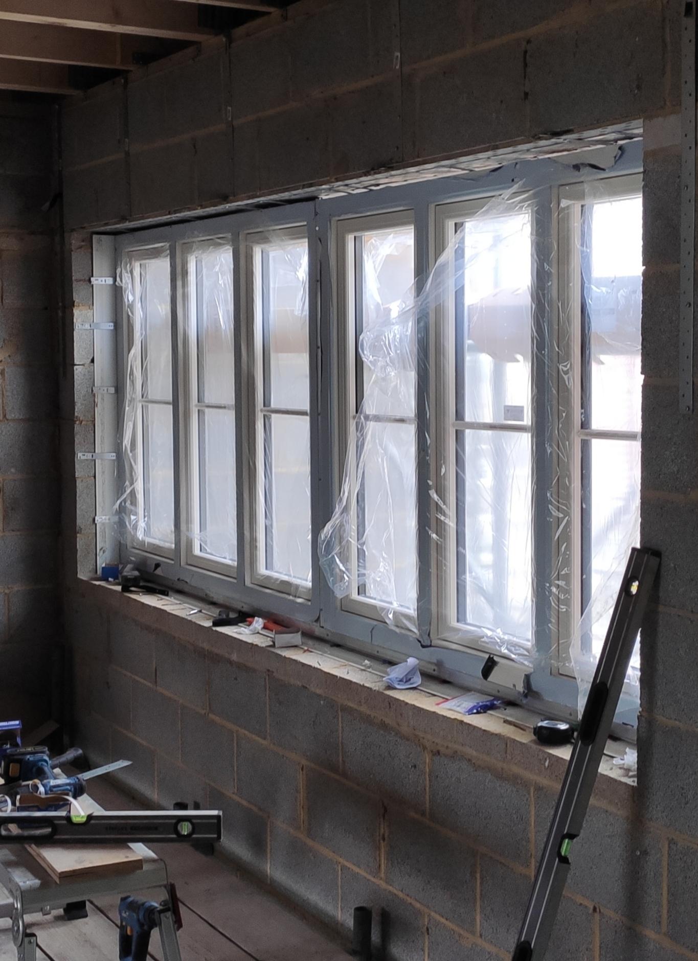

MortarThePoint Posted October 5, 2021 Author Posted October 5, 2021 (edited) Got it in. It was a squeeze as I had made a measurement mistake but it is in and looking good ? Edited October 5, 2021 by MortarThePoint 1
