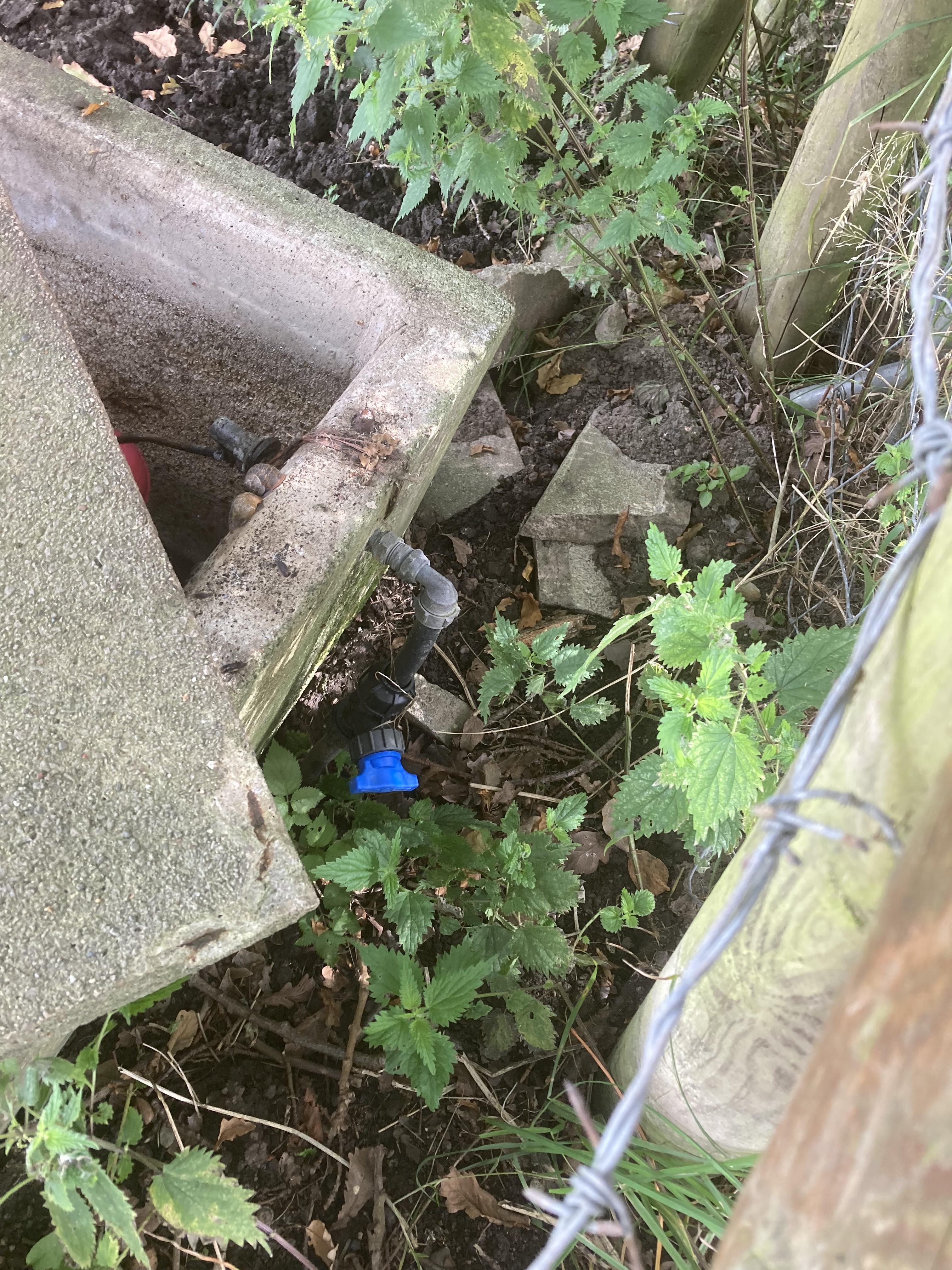

nod Posted August 30, 2021 Posted August 30, 2021 Does anyone know the size of fitting I’d need to get a tap on this pipe It’s a plastic pipe But not as thick as a standard blue 25 mil pipe
PeterW Posted August 30, 2021 Posted August 30, 2021 Could be 20mm MDPE which is fairly standard or it could be “old” 3/4” alkathene which comes up about 21-22mm These aren’t cheap but have got me out of an issue before. https://www.pipestock.com/mdpe/mdpe-pipe-fittings/universal-coupling 1
