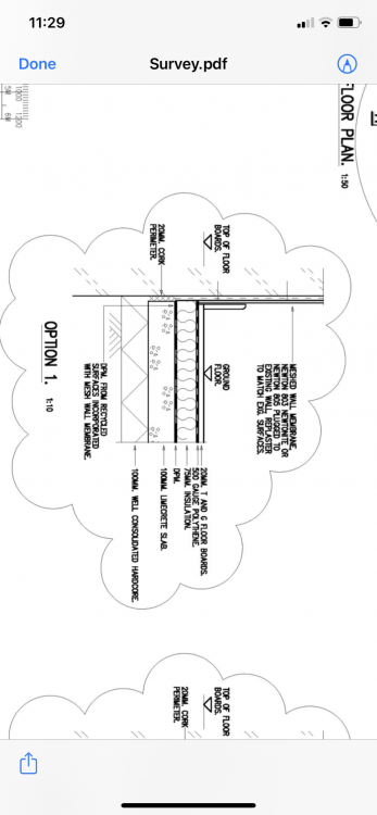

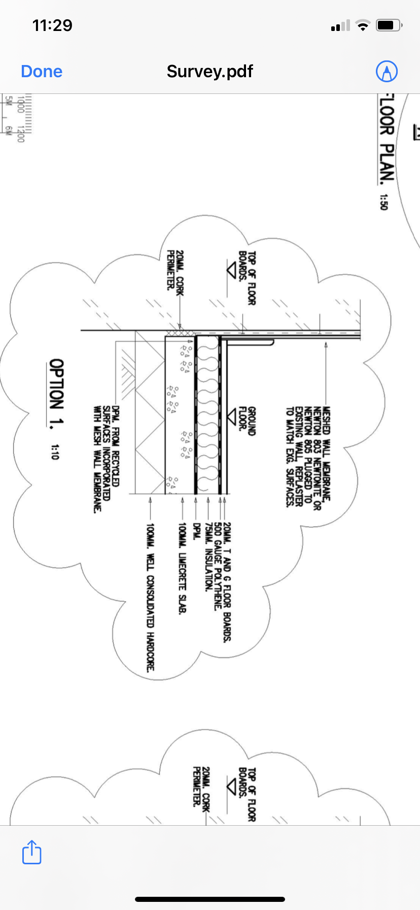

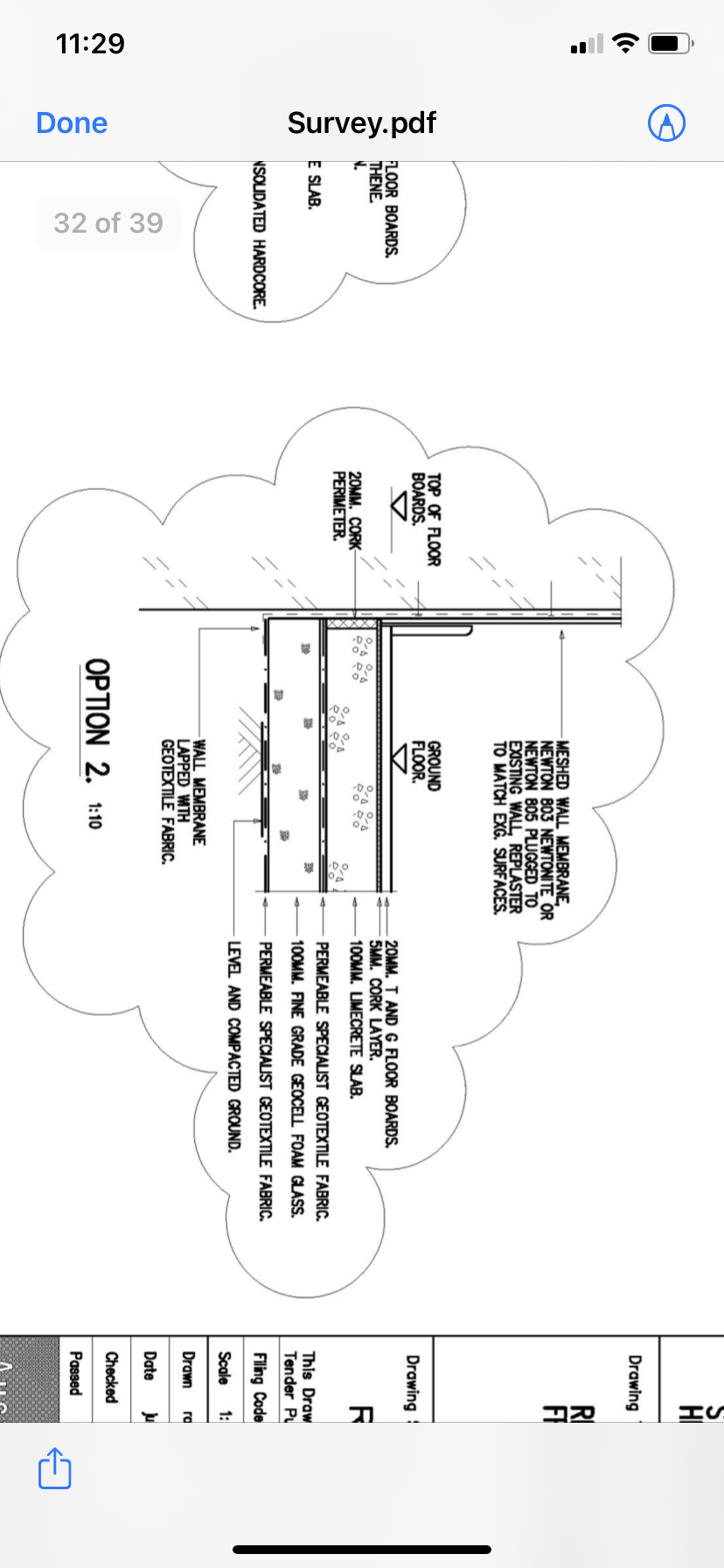

Bettie Posted August 18, 2021 Share Posted August 18, 2021 Hi, I have just bought a small listed 2 bed cottage. One of the rooms on the ground floor has had bad damp and the whole floor needs replacing. Apparently it’s been unlived in for 2 years. There are 2 options in the picture below, please can anyone tell me a rough cost to get either options carried out. I’m in Hertfordshire. I’m trying to do the budget for the renovation but this is one area I’m not sure on. Thank you ! Link to comment Share on other sites More sharing options...
PeterW Posted August 18, 2021 Share Posted August 18, 2021 Why do they want to use limecrete..? And why the Newton layer on the walls ..? Is that a retaining wall ..?? Damp needs ventilation or non-porous materials. If it is truly damp - and you want to retain a floorboard finish - then consider putting in a suspended floor with insulation between the joists and allow the underfloor to breathe with cross ventilation and air bricks. Link to comment Share on other sites More sharing options...
Bettie Posted August 18, 2021 Author Share Posted August 18, 2021 Thanks Peter, that sounds great. These are the suggestions from the surveyor 2 years ago. Instead of doing the suggested work the owner left the property empty and are now selling it. Would you know how much it would cost to put in a suspended floor with insulation between the joists and allow the underfloor to breathe with cross ventilation and air bricks in 11m2? Thank you. Link to comment Share on other sites More sharing options...

PeterW Posted August 18, 2021 Share Posted August 18, 2021 28 minutes ago, Bettie said: It also says the ground level is approximately 150mm above internal floor level. There are no air bricks. It says that the cement plinth and sunken pocket had been covered and/or filled resulting in significant rot to the ground floor timbers. Right, so first thing is to get digging outside if you can ..!! Get the soil away from the walls, get at least 150mm below internal floor level and then back fill that with coarse clean gravel. That will stop water coming through the wall. Joists can be replaced like for like but you need to sort the sleeper walls they sit on. It sounds like you would be better off replacing the floor with insulation and a concrete slab with a decent DPM lapped up the walls. Link to comment Share on other sites More sharing options...
