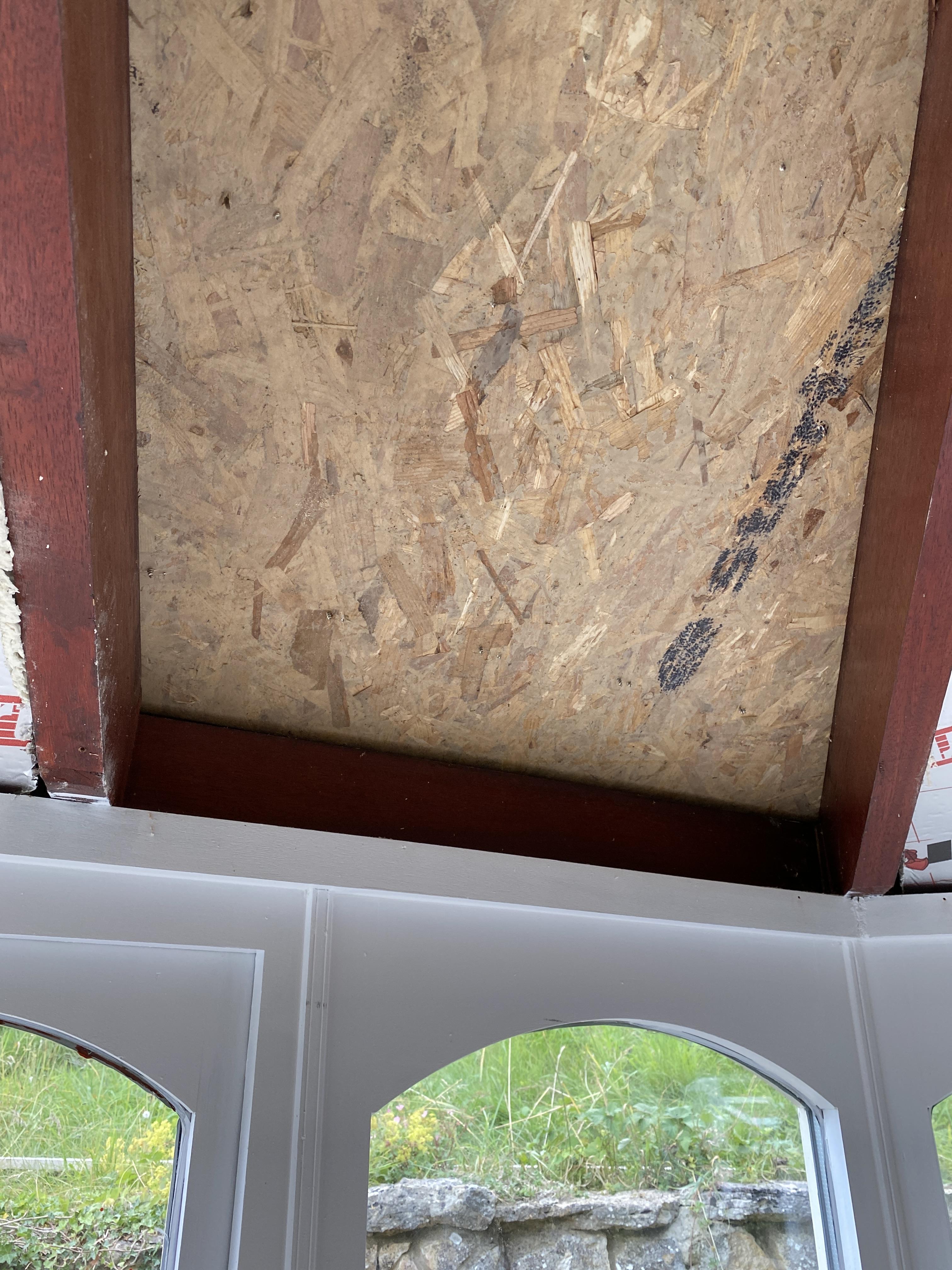

CotswoldDoItUpper Posted August 2, 2021 Posted August 2, 2021 So, new replacement roof on the conservatory. No ventilation gap between new roof osb boards and wall (there never was in the first place when it was a polycarbonate roof). Can I just stick my insulation to these boards or do I need a ventilation gap of about 50mm? thanks!
Mr Punter Posted August 2, 2021 Posted August 2, 2021 If there is a door between this and the rest of the house and you have no fixed heating you can do as you like. If you could have ventilation above the insulation, with a decent clear path it would be better. Cover the lot in polythene before you add the plasterboard.
CotswoldDoItUpper Posted August 2, 2021 Author Posted August 2, 2021 11 minutes ago, Mr Punter said: If there is a door between this and the rest of the house and you have no fixed heating you can do as you like. If you could have ventilation above the insulation, with a decent clear path it would be better. Cover the lot in polythene before you add the plasterboard. there is. It might accidentally fall off at some point though…. I was more asking about good practice. Do I need to allow air to circulate on the ‘cold’ side of the insulation? Trying to avoid internal damp/condensation. I will be filling the gaps with foam and foil taping over the lot. If I can stick the insulation to the boards I can get 100mm in otherwise I’m limited to 50 between and then 20mm over the internal joists to combat cold bridging….

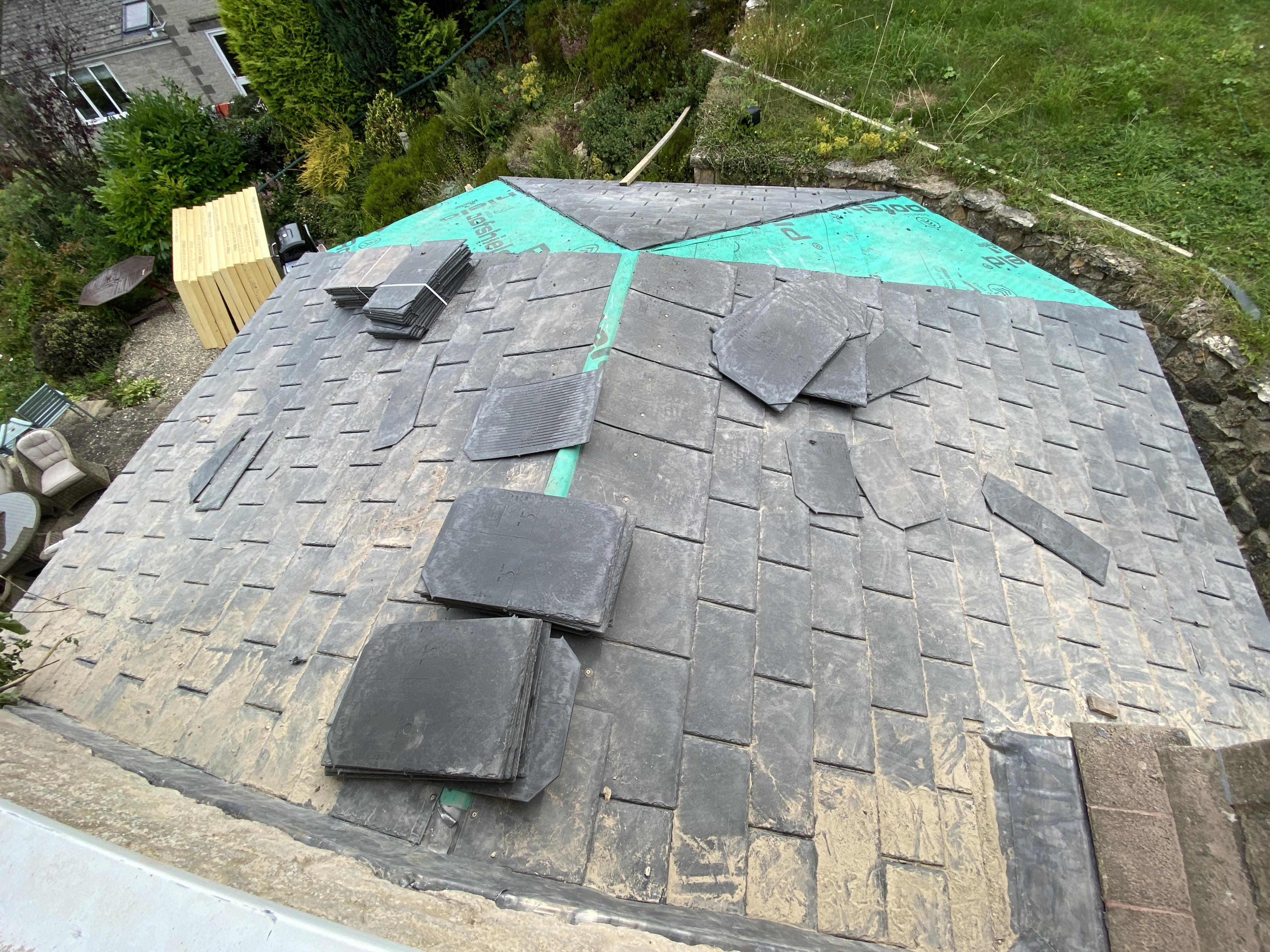

CotswoldDoItUpper Posted August 2, 2021 Author Posted August 2, 2021 Meant to add that the roof felt is breathable apparently….
Mr Punter Posted August 2, 2021 Posted August 2, 2021 Are there any battens or are the slates fixed through the felt into the OSB?
CotswoldDoItUpper Posted August 2, 2021 Author Posted August 2, 2021 Slates screwed through the felt into the osb, As per manufacturer instructions (14deg pitch).
