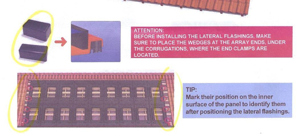

Conor Posted July 23, 2021 Share Posted July 23, 2021 (edited) As I inch further along.... Are the plastic wedges for the panel clamps only required at either end of the array or at all of the clamp positions? If it's the latter I've not got enough and these need to go on today! Edited July 23, 2021 by Conor Link to comment Share on other sites More sharing options...
dpmiller Posted July 23, 2021 Share Posted July 23, 2021 just the ends 1 Link to comment Share on other sites More sharing options...
