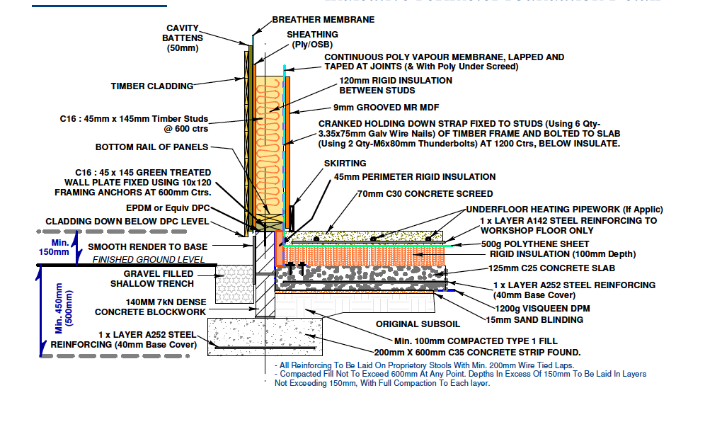

I am building a 9 x 4m workshop / garden room
I am trying to do it in accordance with building regs and permitted development - one of the regs is regarding fire resistance of buildings which are within 1m of boundary fence. I did speak to building control to talk things through and they seem happy for me to use a cement board (instead of OSB) on the outside as sheathing, thus making my build exempt from building control.
There appear to be three options:
1. Fermacell
2. Versapanel
3. Magply
I have heard stories about the weight and difficulty cutting these types of materials
Questions
1. Which is the most recommended product from those three options or are there others I have missed?
2. Am I mad? - most people (even garden room companies) are using OSB, even on builds which are tight on the boundary (<1m)
thanks
Martin
some pictures of the stud structure and the wall section: 172619507_wallsection-firerated2.thumb.jpg.47a80e91e5d44aab15854d6598d4ff1a.jpg

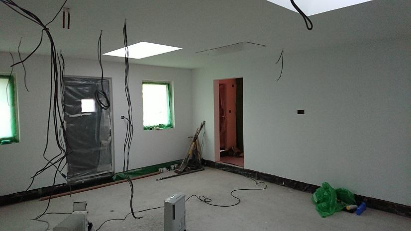

I used Fermacell basically instead of the plasterboard, or grooved MDF in attached drawing.. It's about twice the weight of plasterboard, not sure about the ease of cutting as I wasn't actually around when it was fitted, but nice and tough for any wall mounted items etc.

OSB for racking, breather paper, battens, cement based siding / cladding boards.

planning officer I spoke to said I need both the cladding and the sheathing to be non-combustible. feels a little like overkill to me but then what do I know

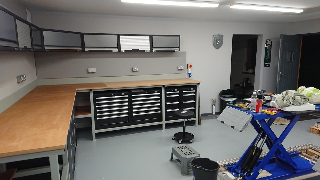

damn nice looking workshop Sandy!
