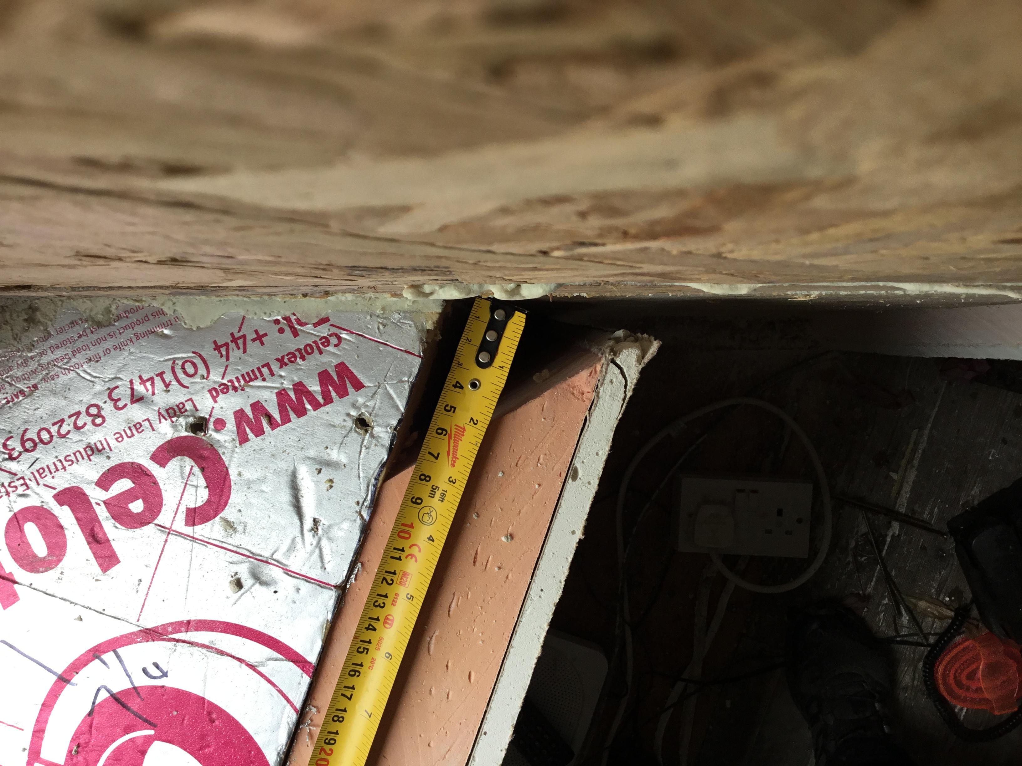

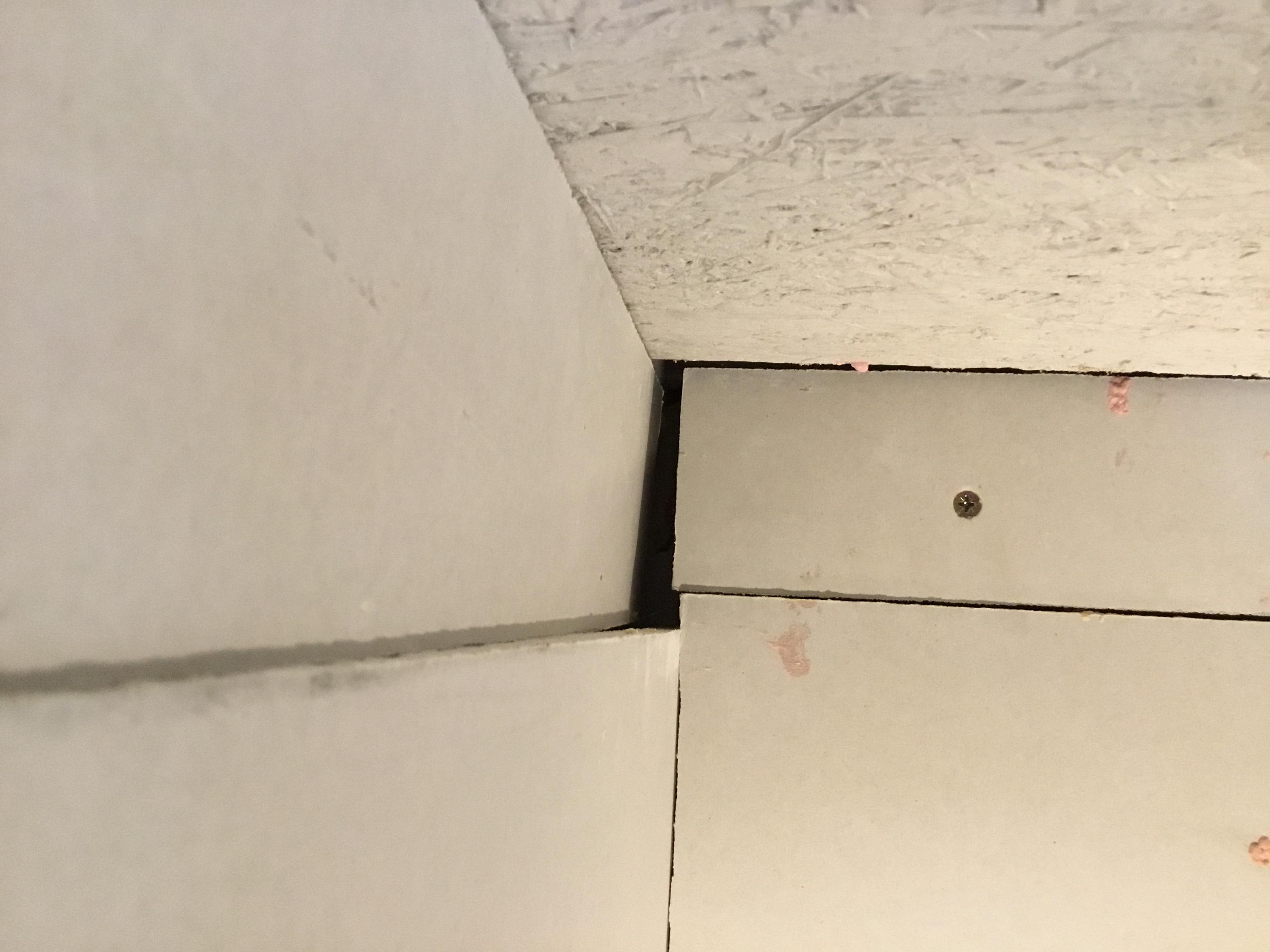

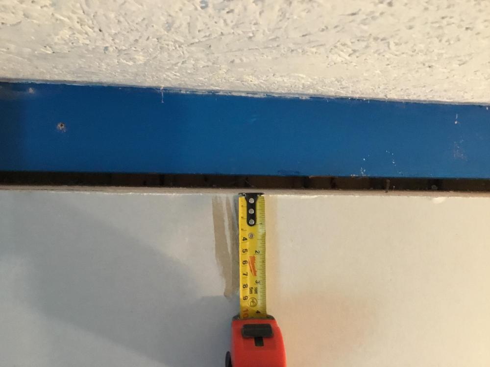

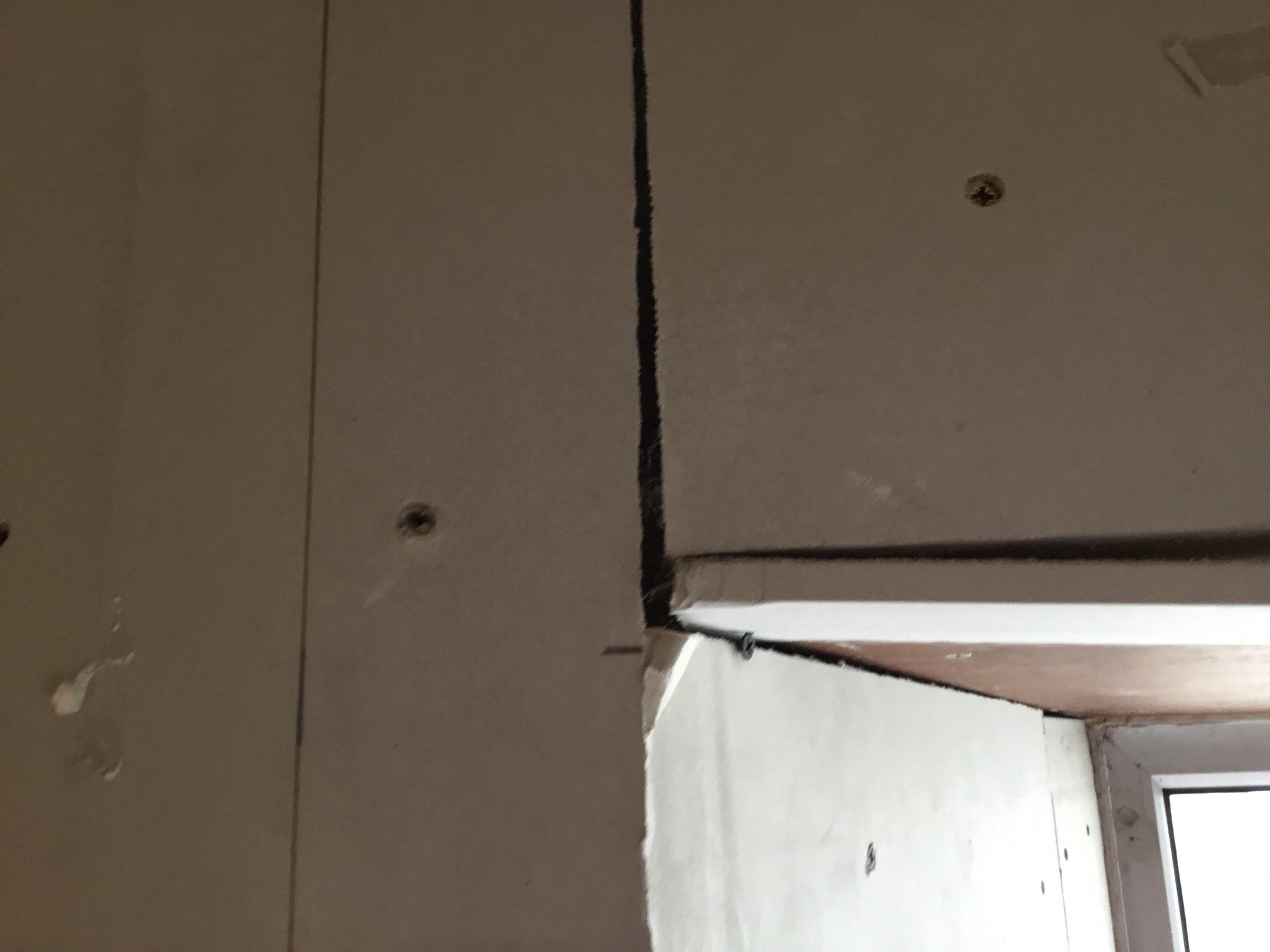

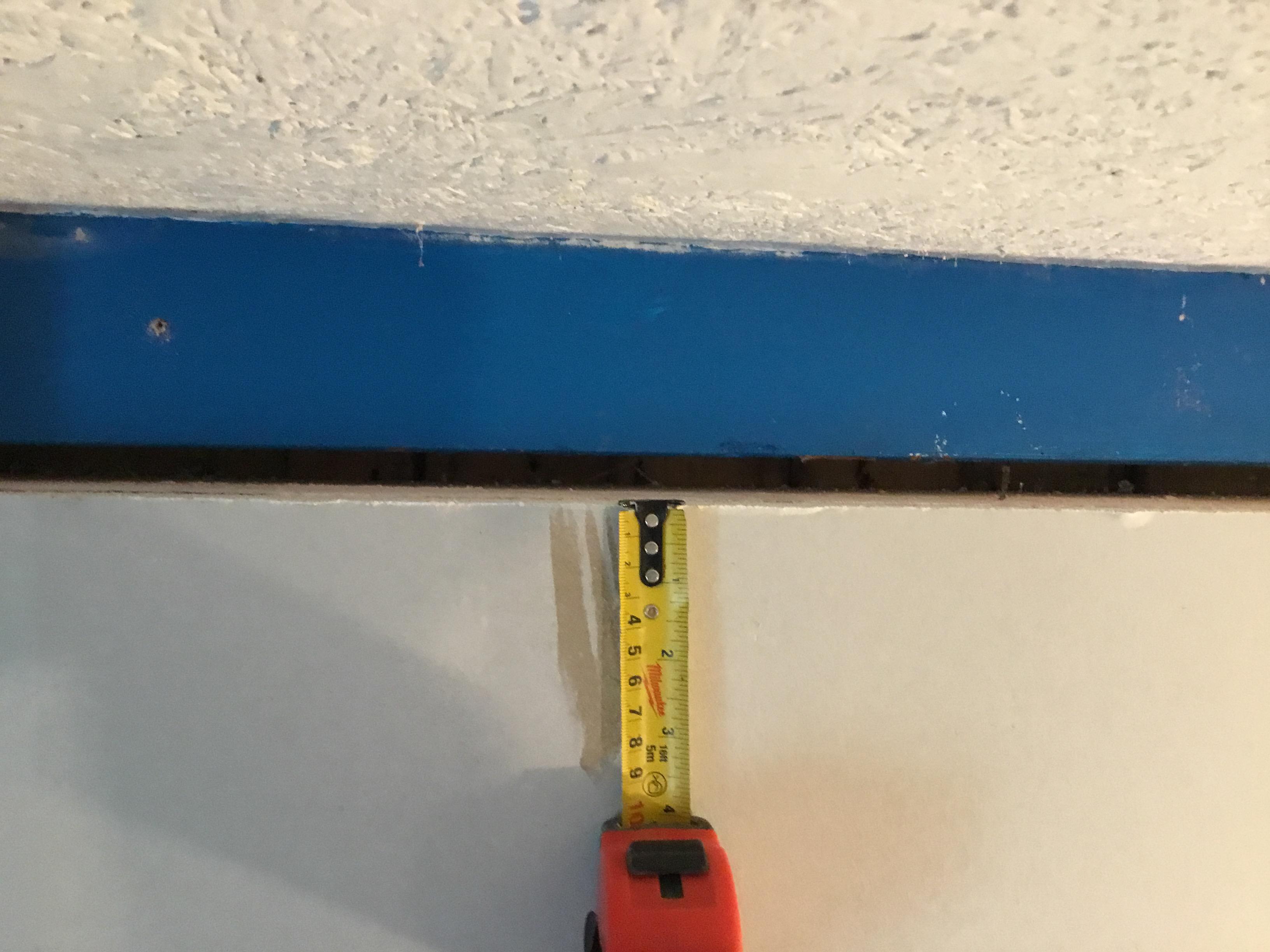

Not sure if this is relevant but my ex lives in one of my houses rent free and I applied for one of these government grants to do IWI under her name as she claims one of the relevant benefits,     It’s taken years…… to actually get a company out having applied 3 times with different companies. Every time they look at the job and mostly the remote location they find a technical reason why they will not do the work….. anyway yet another surveyor turned up and I told him that I wanted 70mm minimum rigid insulation + plaster board ( it comes as insulated plaster board they were reluctant but eventually agreed and the lads turned up and did four very short days and then left saying that plasterer would be along in a few weeks to skim the whole lot. The quality of the work undertaken was absolutely abysmal and It has taken me the last 3 weeks to rectify all the problems in anticipation of the plasterer arriving (luckily delayed ) had I not done all this work I expect the plasterer would have just bodged over all the massive voids and called it a good job. I know I had the right to complain but after seeing how bad the work was done I did not want the crew back…. The work was 100 % paid for by the government. The independent surveyor who just finds the jobs and sells them on said he was earning a fortune just lining jobs up, the crew  who did the work were only here for 4 short days, god knows how much the company gets from the government. All in all I am glad it’s done as I could not afford the materials to do it myself  but if they treat every job like my job then this sort of scheme is a joke and waste of tax payers money. ———Rant over———
just a couple of photos of standard details that were everywhere, many of the voids were up to 100mm wide with the  front gaps that you could see being 10-20mm they also forgot to do one whole wall, and used standard plaster board in the shower room….. (I have replaced it with the proper stuff….)
