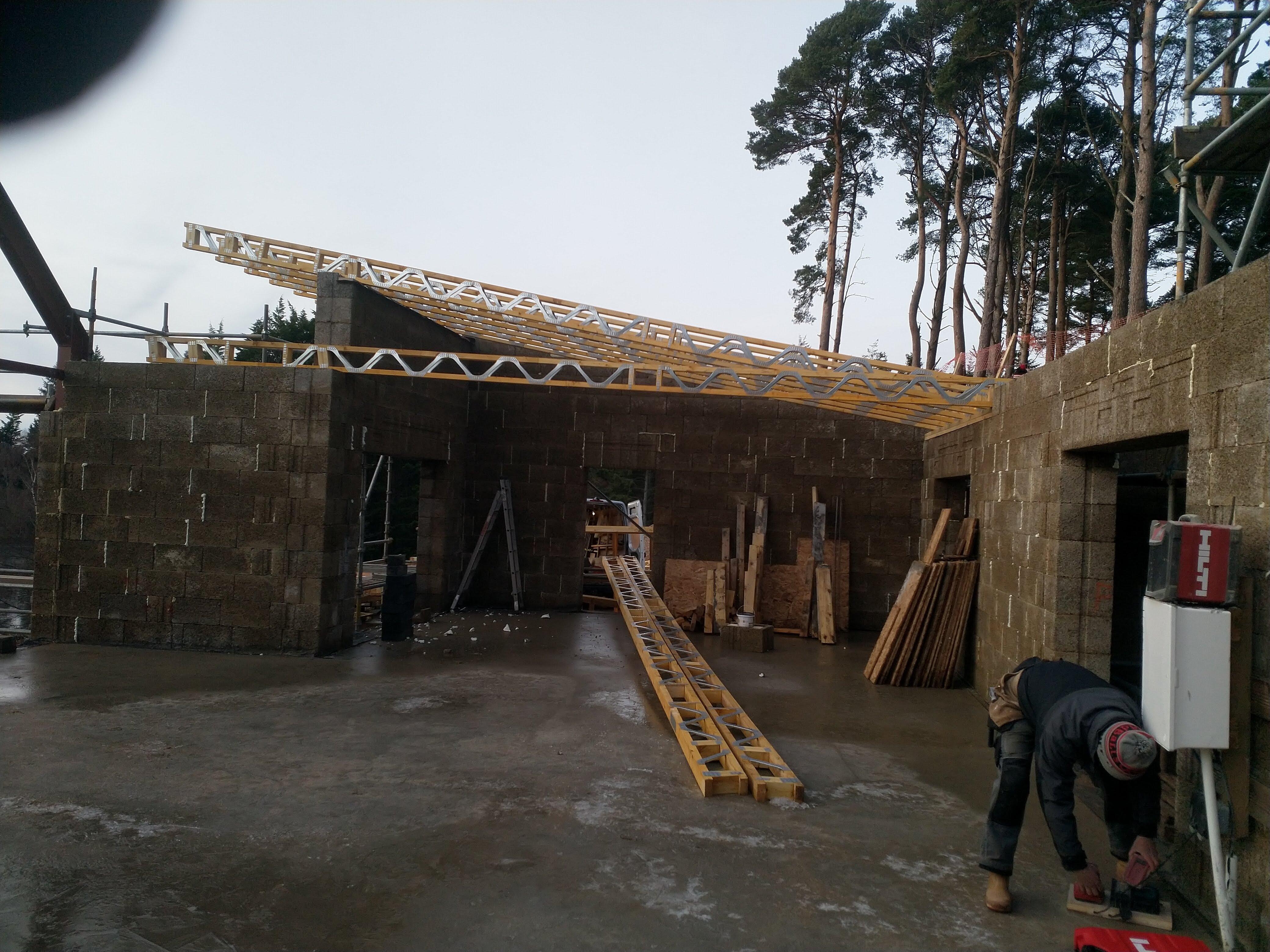

Chanmenie Posted July 6, 2021 Share Posted July 6, 2021 Has anyone used brick slips with Durisol or Isotex ICF blocks ? The blocks are 250mm high so how do you make the window openings brick course able, standard height window openings tend to be 1350mm high but of course this wont work with the 250mm blocks So would I have to go 1500mm high, then there's the same issue with the doors. Link to comment Share on other sites More sharing options...
JohnMo Posted October 19, 2021 Share Posted October 19, 2021 Reply may be a little late, but could help others. Are you trying to design around the slip or the durisol? When you are doing the lintels with durisol the blocks are on the end, so 500mm high and 250mm wide. The blocks either side of the window/door opening are modified to take the rebar. The window or door heights can be easily made to suit the slips, with too much additional work. The door opening, by the white box is 2100mm high, the open under the flattish roof, lined up with the blocks at 2000mm, both opening require blocks to be modified. Link to comment Share on other sites More sharing options...
