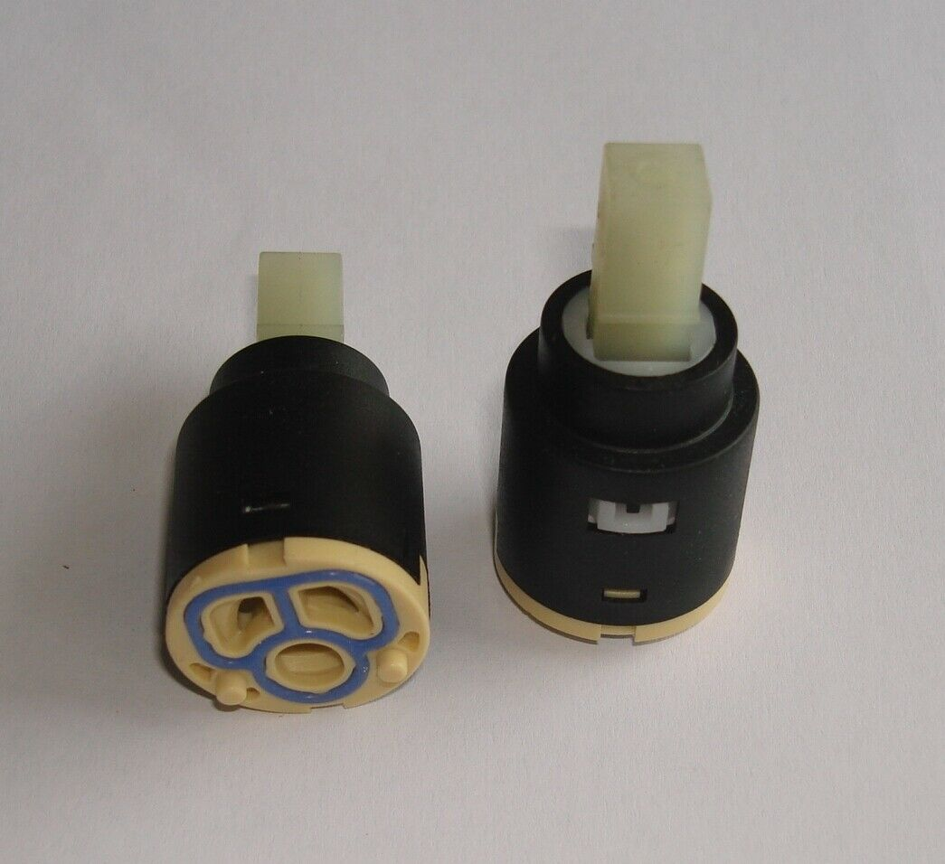

That's a very useful listing with a lot of dimensions and mine matches those pretty well. The issue appears to be how the cartridge locates into the tap body.  This image shows it well
It seems the standard 25mm mixer cartridges locate into the tap body by having two outward "pips" on the bottom that presumably locate into two holes in the tap body.  Mine does not have those.  Instead mine locates to the tap body by two notches on the outer edge of the body.  That picture has 2 notches also but top and bottom, the notches on mine are 90 degrees to that.  So that one is not going to work.

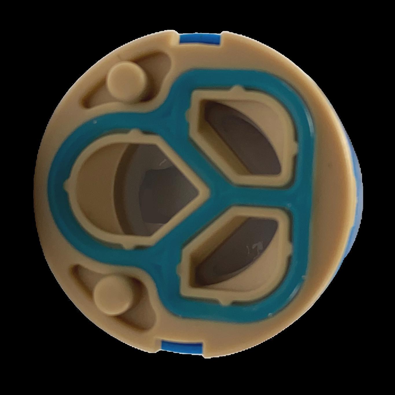

I have found one that is close, this one. https://www.ebay.co.uk/itm/265077498057?hash=item3db7d9a0c9:g:vUcAAOSw4tNgQhu1
That still has the two locating "pips" but also has the notches on the outer edge in the place I need them.
imageproxy.php?img=&key=f5f06bfe2c42e69cimageproxy.php?img=&key=f5f06bfe2c42e69cI guess I could carefully cut off the unwanted pips and let it locate into the tap body with the two notches.  The "problem" with this one is the main body of the valve is about 2mm shorter than mine.  I guess I can insert some form of spacer if that proves to be an issue.

I bought the second one in my first post.  As expected, I had to cut off the two "pips" on the bottom and it located using the two side notches for location.  (bodge #1)
As expected the body of this one is 2mm shorter than my original, and the locating ring would not clamp it down.  I had to make a spacer washer. I found a large 2mm thick rubber washer and cut my spacer from that.  (bodge #2)
