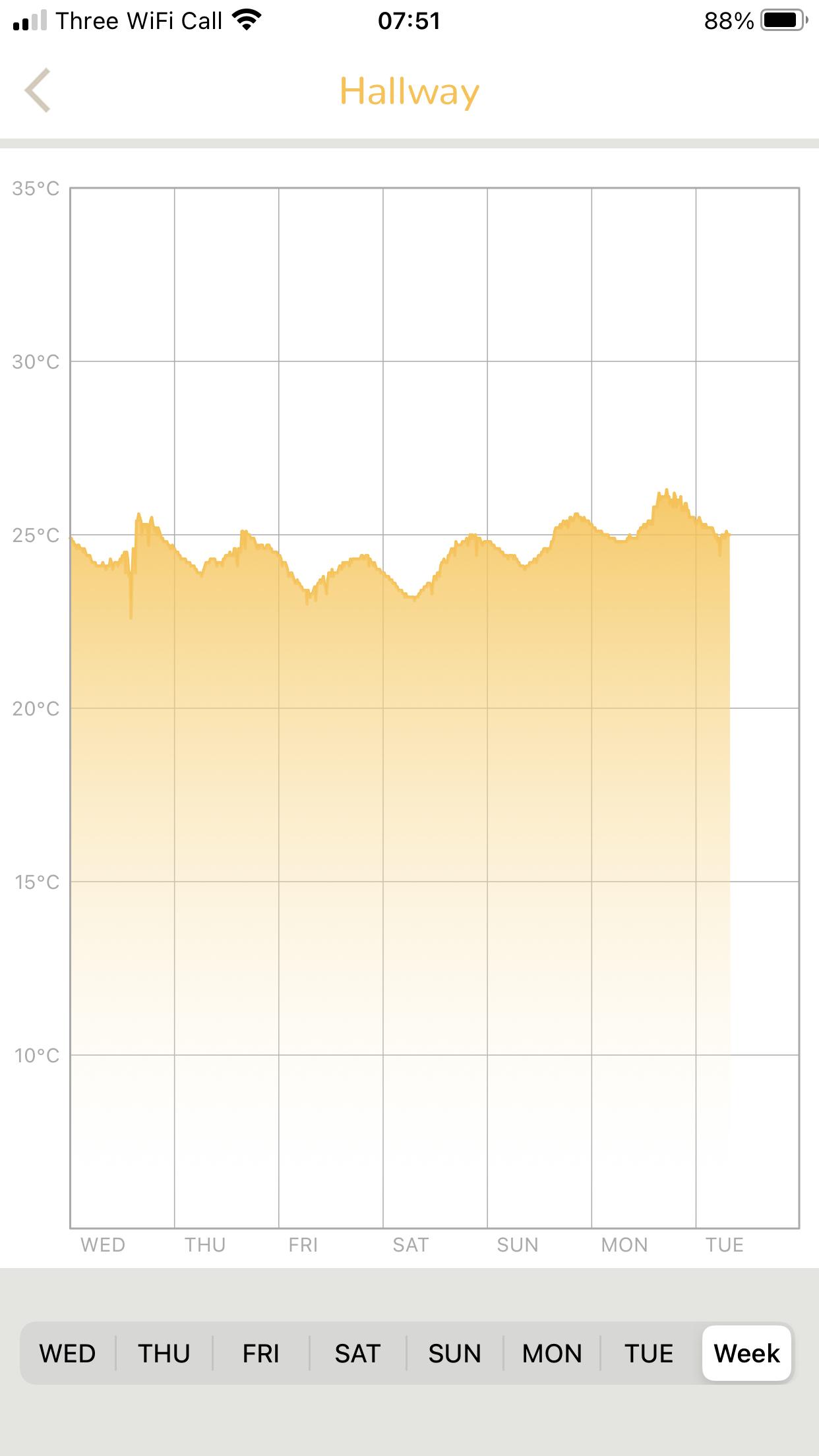

I hadn't been and checked the manifold so early in the day before, it seems like it was coming on during the night even though it wasn't supposed to.
Didn't matter when it was cold.
From this, it looks like it has been turning itself on at 6am every morning. The hall has been getting warmer and warmer. It is hard to tell though as this is also when the sun comes out, so the whole house gets warmer. The hall does face north though.
