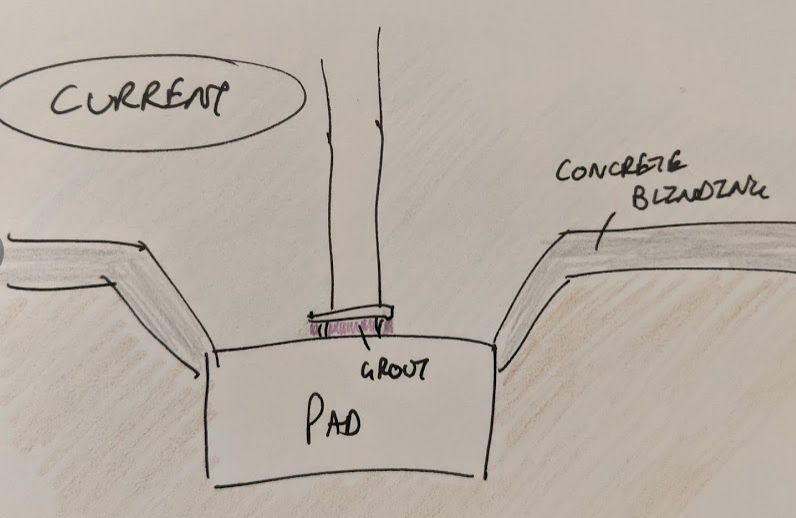

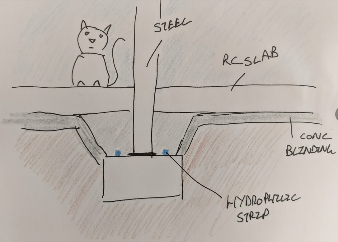

kxi Posted May 30, 2021 Posted May 30, 2021 Our SE specified columns down to the pad foundations, and it's good to hear this is a standard approach, as I was apprehensive. Was spec'd initially with a fairly slimline concrete encasement, then liquid damp proof membrane painted over that to keep the dampness out: (The new column is the left one, the right one is an old wall with foundation. Column encasement is isolated from the floor slab). However, with my paranoia about steel corrosion and discussion with groundworkers we're now all agreed to instead have: A much thicker encasement - basically just filling up the holes above the pads with concrete A hydrophilic strip around the column base - to block any water potentially moving along the joint between pad concrete and fresher encasement concrete (pads were poured some months ago, encasement not done yet, and the columns now constantly sat in water) Floor slab cast right up to the steel - with isolation wrapped around the steel I.e. (Cat not to scale) Now I look at this I see a potential dampness pathway to the steel along the underside of the slab. Any comment from those in the know about the pros and cons of each option? Column bolts were a mix of cast-in and post-fix resin, to which the steel frame erectors said cast-in was much preferable. 1

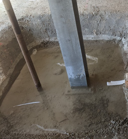

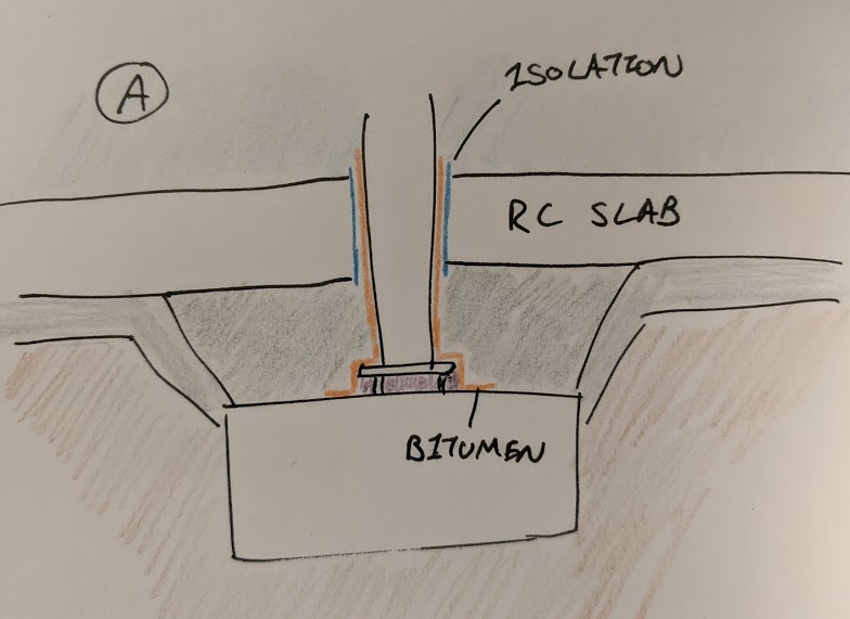

kxi Posted May 31, 2021 Posted May 31, 2021 On 30/05/2021 at 09:52, saveasteading said: Re the recent drawings by kxi above. I would always paint the steel in bitumen up to slab level including the underside of the base plate, where the welds may be the weakest part, and some gaps under the plate. Why not? 10 minutes work. The column either has to be on the absolutely exact level of footing or else design to allow 25mm shimming then dry-packing (that also facilitates adjusting the column to vertical) Waterproofing around the column, you just do the best you can by cutting lapping and sticking dpm. If the concrete is dense enough there won't be any significant water absorption anyway, or problem. I can't see that you need to get complex with hydrophilic strips. Expand Thanks. Current state is columns shimmed & grouted (and sat in water for days every time it rains) so missed the chance to paint under the baseplate: So ditching the hydrophilic strips and sticking with just bitumen, what are your thoughts on A vs B? A - Bitumen paint the column to top of slab (as per your usual), fill the pit with concrete, then lay slab right up to the column - with isolation joint taped to steel: B - Encase base of column up to top of slab in concrete, then bitumen paint the outside of encasement, and isolation joint on the outside where it meets the slab: I was assuming A is less work since you don't need the formwork for each column encasement, but which is likely to have more longevity? B keeps dampness further away from the column? Some discussion of this in https://www.structuremag.org/wp-content/uploads/2014/09/C-SD-ABetterBasep13-151.pdf which illustrates an A-like one as a solution, but doesn't discuss a B-like one. (The cat is more likely to be a rat these days as the pack of 21 cats long since extinct due to inbreeding).
saveasteading Posted May 31, 2021 Posted May 31, 2021 The trouble with the first one is that concrete goes into the recess of the H shape. If you can isolate it neatly and get a float in then it should be ok. It may need thicker isolation to allow shrinkage without causing cracking.

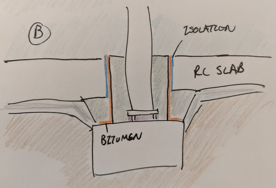

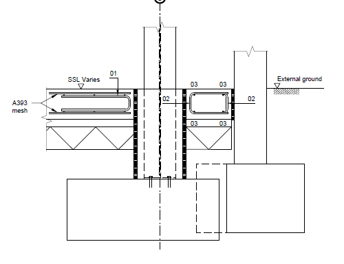

George Posted June 1, 2021 Posted June 1, 2021 On 30/05/2021 at 21:40, saveasteading said: Tie bars from plinth to mass base. The bigger the load the bigger and deeper the bars. Moderate accuracy required to get them in the zone of a shutter, but much less accuracy and difficulty than for putting the bolts in perfectly with a mass pour. We took to building the shutter with permanent blockwork. For a big base, these are L bars down to near bottom. All Civil Engineers have to experience both site and office, but tend not to hands on help with concrete pours in nasty weather. I introduced this method when I had to reset bolts in such circumstances.....and thought there must be a better way. On paper the plinths cost more. In practice their perfection has greater value in my opinion. Expand I'm still not convinced and I wouldn't like to rely on vertical tie bars to transfer shear. I have specified plinths when other factors drive it, but by and large I prefer to get a direct load path to the footing. I've pulled 120 year old steels out of footings and, although heavily corroded at ground level, they're absolutely spotless where encased in concrete - and this was agricultural sheds so exposed to the outside. The combination of no oxygen, alkaline environment and being within the building envelope should mean risk of corrosion is minimal. I should hope no-one is attempting concrete pours in poor weather! Especially when HD bolts are being set. @kxi B - is the more normal detail.
kxi Posted June 1, 2021 Posted June 1, 2021 (edited) On 01/06/2021 at 08:45, George said: @kxi B - is the more normal detail. Expand Thanks. Given you mention corrosion above ground, is it worth bringing the encasement in B up a bit proud of the slab, say 100mm (where practical) to bring it out of a zone where a) damp dirt might collect against the column or b) occasional floor washing might splash on it? In terms of the thickness of the encasement on B - presumably it should be at least ....50mm...thicker than the baseplate width? So end up even thicker round the column. Edited June 1, 2021 by kxi
George Posted June 1, 2021 Posted June 1, 2021 Before I answer that, a few clarifying questions... Is this all within the building envelope? Is anything going on top like a screed? Is the steel galvanised? Are you boxing in the columns? I would still paint the steel with bitumen if you have access. Usual detail is to encase with min. 100mm concrete surround and ensure it is well compacted between the flanges.
kxi Posted June 1, 2021 Posted June 1, 2021 On 01/06/2021 at 09:01, George said: Is this all within the building envelope? Mostly yes - apart from two external columns that will be fully concrete encased top to bottom (with reinforcement) Is anything going on top like a screed? Mostly no, but some has a 'normal' floor on top with DPM, insulation, finished floor Is the steel galvanised? Yes, though some small knocks Are you boxing in the columns? A few, but mostly not Expand Reason for variation is the building has multiple parts with differing usage. Though none with an aggressive environment. So you would paint the steel with bitumen even in B? AND the encasement in bitumen as well or just the steel? Reason for caution is I'm paranoid about any steel corrosion and building aiming for 150+ year lifespan.
George Posted June 1, 2021 Posted June 1, 2021 (edited) Anywhere with a floor going on top I'd finish the encasement flush. If this is going to form the FFL, then you could slope it slightly to allow water to run off. Paint bitumen on the steel and run it up to DPM level. It is smelly so don't go too far up. I'm not sure you need to paint the concrete - @saveasteading - what do you think? Galvanising is great protection. If it has damage then galvafroid can help repair it. But it is quite resistant to damage anyway as the zinc provides protection if it's within the same electrolyte. 150 years is ambitious... no building will last that long (no because things corrode, but because nature takes over) without maintenance so it's out of your hands I'm afraid. Build it as well as you can so it'll see you out. That's all we can do! Edited June 1, 2021 by George
