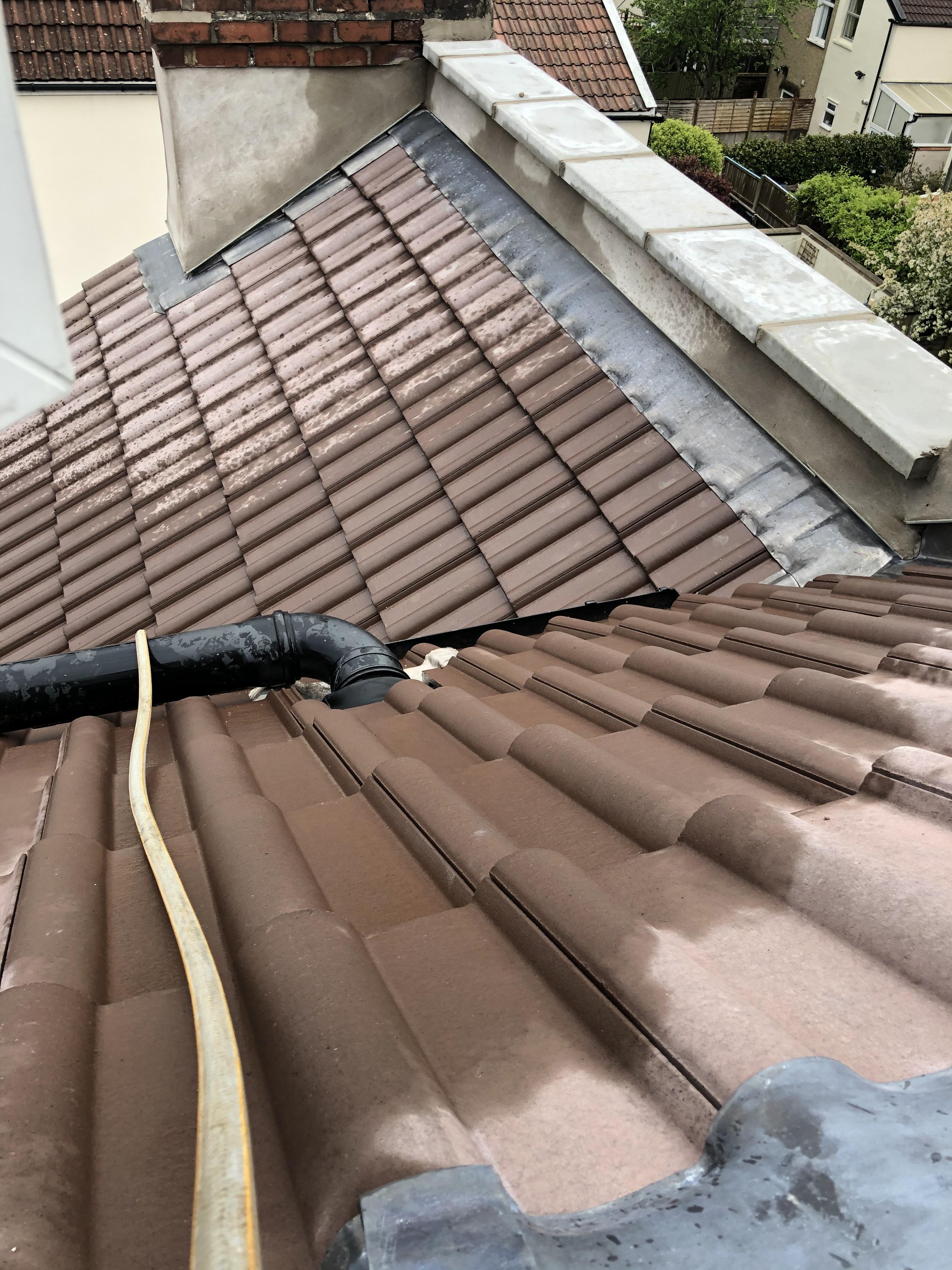

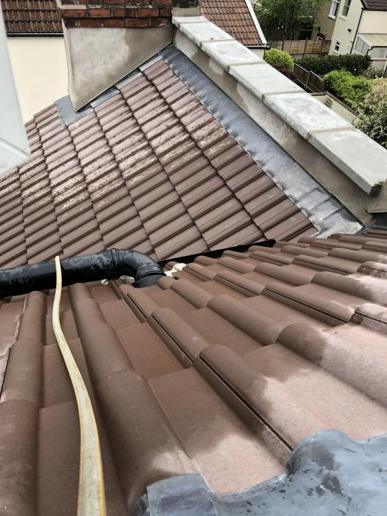

Poo in gutter
Tenant sends me this ....
I’m wtf ! . He’s on the 1st floor ! ? going up the pipe defies laws of physics .
I call emergency plumber to attend ( ££££ )
As I drive there I think - there’s a loft wc - but what could of happened!
Roofer took the waste pipe off and didn’t fix it back on properly ( though he claims he never removed the pipe so magically tiled under it ) .
Plumber uses solvent weld to ‘ fix ‘ it - which even I know won’t hold it .
? everywhere !
Plumber coming back next week as we need a clip of some sort to hold that bend in - but it means fixing to the tiles somehow .
Enjoyed today
Though you can see what a top job the roofer did ! . Shame he didn’t mention the poo pipe . Luckily scaffolding still up as rear chimney stack is well f’d
What a terrible detail that is could in not be routed inside
Slide a tile up and put a strap from batten down and round poo pipe to hold it in place. ?
It couldn’t . The council forced me to add it years ago ( hmo ) the plumber at the time saw this as the only viable option . Too be fair - it’s been fine for 10 years until roofer removed it ...
That’s a good plan
