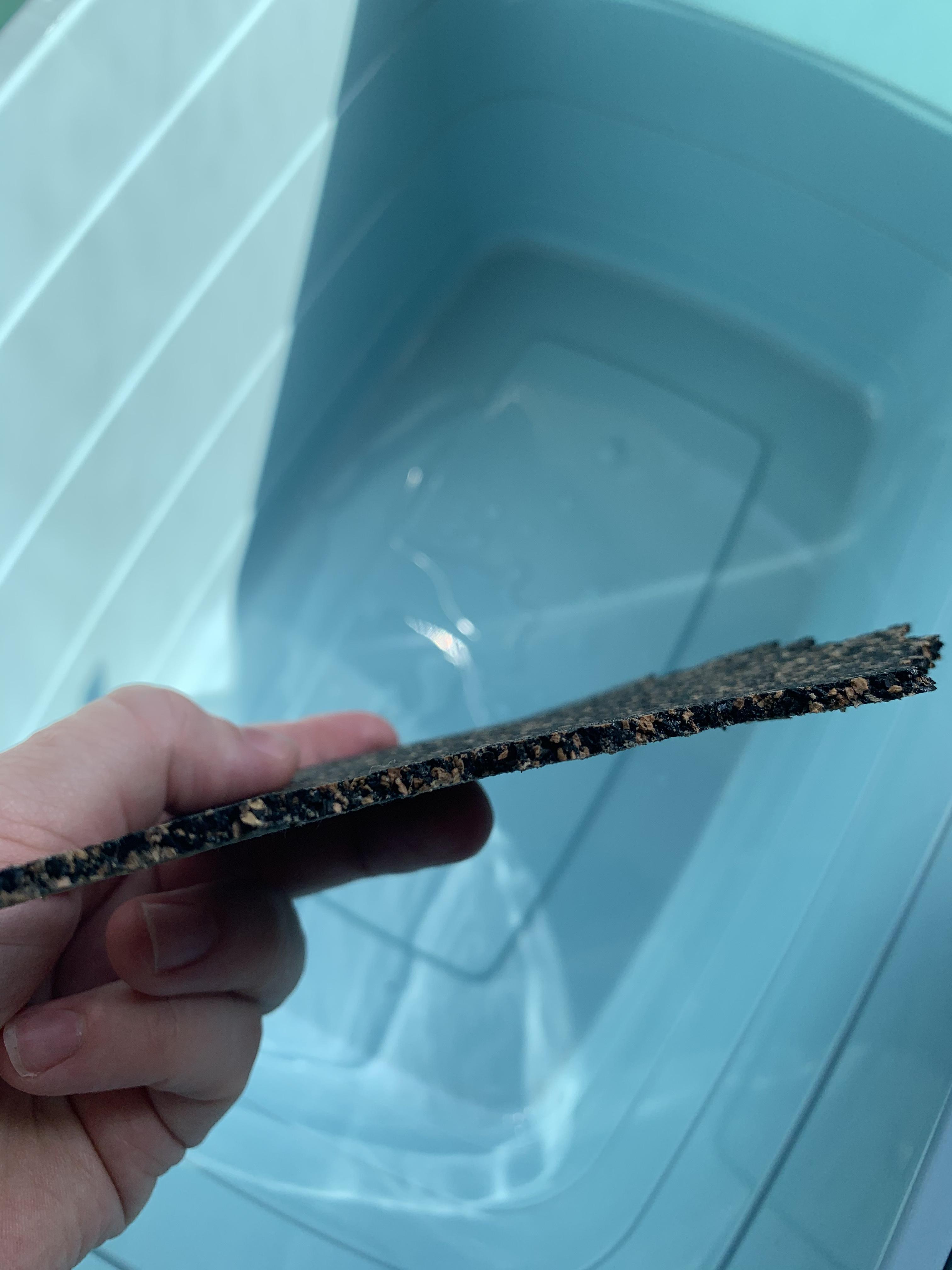

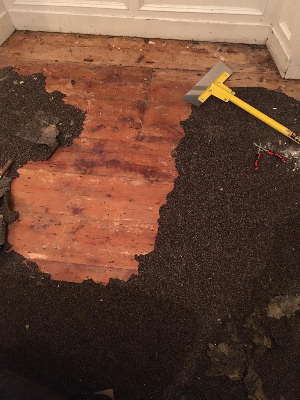

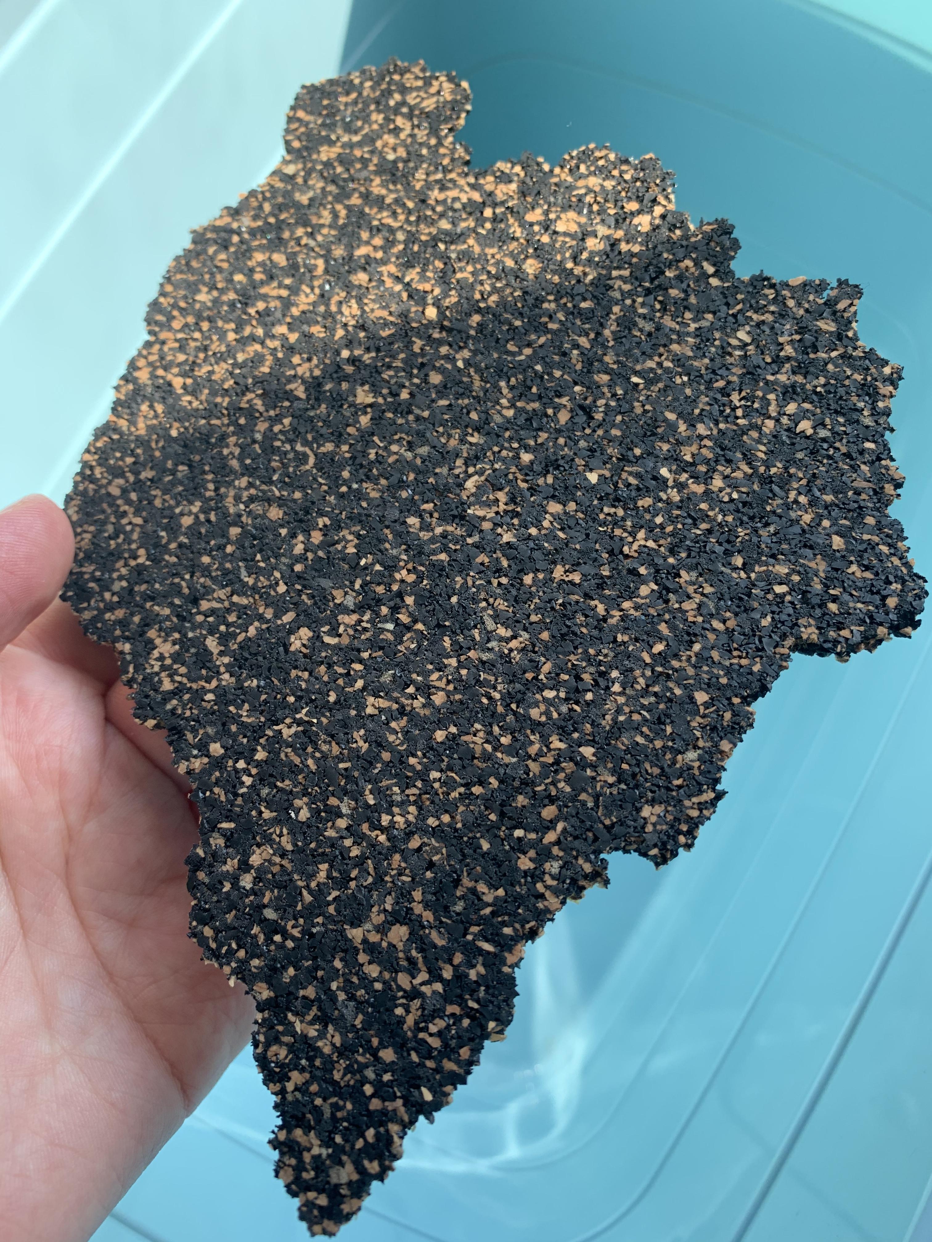

Nico9891 Posted April 21, 2021 Share Posted April 21, 2021 Hi all, currently renovating a victorian house that needs a lot of work. Underneath the carpet, there was underlay and beneath that another form of acoustic underlay- possibly Regupol?- cork/rubber material, that has been glued to the original timber floorboards. Any advice on how to remove it, short of picking it up inch by inch with our fingers?! We have tried metal and plastic scrapers, white spirits, heat guns etc and it’s not budging. Keen to avoid any major damage to the original wood beneath. Any advice greatly appreciated! Link to comment Share on other sites More sharing options...

Nico9891 Posted April 22, 2021 Author Share Posted April 22, 2021 Thanks for that. Yes, after around an hour’s work with the long handled stripper I only managed around 0.5m2 and it’s very tough on the hands! Will try to get one of those from HSS this weekend Link to comment Share on other sites More sharing options...

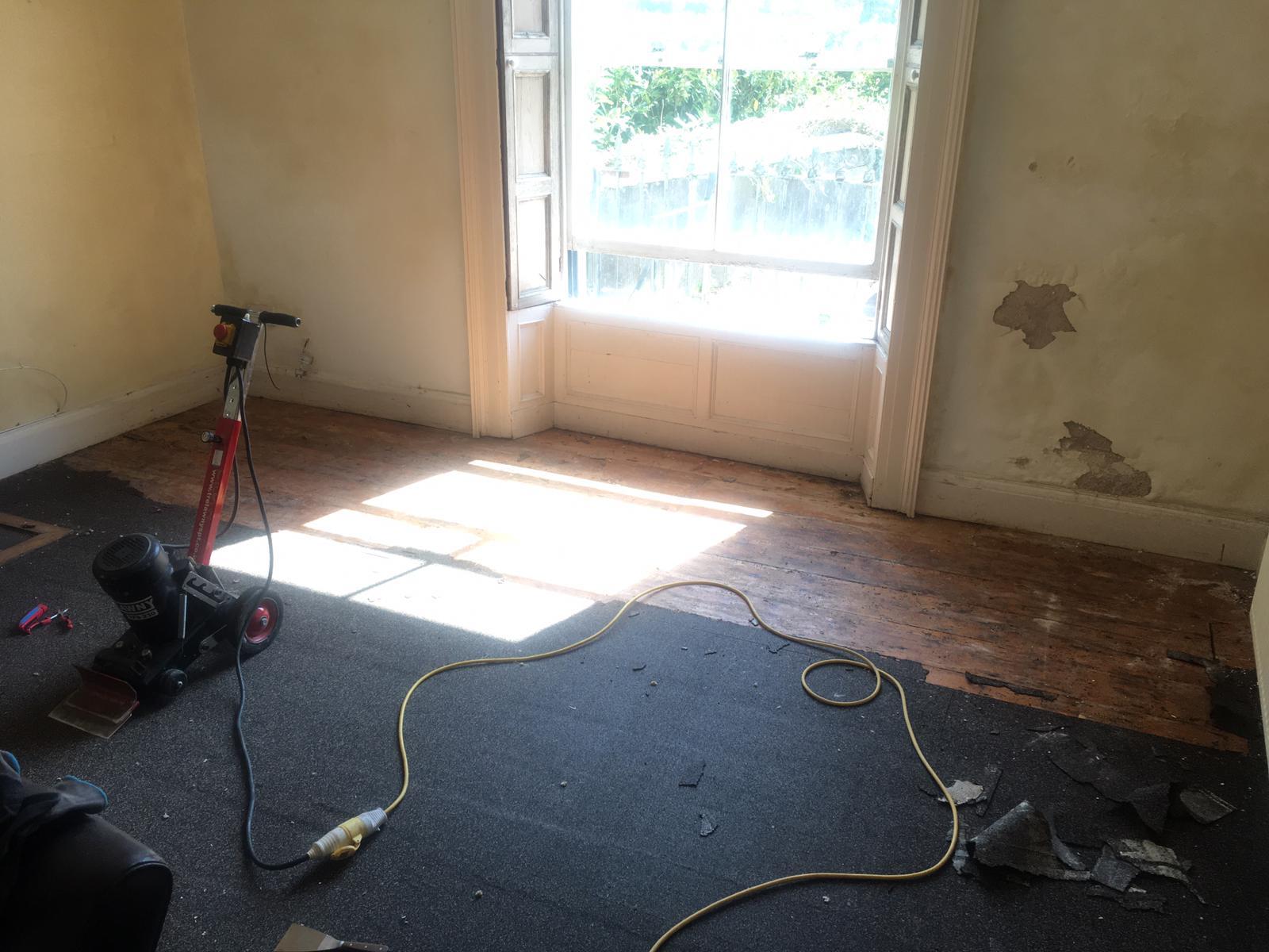

Nico9891 Posted April 24, 2021 Author Share Posted April 24, 2021 Just an update- we rented that and it’s working great! Thanks for your advice. Link to comment Share on other sites More sharing options...
