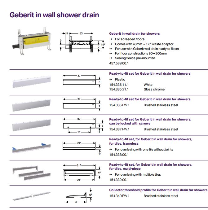

Onoff Posted February 21, 2017 Share Posted February 21, 2017 So I'm planning this Geberit wall drain: Actually the shorter version, their 457.538.00.1 shown below. Towards the end of the above video they show simply putting on the "ready to fit set" which I assume is either the 154.335, 336 or 337 below. I'm at a loss then what the 154.338, 339 or 340 is for. Any ideas? Unless I'm missing something the video doesn't show these? Link to comment Share on other sites More sharing options...
PeterW Posted February 21, 2017 Share Posted February 21, 2017 338 and 339 are for tiling on to so you can fit flush to the wall. 340 is a threshold strip to stop water running out of the shower area. 1 Link to comment Share on other sites More sharing options...
Onoff Posted February 21, 2017 Author Share Posted February 21, 2017 40 minutes ago, PeterW said: 338 and 339 are for tiling on to so you can fit flush to the wall. 340 is a threshold strip to stop water running out of the shower area. Cheers. So if not fussed I put a 335, 6 or 7 on and it sits proud of the tiles? Link to comment Share on other sites More sharing options...
PeterW Posted February 21, 2017 Share Posted February 21, 2017 1 hour ago, Onoff said: Cheers. So if not fussed I put a 335, 6 or 7 on and it sits proud of the tiles? Yep that's the one Link to comment Share on other sites More sharing options...
PeterW Posted February 21, 2017 Share Posted February 21, 2017 Actually looking at it i think it fits nearly flush ... Link to comment Share on other sites More sharing options...
