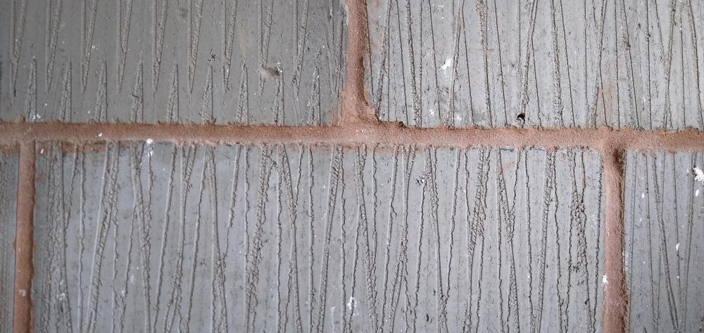

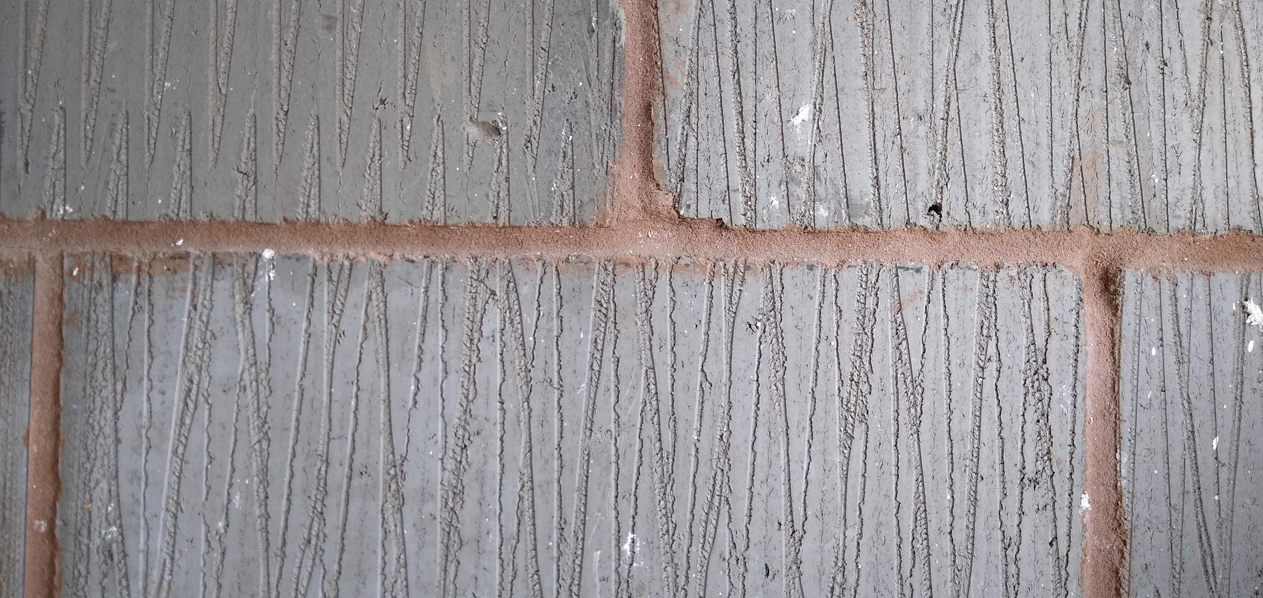

Anyone know what type of block these may be?
Thank you for the reply.
Is that answer without doubt.? ...Sorry, I have no idea whatsoever myself.
Would you know what loading capacity these can accept Peter.?
Checking them, it states 3.6n. Is this correct
Sorry for being lazy asking the question above.
Depends which one it is - would guess it’s a 3.6N. Any visible paint on any of them ..?
Where is the wall..? Which storey..?
I assumed they're 3.6, but wouldn't know.
Ground floor, and no paint visible no.
I ask because I am looking to have a kitchen extension done and these appear to be what the internal skin is made from. With that in mind, I wondered what bearing they'd have, because an SE that calculated for the steels to go into the rear wall of the house (which will be partly removed, with a span of 4.5 metres) hasn't offered any information on how the steel is to be installed. No padstone info, no goal post arrangement info, or whether the steels are bolted together. Simply calculations for two steels.
