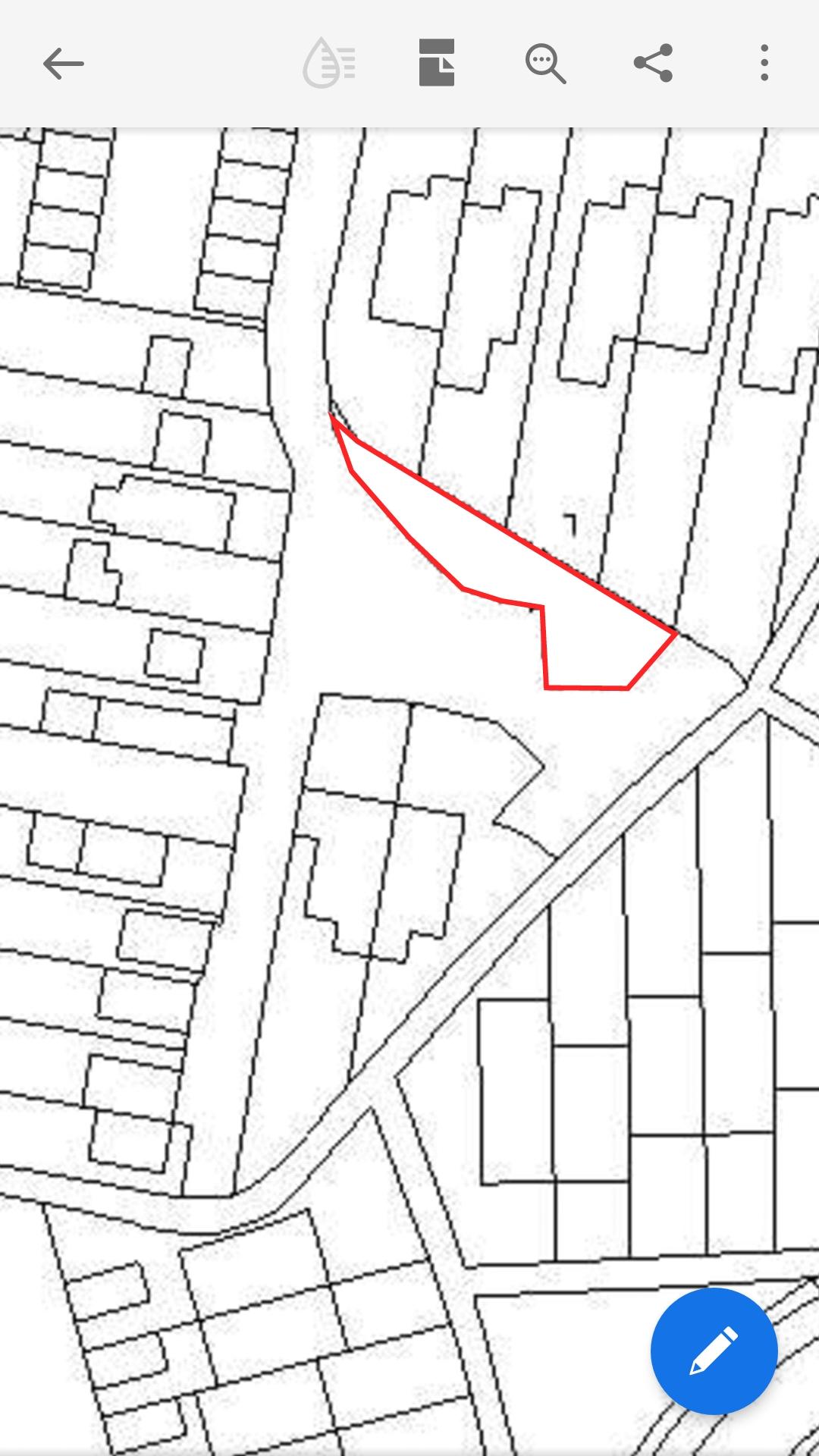

7 hours ago, Rob99 said:
Is the grey shaded area part of your site?
If so, why can't the house be located more centrally and away from the boundary.
Basically it's not his site, the location plan is below. Seeing this i can understand why the committee came to the over development conclusion, though I am surprised the planners actually supported it.
It's a super compact site and not well orinated to other properties. I really struggle to see how any house would get permitted there, then again I am not a planner.
1580560343_Screenshot_20210326-053121_AdobeAcrobat.thumb.jpg.ade1121b846a318b2dc14aa198622929.jpg

The size of the houses,garden and of road parking is the size of the plot.
Im hoping a daylight/ sunshine survey that shows the impact of shadowing to the neighbors is minimal thus addressing the reason mentioned in the refusal statement even though it says due to scale,dominance and overdevelopment.
If the loss of amenity is disproven aa mentioned above then maybe there's a chance at appeal.
