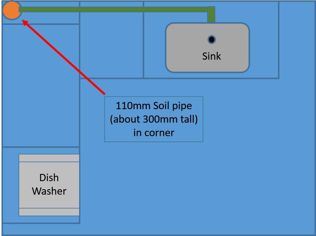

wozza Posted March 20, 2021 Posted March 20, 2021 Hi All, Looking for some advice on how you would tackle this: Normally the dishwasher waste connects into the sink trap via a little spigot connection but my kitchen layout has the dishwasher set in a unit perpendicular to the sink and a bit of a distance away. I have a 110mm soil pipe in the corner, so the sink waste can exit the sink trap, feed along the wall in the cupboard void and then into the soil pipe What would be the best way to connect the dishwasher waste? I have a service void behind the cabinets but how and where would be best to connect it? What would be the best fitting to use to connect the dishwasher to the waste pipe? Thanks, Wozza.
PeterW Posted March 21, 2021 Posted March 21, 2021 Standard running P-Trap with an appliance connector on the end and straight into the stack. Use a strap boss on the stack and one of these on the trap. 1
