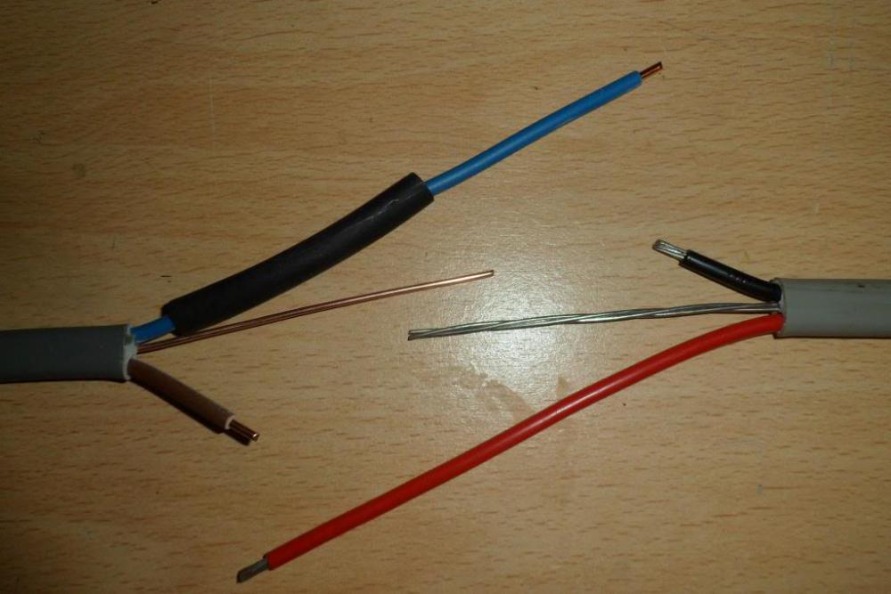

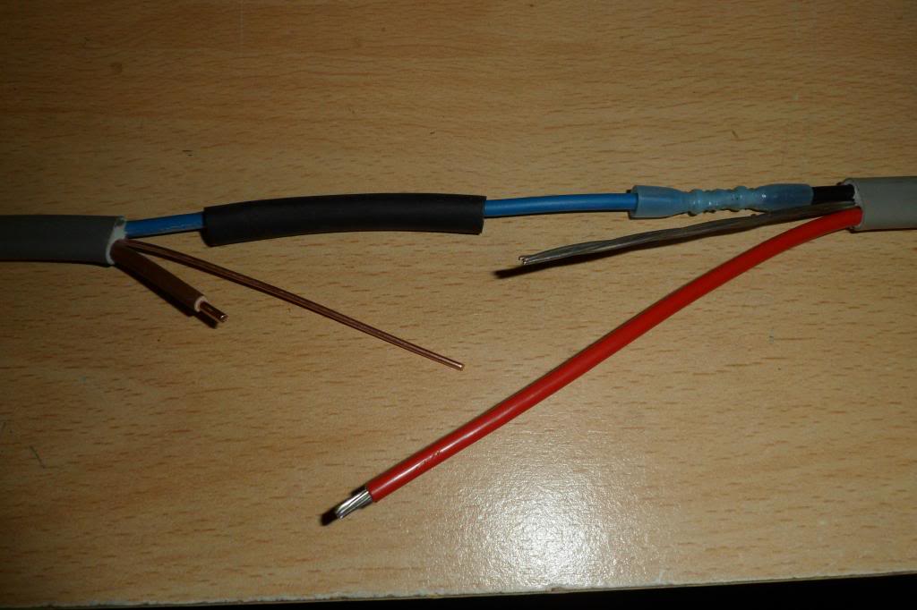

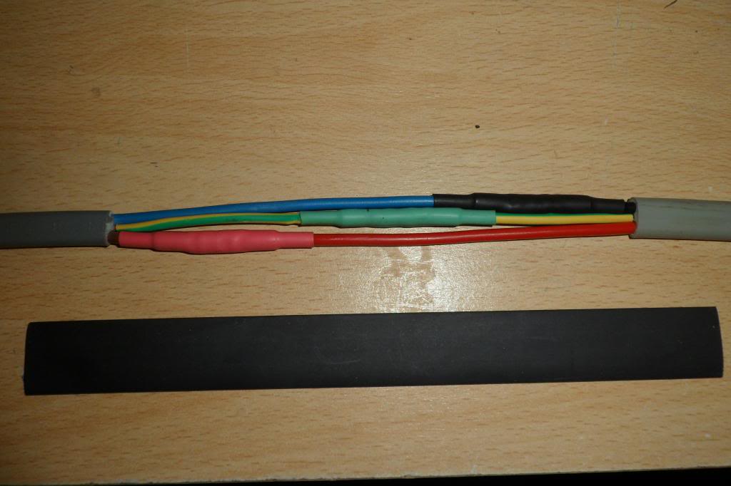

Not sure on the Dutch regs but in the UK, in line with our regs, you can crimp or solder to effect a maintenance free joint.

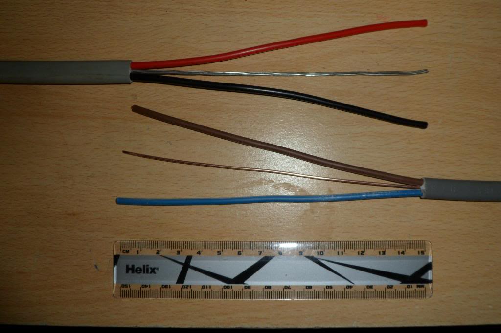

This was to demo joining two bits of T&E,  2.5mm new & old in this case,  (note the cpc  (earth) might be smaller):
Dead easy on a bench, fiddly in a wall, even getting the crimping tool in of course:

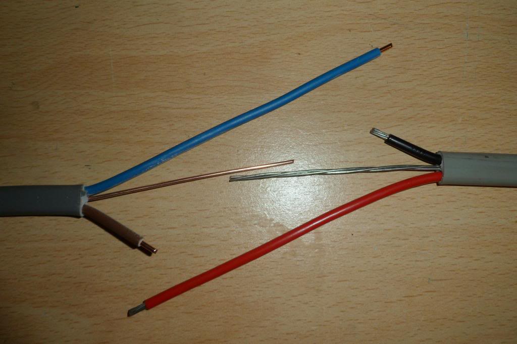

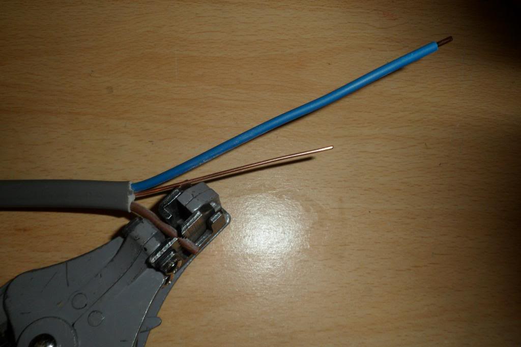

Strip the sheaths:

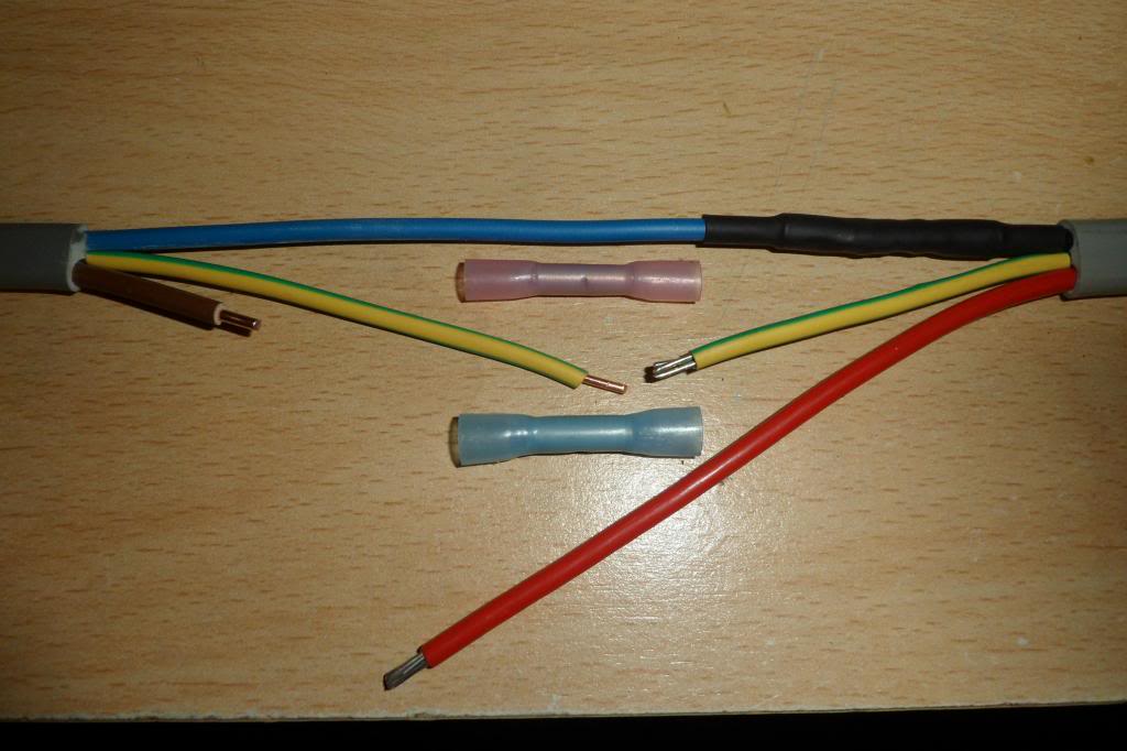

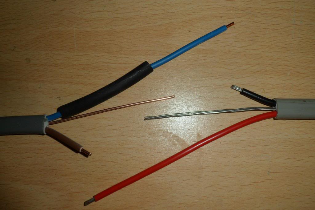

Stagger the joints so you don't get the "python after a large meal" bulge in the middle. The join needs to be long enough so you can slip the heatshrink on and slide along far enough to do the crimping and ideally shrink the crimp without affecting the tubular heat shrink:

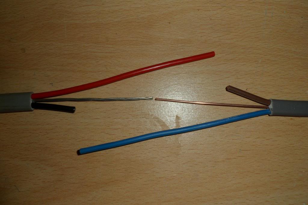

Strip the ends:

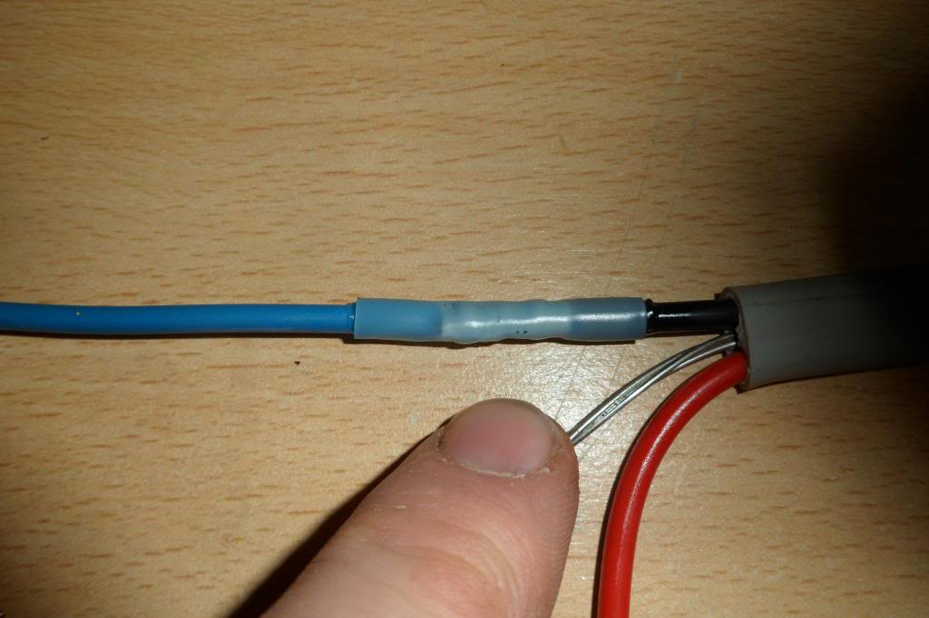

Heatshrink slipped on BEFORE you crimp!

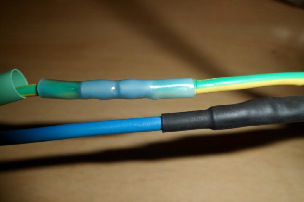

Crimp heat shrunk - has glue in that melts and sticks to the core:
Green / yellow sleeving on. SOMETIMES as said above you might want a smaller crimp for the cpc:
Cpc done:

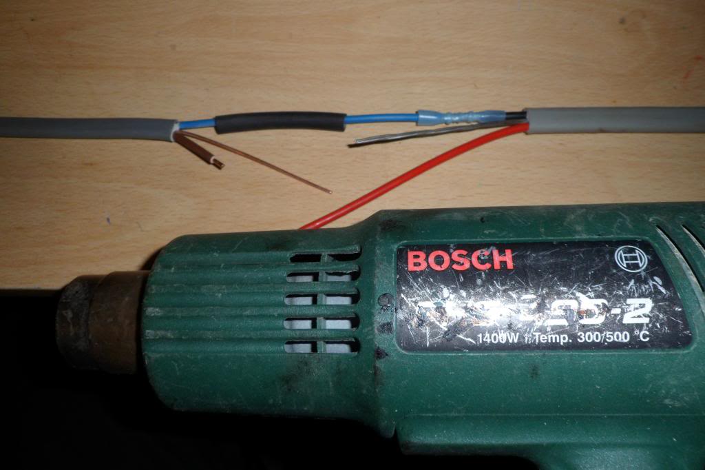

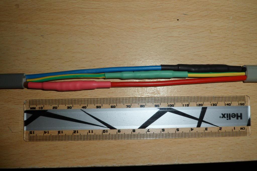

All neatly crimped, old colours for the heatshrink 'cos I've got it:

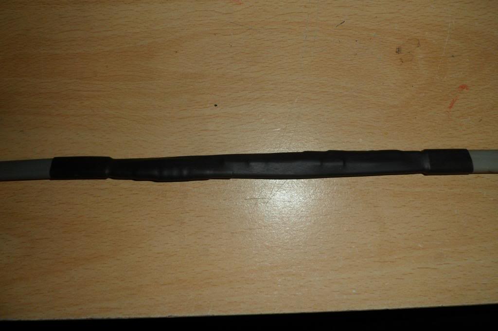

Heatshrink over the top:
Chuck it in the wall and get plastering! :)
Similarly it could be soldered but make damn sure you get no sharp wispy bits of solder that might poke through the heatshrink!
