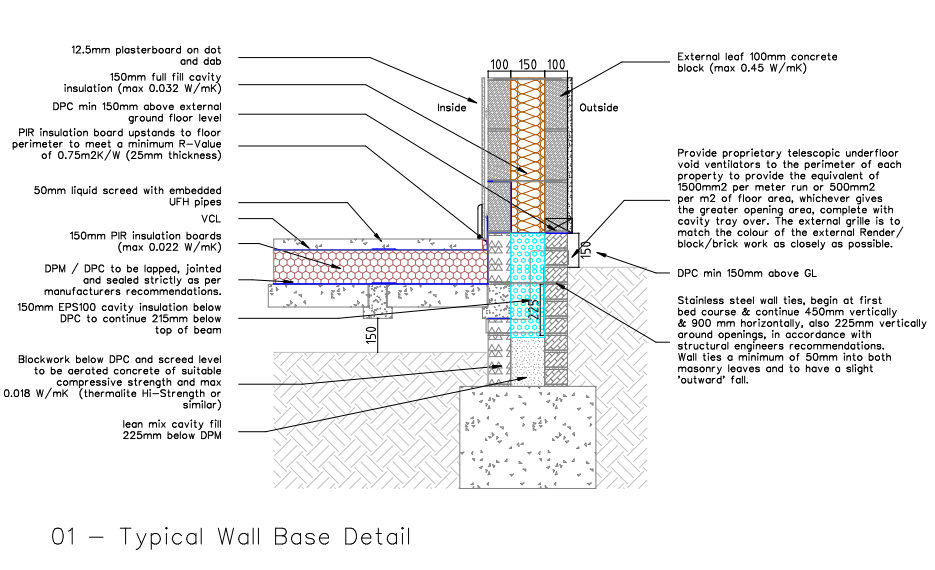

I am / did not, and I am looking to build a masonry cavity wall, though to minimise the potential cold bridging i am going to use aerated block to support the internal leaf, as below.
NOTE: I have just seen that I have a error in the thermal conductivity of the aerated block and it should be 0.18 W/mK not 0.018!
The 65mm thermablock has a thermal conductivity of 0.047W/mK, but I am proposing ~200mm of 0.18 W/mK which in my head is similar enough not to warrant the extra cost outlay.

Hi Ryan,
Yes, I used them. Though had great issues sourcing the specific width that I required here in the UK. Jewson's assured me they had them and then of course they turned out to be incorrect width, so I ended up driving to Belgium to get them myself. So make sure you can deffo get the correct size! They were easy to lay. I had aerated blocks underneath, then marmox on top with the sole plate fixed with bolts (chemically fixed into aerated blocks). Just need to be mindful of where to drill through the marmox blocks (have to miss the steel reinforced chambers).
This is what I ended up with pretty much:
