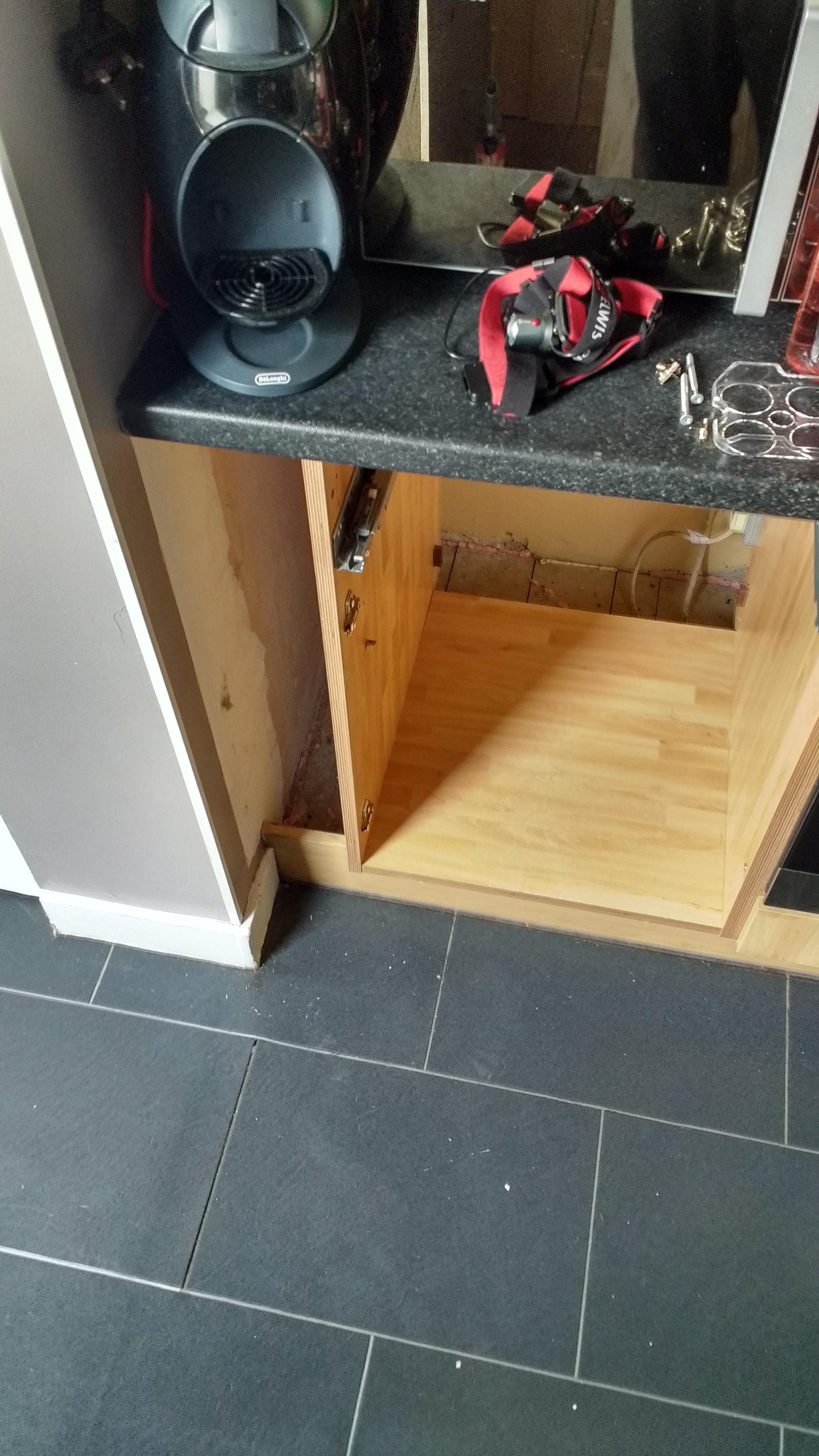

Found another hole! A mouse was seen disappearing up under that side panel where the skirting returns:
Took the side panel off, draw out, cabinet back out:

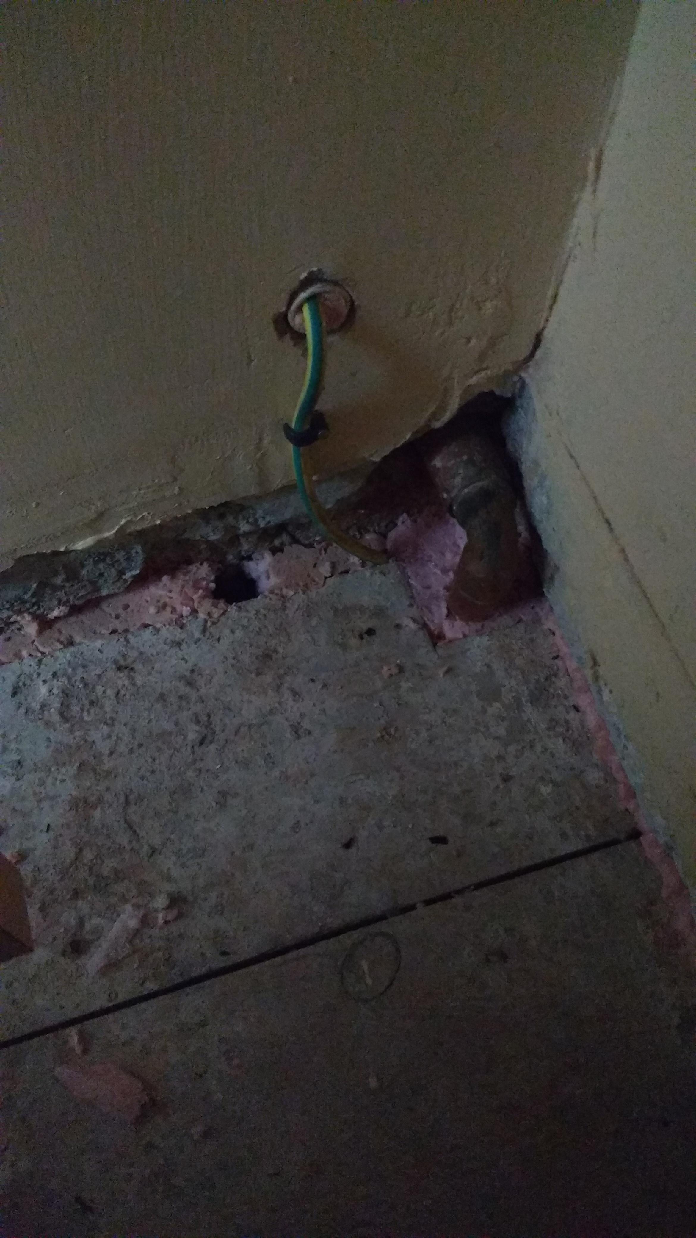

Mouse had chewed up through the foam just near that earth wire:

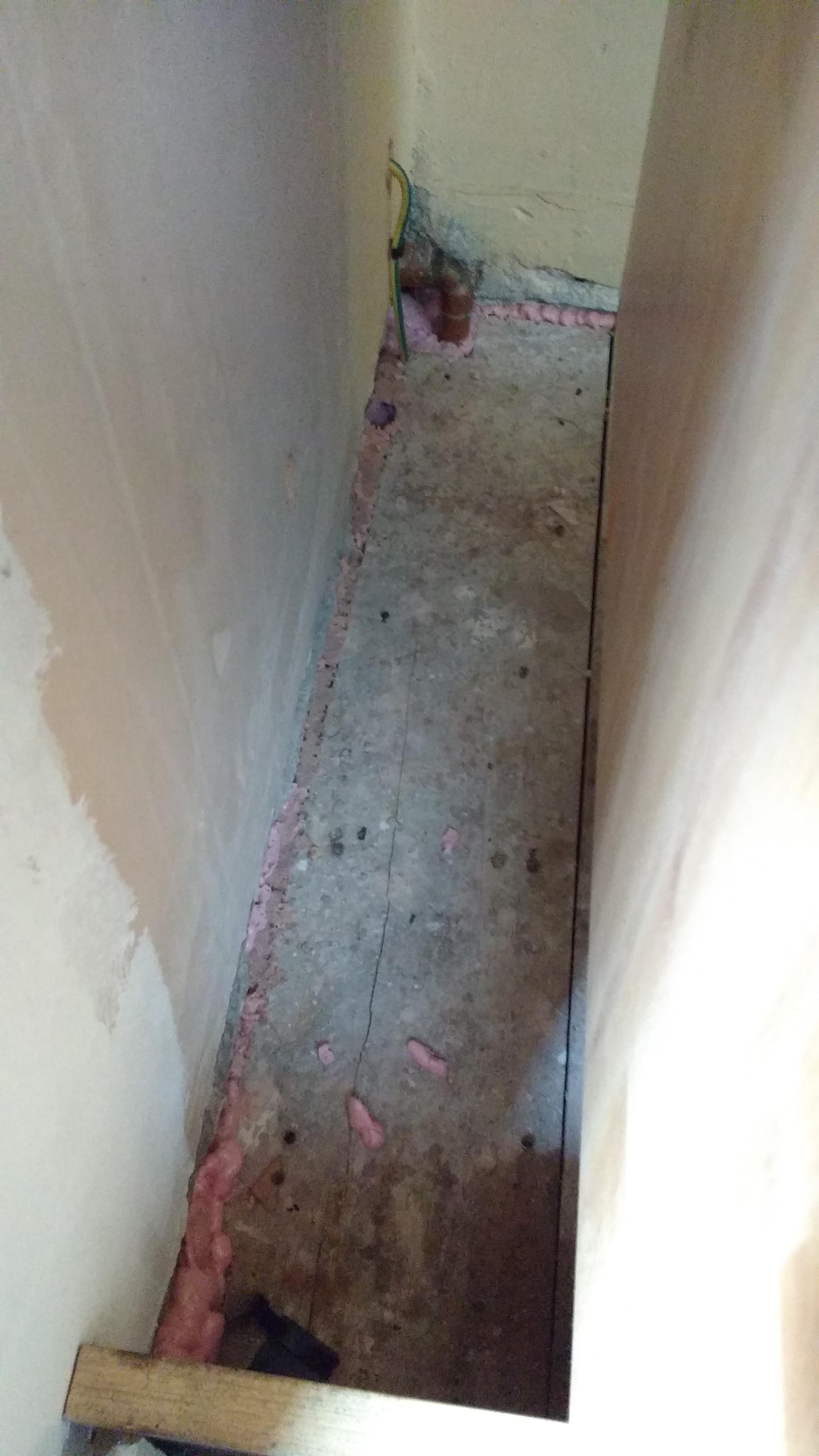

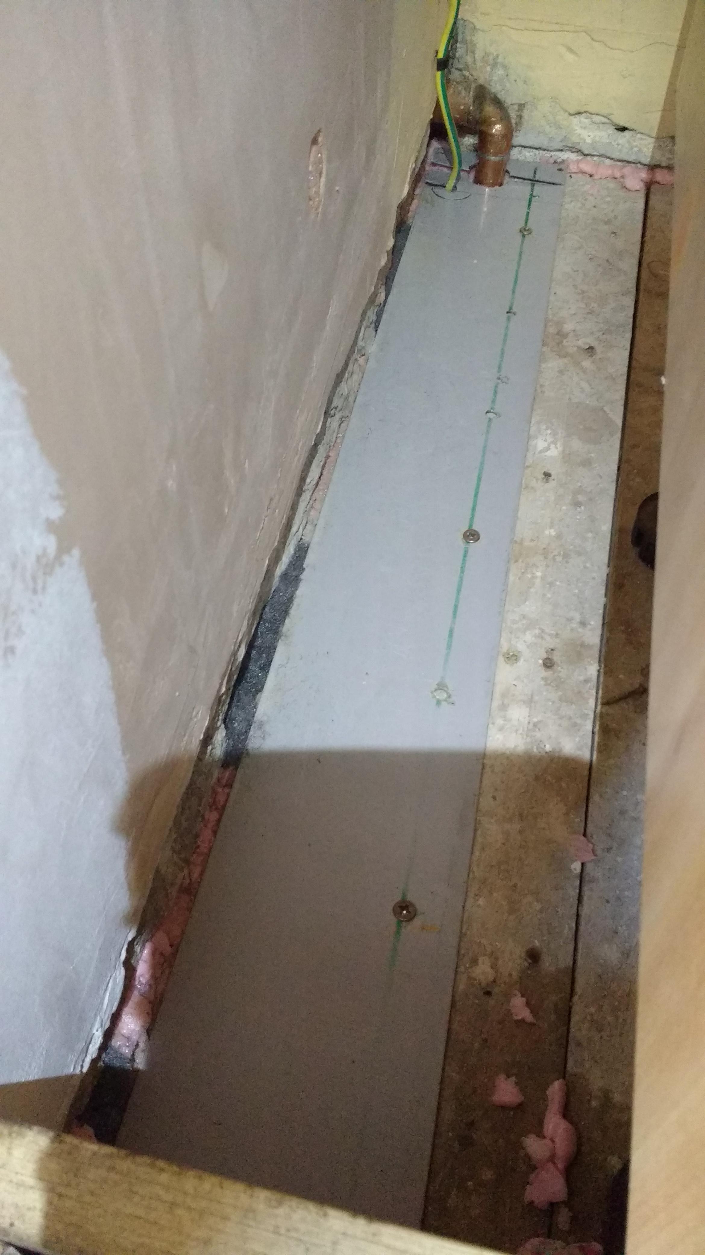

Plated over with steel sheet, packed any gaps with wire wool and foamed over:

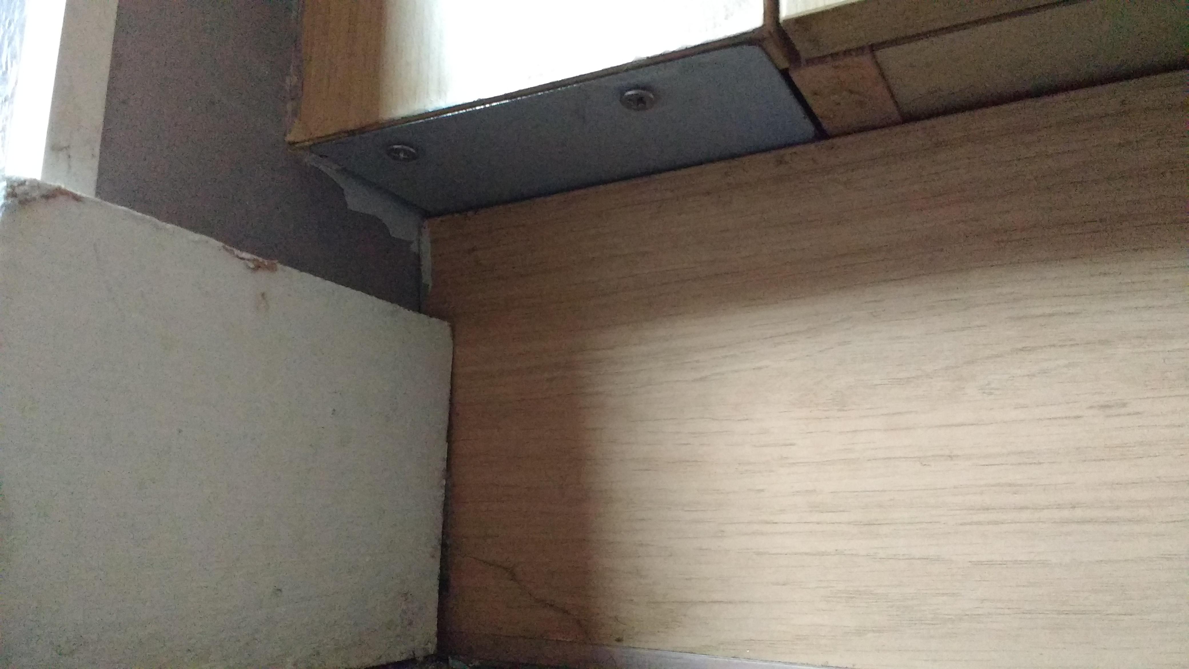

Plated too under the side panel:

It would be very awkward to get in there and redo the "plaster" that came off when they removed the skirting. I was wondering about fitting a small angle iron and if there was some cementitious product I could get in behind it that they wouldn't like chewing? Maybe a sloppy sharp sand slurry?
