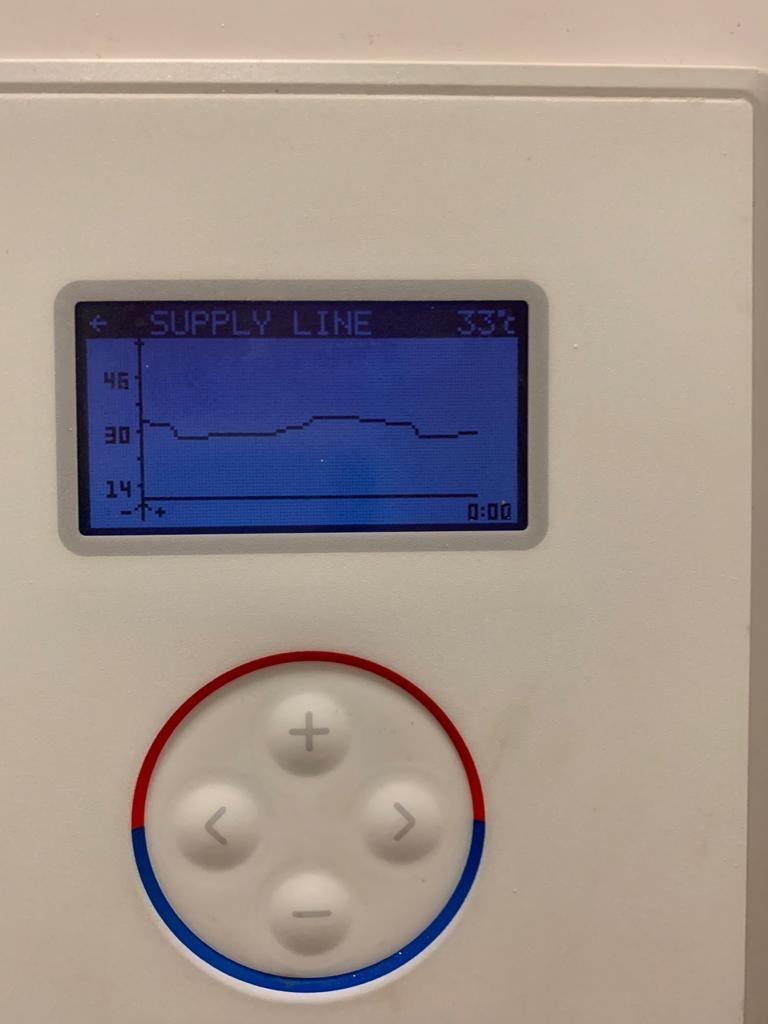

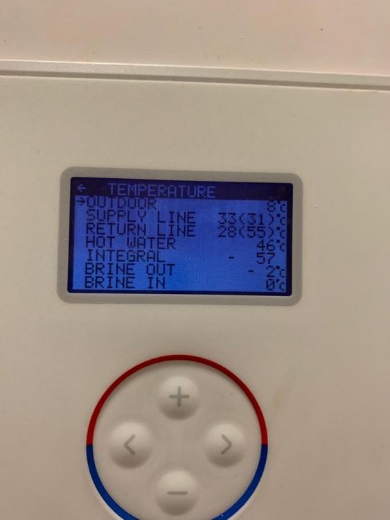

House 1 Problem: Working fine until this winter. Now high electric bill, in auto mode it is running for 2.5 hours a day on auxiliary heater. Heat pump running around 20 hours a day. No alarms.
Background info: From what I understand the Atria does not have any control on the compressor, it’s just on or off. I can put my hand on the output pipe of the compressor when it is running, it’s warm but not hot. I can’t do this on mine or the other neighbours systems.

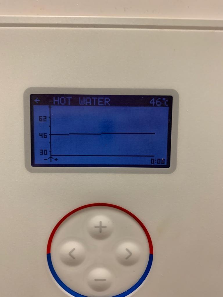

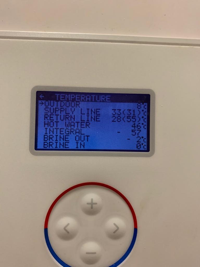

Heating supply line temp is only reaching 33 degrees in heating mode, with a return line temp of 29. For ref the outside temp was around 10 degrees when I took these values over 24 hours. Supply line temp goes up to 50 degrees in hot water mode, but strangely the return line is quite often higher by a degree or 2. The hot water itself gets to about 48 degrees before the operating switch shuts it off.
Brine temp delta is 2 degrees.
It seems to make hot water every 1.5 to 2 hours as the hot water temp drops below the trigger point (44 degrees). I’m not sure if this is normal heat loss or if the 3 way valve may not be completely closing when it switches to heating mode. I think this is a secondary issue though.

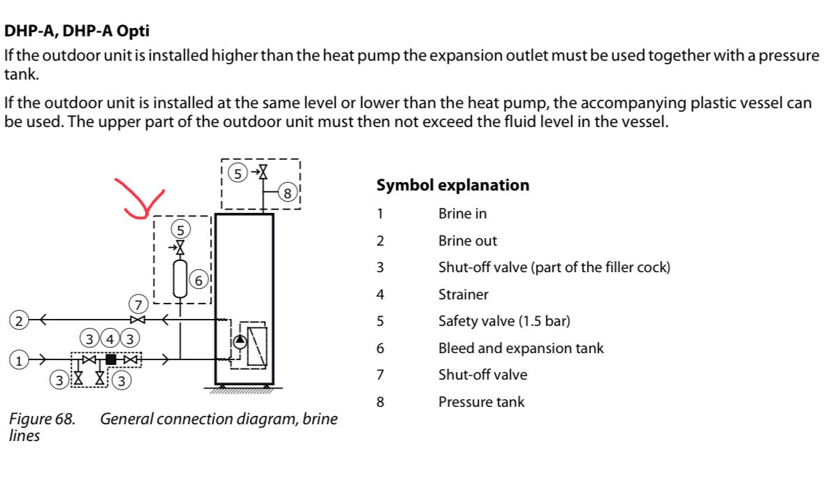

Brine Installation. Not sure if this is a red herring.

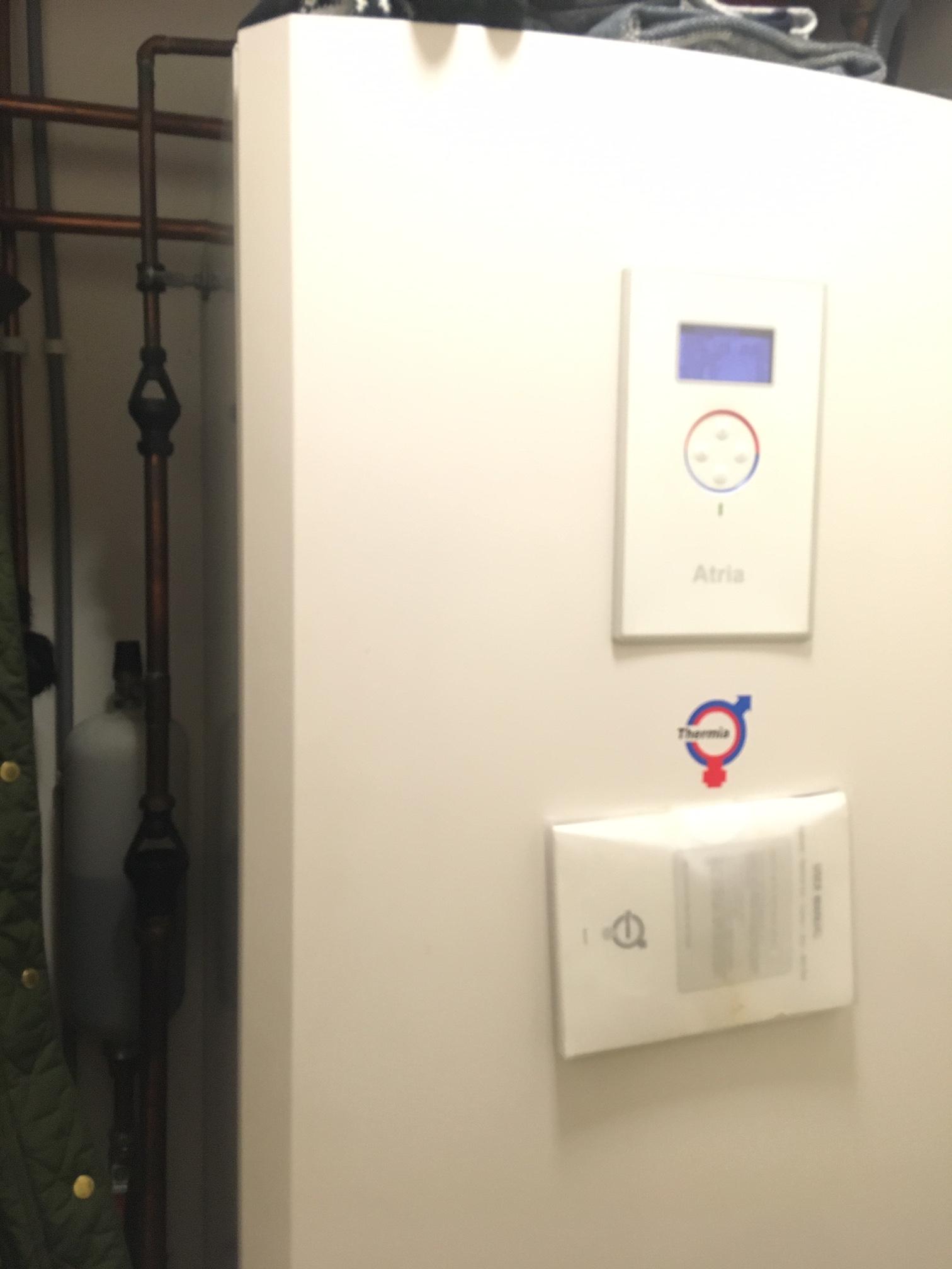

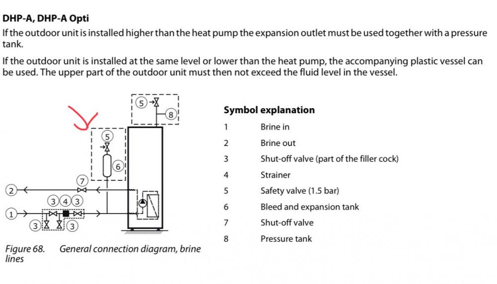

This install has a sealed but unpressurised brine circuit. It is installed exactly as per the Thermia/Danfoss manual with the fill point/see through expansion tank about 1m above ground level. However the Atria has a brine defrost jacket on the outside of the hot water cylinder. The pipe for the defrost circuit peaks inside the indoor unit at about 1.8m above ground level, with a bleed screw at the top. The manual makes no mention of this circuit in the install section. I can’t get my head around how you can fill/bleed the system properly if the fill point is not the highest point. The manual is explicit that the expansion tank must be higher than the top of the outside unit, but no mention of its position in relation to the indoor unit and defrost circuit piping.
I am sure there is some air in the brine circuit but I can’t work out how to bleed it with this set up. I got some out initially from the bleed point on the outside unit, but now neither brine or air comes out as I think the brine in the sight tube has dropped below the level of the outdoor unit.

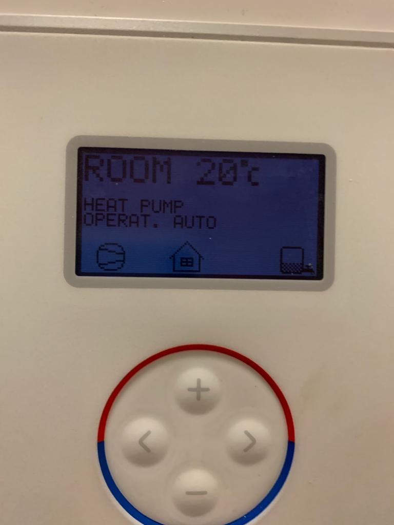

I’ve attached some pictures of the supply line temp (graph is 90 minutes of data) and hot water temp while the system is in heating mode. The supply line graph looks completely different to my system. Mine is a square wave where you can clearly see the heat pump turning on.
Also the install guide.
http://mbaudin.free.fr/dhp_h/DHP_Total_install_VMBMA702_en.pdf
System has been installed with the expansion tank option, as per my arrow. It is installed exactly as the diagram I.e. about midway up the side of the indoor unit. The pipe at the top on the indoor unit has been capped off with an automatic bleed valve about where “8” is shown.
shown.
My screenshot from the manual didn’t attach

If it was working fine, and now isn't and nothing has changed, perhaps the compressor is simply end of life? The DHW would continue to be heated (more slowly) as it's a closed system, when nothing drawing, whilst if the effective output is lower than the heating circuit loss then it will never heat up fully. That said it looks like it is reaching target, I presume the 31°C in brackets? As the energy integral is -57° minutes.
Thanks for the reply - it has reminded me that the compressor on another neighbour’s system failed about 4 years ago. However the refrigerant engineer said pressures were fine, so I had assumed that meant the compressor was likely to be ok too. However I’m not overly confident.
The 31 in brackets is the target temp as you said. This goes up as the outside temp goes down - default setting is when it is 0 outside target temp is 40. These systems don’t have inverters (at least as far as know!) so this unit produces 33 - 34 supply line regardless of target temp in brackets.
The heat pump kicks in when the integral reaches -60 degree minutes. So when outside temp is below around 5 degrees the integral just keeps getting lower as the supply temp is lower than target temp. The auxiliary heater then kicks in when the integral is -600 degree minutes.

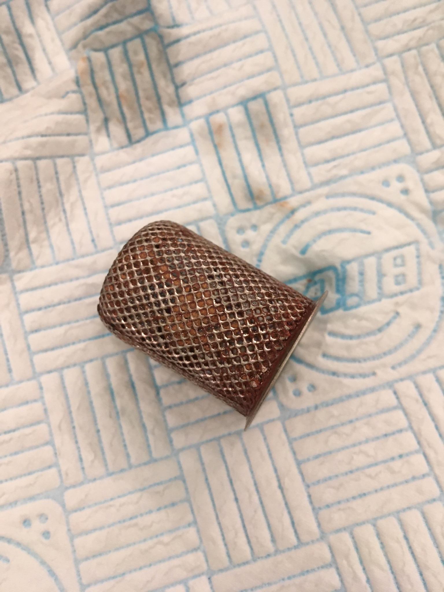

2. Checked the strainer on the heating circuit. Found half a strainer ? well I found the rim, the basket was nowhere to be seen. The fact the rim was there makes me think the basket has become detached/disintegrated and is lodged somewhere in the pipe work (surely no-one would put just the rim back in?!). So this could be be blocking the flow. Or maybe there is no strainer, so a risk all the crud is in the heat exchanger.
Is it remotely possible that the strainer has corroded away?
Attached is a picture of the strainer in my system, so this is what should have been there. The basket is crimped to the rim.
There were no remnants of any of the basket at all, which is why I though perhaps it had become detached. If it had corroded, would you expect to see some of the basket still attached by the rim?
My neighbour would not have been able to check this themselves. I recon they had someone out to service it around 3 years ago, so it should have been checked then.
