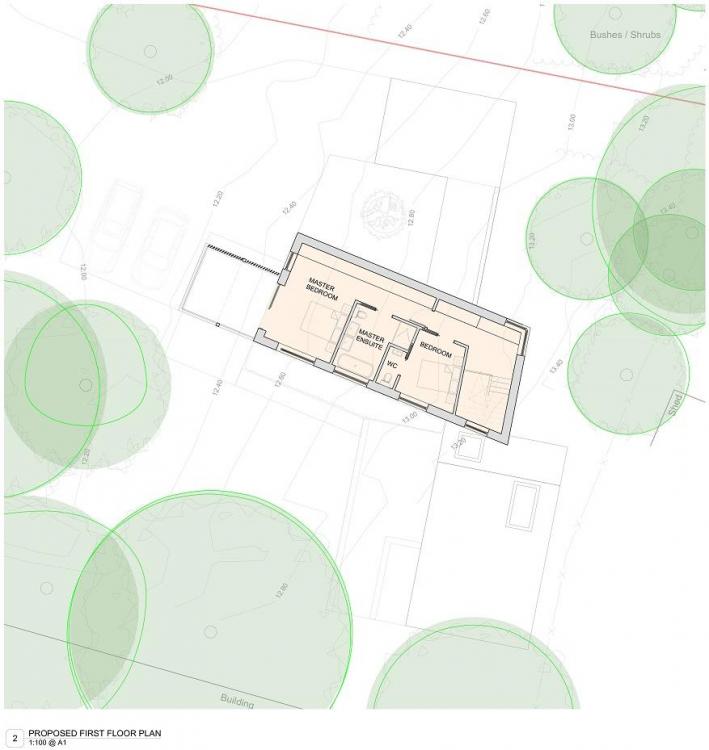

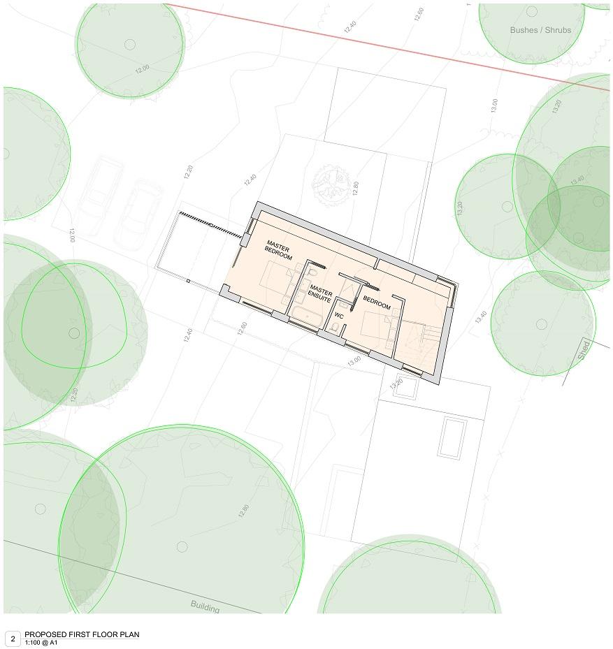

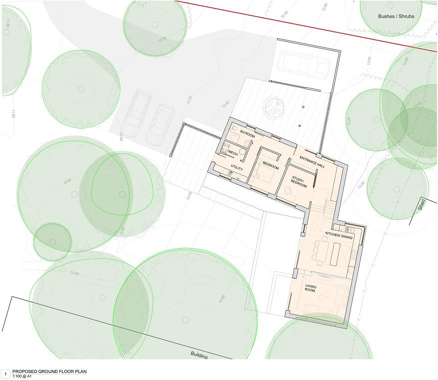

So, here is the latest incarnation of our design. For clarity, this is correctly orientated for true North.
***I can't get the uploader to work, I'll add these shortly***
The Ground Floor has been jiggled around to give us the ability to enter the house from the garden via the covered seating area to the West and into the Utility Room, which we're happier with.
Of course neither downstairs Bedroom is technically ensuite, but are in close proximity to the Shower Room.
Our Architect had really wanted to position the front door to give a long view through the Kitchen, but the RPA's of the trees just didn't allow it. It was only once we saw the plan that included the RPA's that we really realised, the plans you see here don't do it justice. A couple of non important trees have disappeared from this latest revision as they were just confusing things.
We have altered the division between the Living Room and Kitchen. We are undecided whether we will keep with an Island or just fit a midi height cabinet run into a peninsula format between the 2 rooms, to a height of around 1.7m.
Upstairs hasn't changed much, the Bedroom sizing has been changed slightly to make it a Double with ensuite WC.
We've increased the size of the void over the hall, this isn't shown on this plan. We're very pleased with the overall look of the design, I know it's not perfect from an energy efficiency standpoint, but hoping we can spec the fabric high to give us the best chance.
My ongoing concern is with the size of the Living Room and Kitchen/Dining Room. The total room size this area is 9.3x5.3m. We currently have the living room at 4.0x5.3m and the remaining 5.0x5.3 for the Kitchen/Dining. We cannot increase this any further within the parameter of this design, but I am a little nervous that it might be a little small. Should I be?
