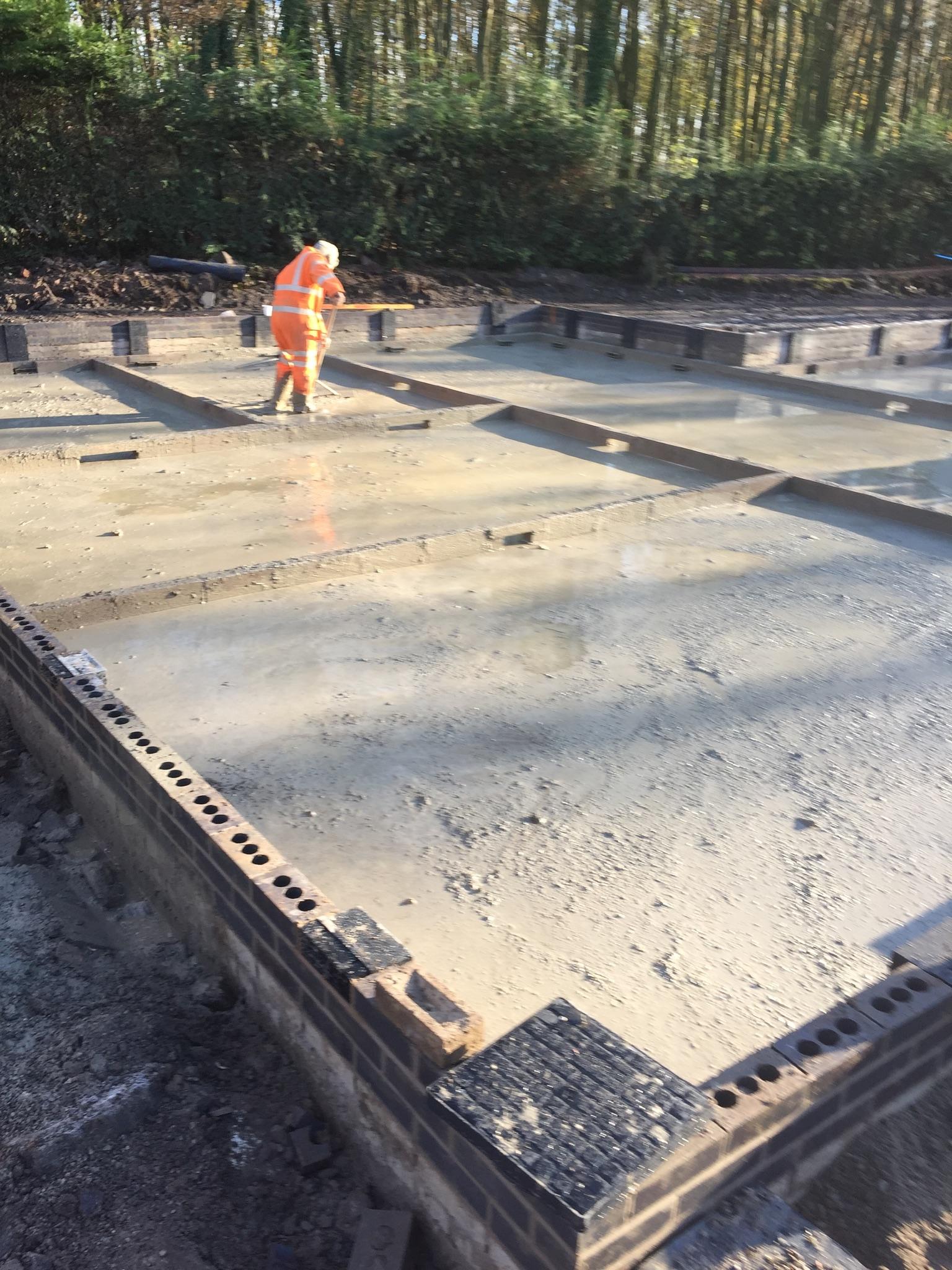

nod Posted January 29, 2021 Posted January 29, 2021 Yes A good SE will do this Ours insisted on 4 cube under the Block and beam Running off to a central drain and a flood valve All just in case I thought way over the top at the time He explained that should the plot flood We could end up with the constants of our TP under the house Our SE took it upon himself to include all this in his foundation design So no chance of me or if I’d employed a Ground-worker varying from his design Pictured is me wrestling with 4 cube of concrete in torrential rain Worst day of the build As I thought it was a pointless task
