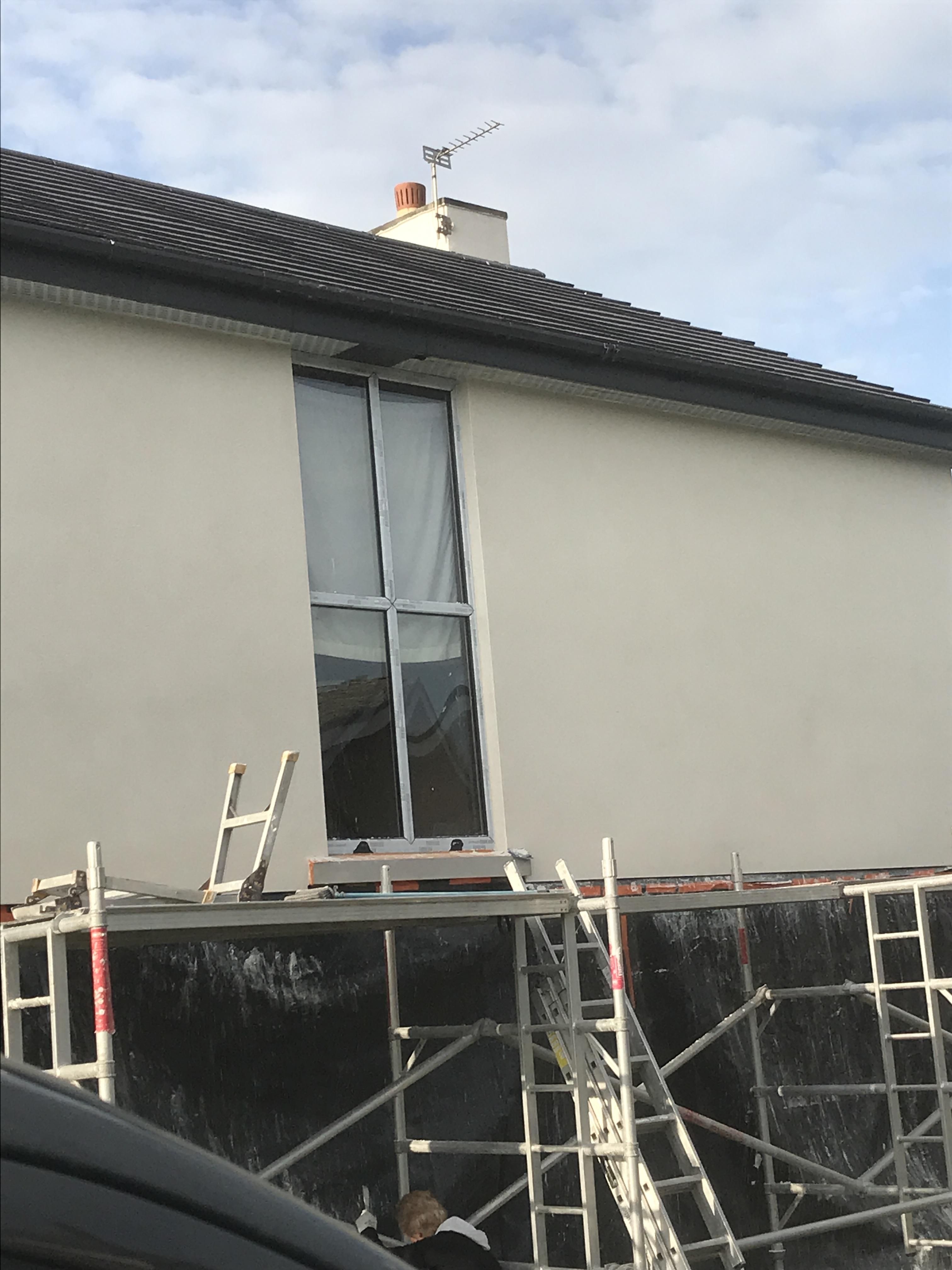

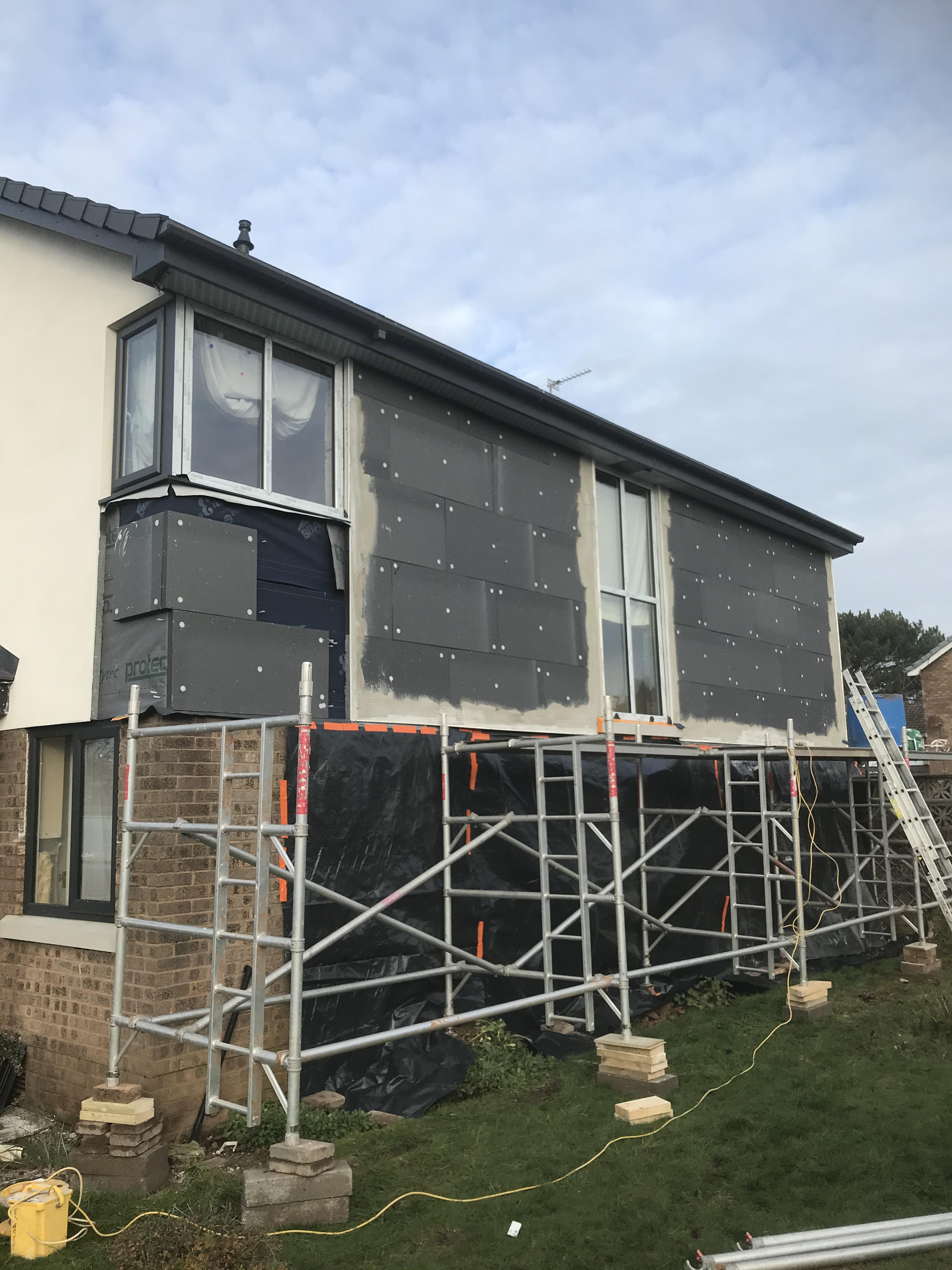

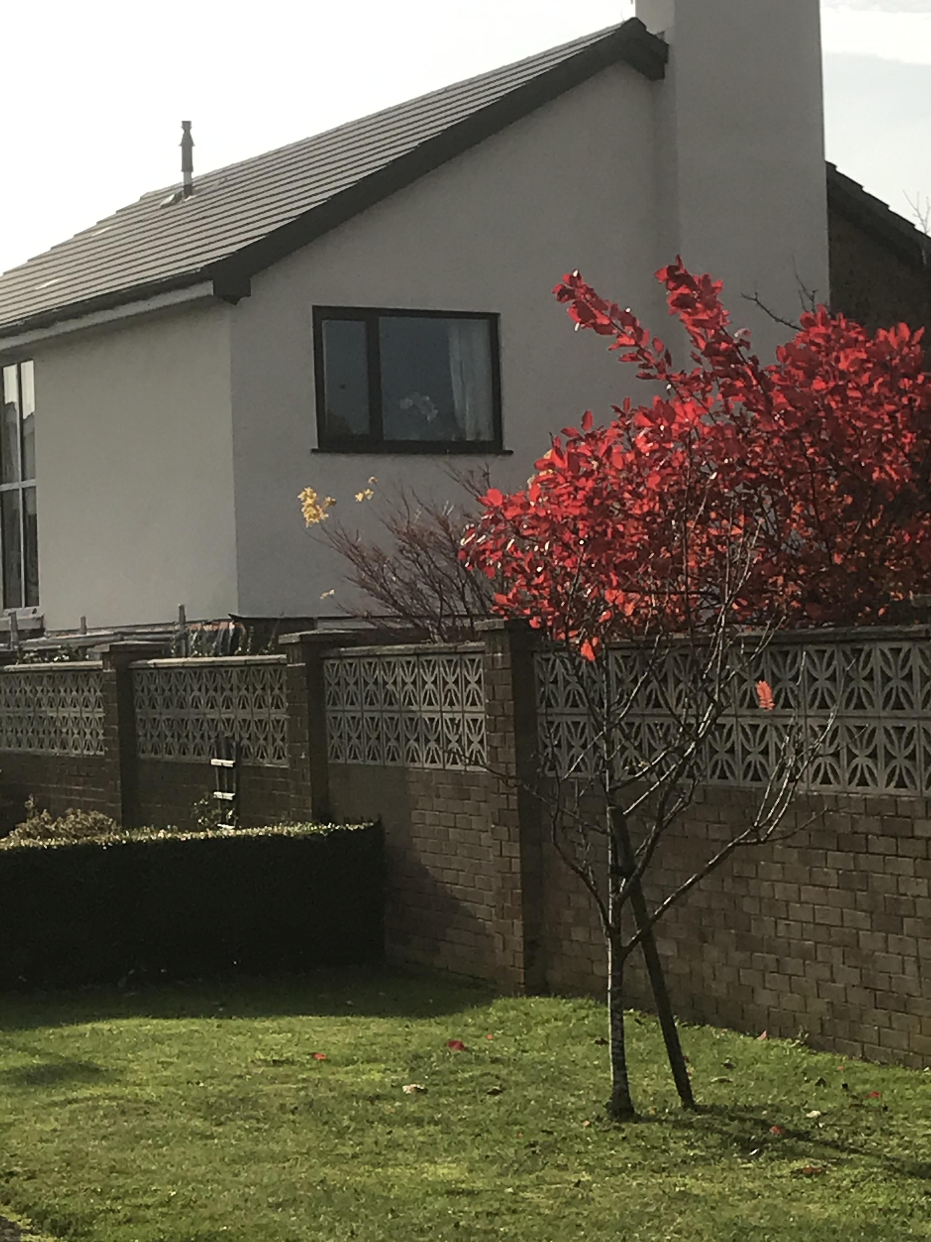

I recently rendered a house for a friend who had a similar dilemma

If you have it in the budget You could do both My mate was on a tight budget and hasn’t got round to paying me for the render He did say he’d take me for a pint
Still waiting ?
