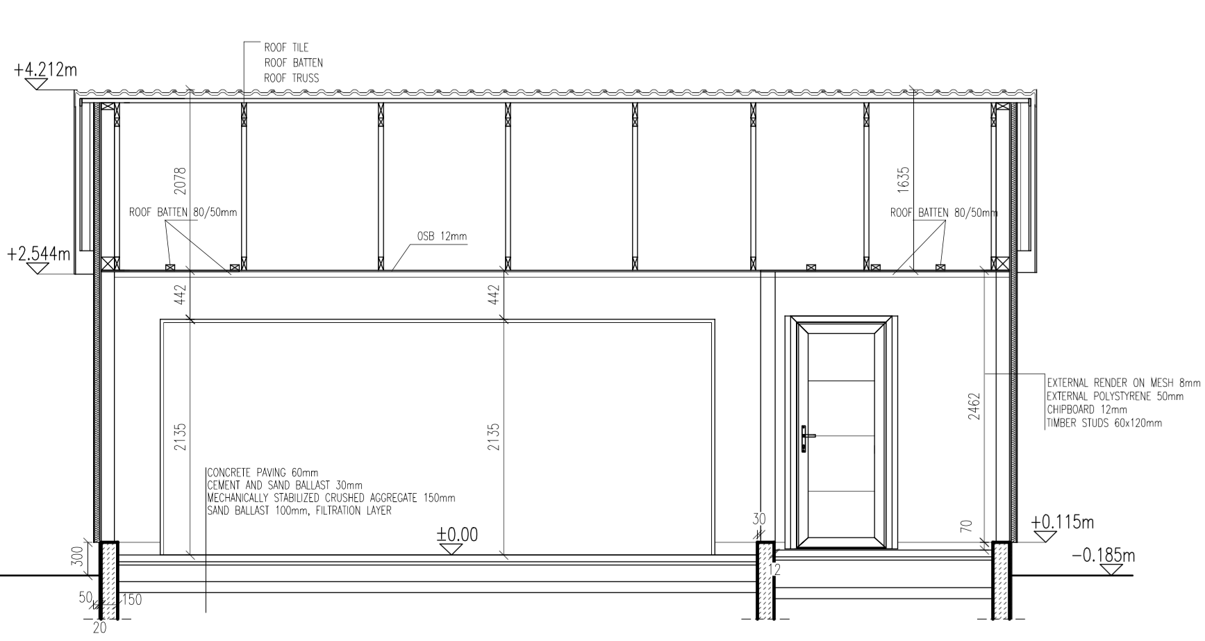

hmpmarketing Posted January 30, 2017 Share Posted January 30, 2017 (edited) Hello all, Originally I had in mind ordering a "turnkey" garage solution (6x8m garage) from the company I am using for my build, their garages are all timber frame and panels, the exterior finished in render on mesh, concrete roof tiles, etc.... Due to timelines I wont be able to get the order placed together with the house (delivery and erecting savings) as the frame is delivered from Europe. I am now trying to find an alternative company that can delivery the whole frame per their specs. Could anyone point me out to any you have had experience with (preferable in the UK)? Thank you so much! Edited January 30, 2017 by hmpmarketing Link to comment Share on other sites More sharing options...
