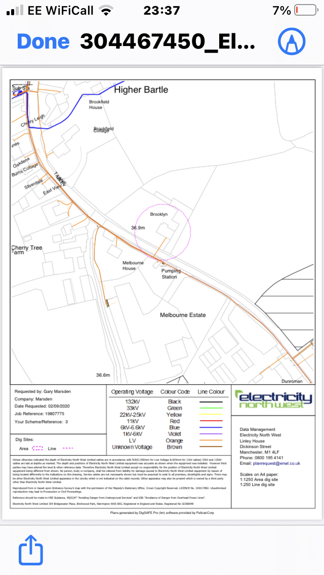

If you register with plantequest
and Cadent They will send you detailed plans of Gas and electricity
similar to below
similar to below
Great thank you! I have the gas and elec maps already
